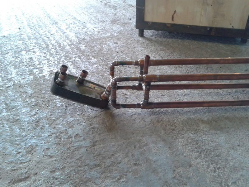

Well this morning I made a little more progress and the bottom end of the processor is finally looking pretty much finished.
I've been busy cutting and drilling the heat exchanger that I got from Dick (Thank you very much) and have soldered in some 15mm to 22mm reducers.
And attached it to the top end of the condenser.
More to come

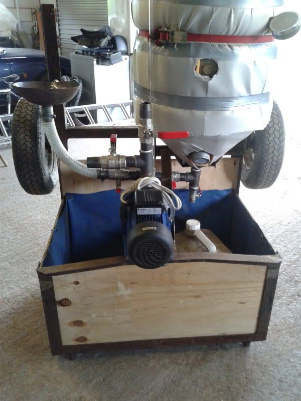

« Reply #168 on: June 08, 2014, 04:54:14 PM »
You have your pump and feed in funnel the wrong way round, your flow will be slowed considerably in that configuration.
« Reply #169 on: June 08, 2014, 05:01:39 PM »
Indeed it will.  I thought about that one long and hard, and in the end went with the thinking that the pump is man enough to manage.  It all fits a bit better this way.
I've now tried it and the pump with a full tank and it is still pumping into the tank so fast that air is being pulled through to the bottom of the cone and back through the pump.  Its mental.  I also timed it.  It empties the whole tank (well about 160l) is 23 seconds.
I might put a T piece in to half the speed into the tank.
« Reply #170 on: June 08, 2014, 06:35:33 PM »
Ah, a feed in funnel, now that is a good idea. I can feel that modification coming on.
Nice work.
« Reply #171 on: June 08, 2014, 07:36:58 PM »
Was that with oil or water?
« Reply #172 on: June 08, 2014, 07:39:12 PM »
Nice work.
Great for putting glyc in, I've had one for quite some time now. Not exactly the same but it does the same job.
« Reply #173 on: June 08, 2014, 07:44:36 PM »
Nice work.
Works well but make it deeper if you have a 'normal' pump. I have used a 1 gallon parafin tank with the bottom cut off. Works really well with a tam. It also just fits a flower sieve for BCBs  as Jim says ideal for glyc and adding a cubie for getting the level just right.

« Reply #174 on: June 08, 2014, 08:01:07 PM »
Thanks for the advice. Where it would be a marvellous benefit to me is getting some oil in to start off with, instead of having to tip it in through the top. Once I've got 20 litres in, I can suck the rest up before the pump.
« Reply #175 on: June 08, 2014, 08:31:42 PM »
That was with water, I guess the oil might slow the pump down a bit, but less so when hot.
