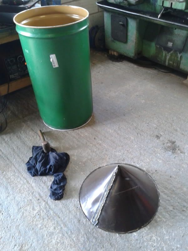

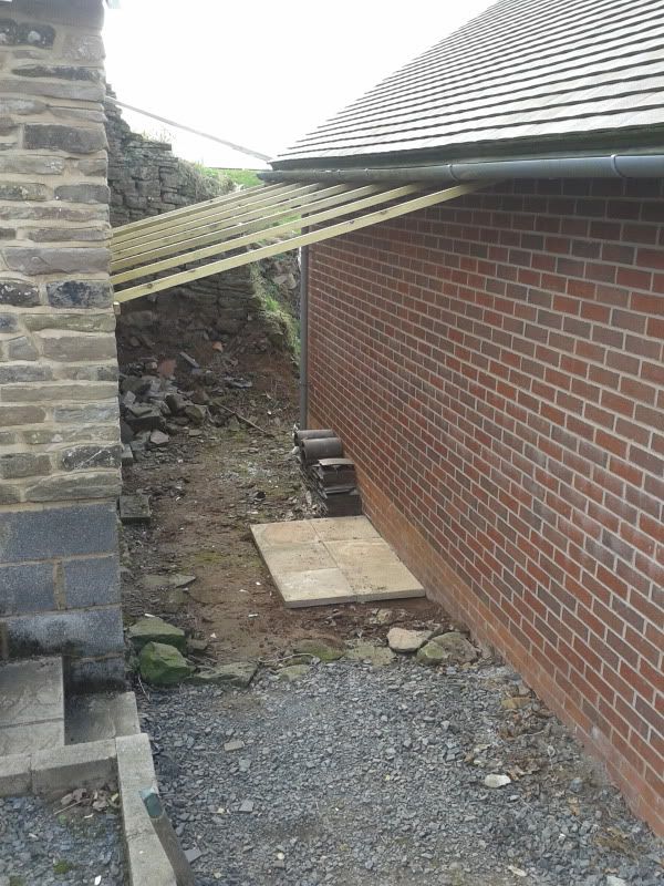

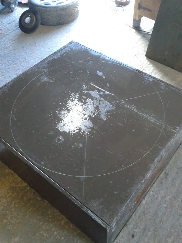

I thought it was about time I joined up.  I've found your Wiki page very informative and have started buying bits to put together a bio rig.  I've started putting up a lean-to outside, I've got a pump on the way and have picked up a couple of barrels and made a cone.  That's about it for now.  Hopefully I'll get it attached this week then start the long process of stopping my bird-poo welds from leaking :)

Weld a steel nipple into the point of the cone to attach fittings. I should have a spare if you need one.

Dick, The welding went better than I thought it would (but I haven't tested it yet :) )   The nipple is next on the list.  Thanks for the offer, I've got to look into what size to go with yet.  The pump is rather a beasty at 300l/min and has 1.25" and 1.5" fittings so I'm hoping 1" will do.  I think I'll buy a pipe threading tool and do a whole load at the same time.  How big is your spare?

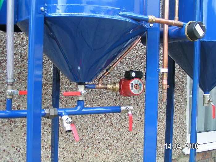

Hello and welcome
 I see you've  pulled an edge out on the cone, would I be correct in assuming you intend to weld it to the bottom bead?
There's a problem with that idea, the bead has a silicon type seal spun into it that burns away during welding leaving a nice 360 deg leak above the bead.
Cut the bead off and pull the cone edge parallel with the drum body and weld the lap joint.
You might be able to see the lap joint in this picture.
The new Oxford blue does no favours when it comes to photographs!
'ave a nuva look moaning molly.
