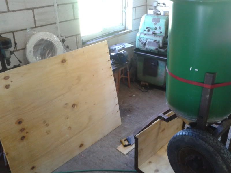

I walked to town, and walked back with it on my head :)  8ft x 4ft   :)
About half way a van driver stopped and took pity.  Then I did this:  (now I'm marking :( or rather I'm avoiding marking)

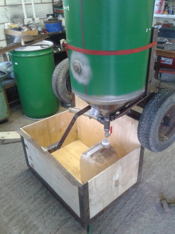

I got a bit more done on the processor last night.  I got all the wood cut to size, a nice tight fit minimising the number of bolts needed to hold it all in.
I'm not sure if I mentioned the pump still leaked after fitting another new seal.  But I then discovered the seal housing was cracked.  Looks like thermal fatigue.  With a new part costing £70 ish delivered I've asked a friend at work to TIG it up and he's done a great job.
I'll put it back together soon and test it again.  Fingers crossed I can get the lining for the bunding, the pump stops leaking and I can get closer to finishing.
More to come

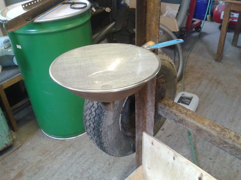

Got some more done this afternoon.  It might not look much but I was fairly pleased with progress.  I just got on with it, instead of staring at it for ages which is my usual trick :)

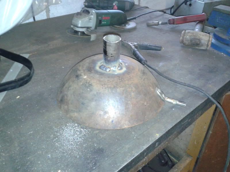

I hammered an old Wok to make the flat bottom more round, then cut a hole in it and welded on a bit of tube.  And there you have it, somewhere to pour the oil in :)

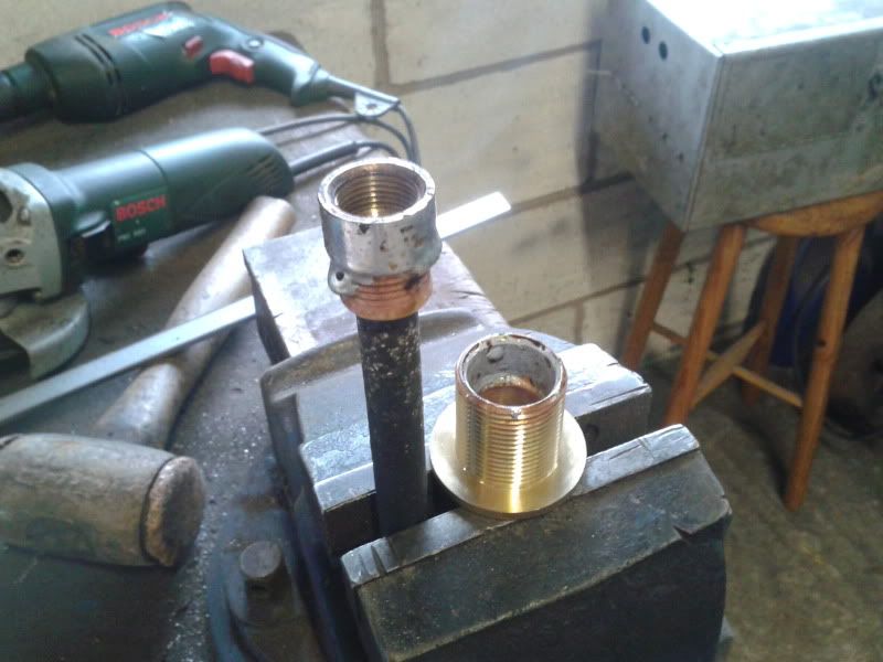

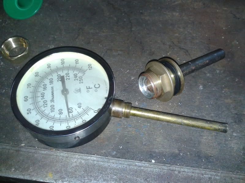

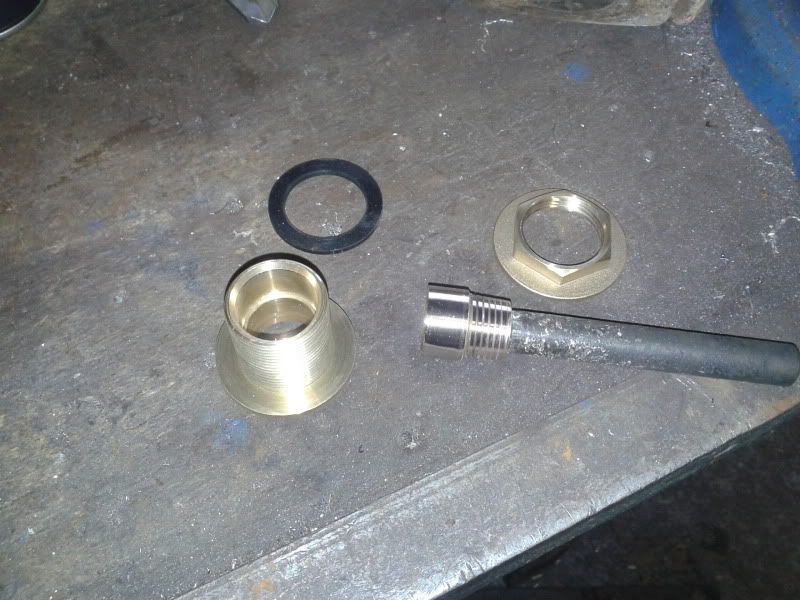

I also did something weird with the thermometer you gave me Dick.  I hope you don't mind.  I bought a tank fitting and soldered the thermometer housing into it.  This required turning down the thread first.  Then it soldered together nicely :)
On that note, I thought I'd hold off on drilling the tank until I'd confirmed that it can go anywhere right??? as long as its not too near the heater and its well below the oil level.
I've been looking at the solid state relays too.  I seem to be able to get some that use have a 12v DC input and some have have higher voltage, and some are AC up to mains voltage.  What voltage is the switch you gave me meant to operate at, and is it AC or DC or does it not matter?

Make sure you change that tank connector seal for one made of viton.

Temp sensor mod looks good. As you will be mixing the oil position does not matter but, as you say, keep it away from the heater. About half way up the oil does it for me.
That looks like a spatter guard on top of the wok? I think you need something that sits in the wok as you will find it will block and fill up with oil, on the spatter guard it will just run off the sides. ( does SWMBO know you have the wok?)

Tank seal can be hdpe if you haven't got any Viton, bio attacks rubber so as Nigel implies it will leak.

I asked what material the tank connector seal was made from and they didn't know.  I thought I might have to change it.
It is a spatter guard Dick, is it too fine then?

Regarding the tank connector seal, you mentioned you cut HDPE out of cartons?  Would an old engine oil carton be thick enough material?

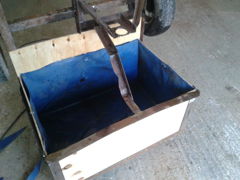

I've also got round to picking up a lorry curtain for making the processor bunding an covering the lean-to.  Its massive!!!!
There are a few holes here and there, but I know these can be repaired.  It took a good two hours of practice to perfect the art of repairing the stuff though :(
Then I lined the trailer with it and forgot to take a photo.

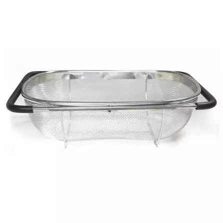

Yes too fine for a first filter. You will be processing thick oil at times and you want to be able to get it in the processor. The first filter is just to get bits out that would damage the pump. I use various kitchen strainers. The other problem you would encounter with it is that as you pour the oil on it it will clog and the oil will run off the sides, testing the bund! You need something with sides, some use a wire waste paper basket.
This is the type I find best.

Regarding the seals I use bits cut from an IBC but a double thickness of oil container may be ok with a little gasket seal.

I got the lining finished:

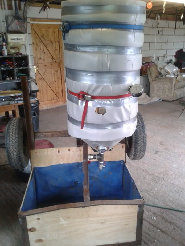

And the the tank insulated and mounted:
I feel like I made very little progress this morning, but it should look a lot more complete with another hours work I think, certainly the bottom end anyway.

Like the temp gauge, real quailty there!

PVC isn't bio proof, it tends to sweat.   For that duty though, it should hold up OK.

Thanks Dick, it's a lovely gauge, given to me by a local bio expert :)

The lorry side is pretty thick, I guess it would take a little while to get through it.
