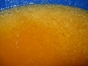

In winter (or in a convenient freezer) some waxing in biodiesel may be observed as either suspended flakes or a white/yellow creamy layer at the bottom of containers.
Solids found at the bottom of a batch of biodiesel in the winter
