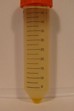

5/45 test with unconverted vegetable oil present (Source: BassAddict)

  • Vegetable oil (triglycerides) is insoluble
When mixed, any remaining vegetable oil, which is denser than methanol, will drop to the bottom.

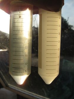

Clear pass
5/45 "clear pass" and 5/45 pass.
Perfectly converted fuel will give a "clear pass" where the liquid is transparent, regardless of the methanol temperature.
Cloudy liquid with no drop out at 20°C is considered a pass, but may contain mono and diglycerides. Drop out may be seen if the liquid cools.
The only caveat with using methanol cooler than 20°C is that (depending on feedstock) even completely converted biodiesel may wax and also give the appearance of drop-out as a result. For corn and rapeseed oils this is quite light in colour and distinguishable from unprocessed oil, however solidifying palm oil is quite dark and the distinction may not be so obvious.
