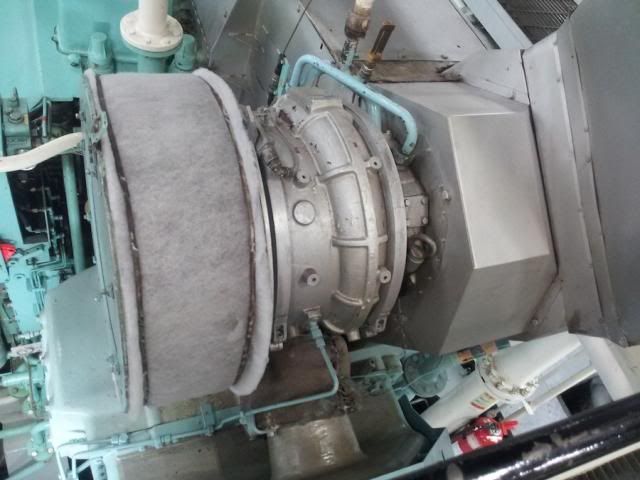

This big enough?  :o
Seriously though, we do have a spare turbo from a 350kW CAT genset. It's about 250mm diameter. It can't be returned and it's just sat gathering dust. If you're interested I can see if I can convince the powers that be to part with it.

« Reply #5 on: March 25, 2014, 09:26:02 AM »
Do it, do it, do it, do it!  :)
You'll get some proper propulsion with that!
