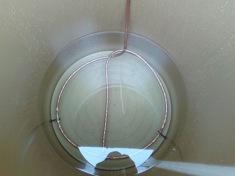

« Reply #230 on: July 15, 2014, 04:11:49 PM »
Thanks Dick, I've done the punching already though.
Here is the result.  Very pleased with this now:
All done.  The "to do" list is nearly a thing of the past.  I've got to change the loading wok (although it is usable at the mo), collect the storage tanks (I've located two 205l barrels for £10), and drill the holes for the taps in the settling tank.
Aside from drilling the holes, I'm ready to process :)  :)
Quite excited  :)  :)  :)  :)
Thanks again for all your help in getting this far.

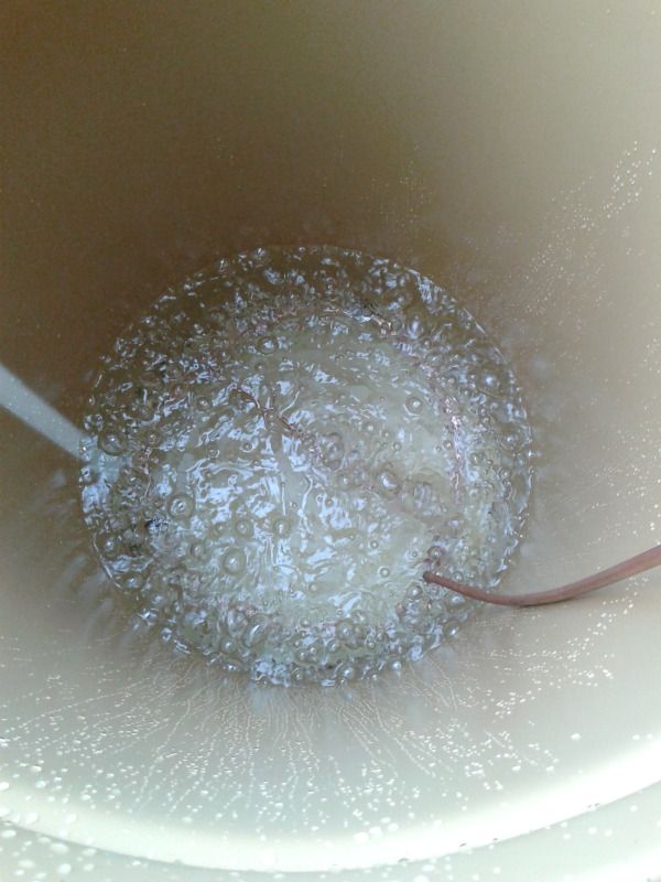

« Reply #231 on: July 15, 2014, 04:51:46 PM »
Oh no you ain't,  didn't you notice my holes are facing down, done to prevent crap blocking'm.
« Reply #232 on: July 15, 2014, 06:41:27 PM »
I did notice but thought it would be fine this way if I put it in bubbling and take it out bubbling there should be no opportunity for crap to get in.  Hopefully!  :)
« Reply #233 on: July 15, 2014, 06:59:42 PM »
You'll have enough crap on the floor without adding to it with a dripping bubble ring, I've had years of experience at making a mess so I know all about it.
