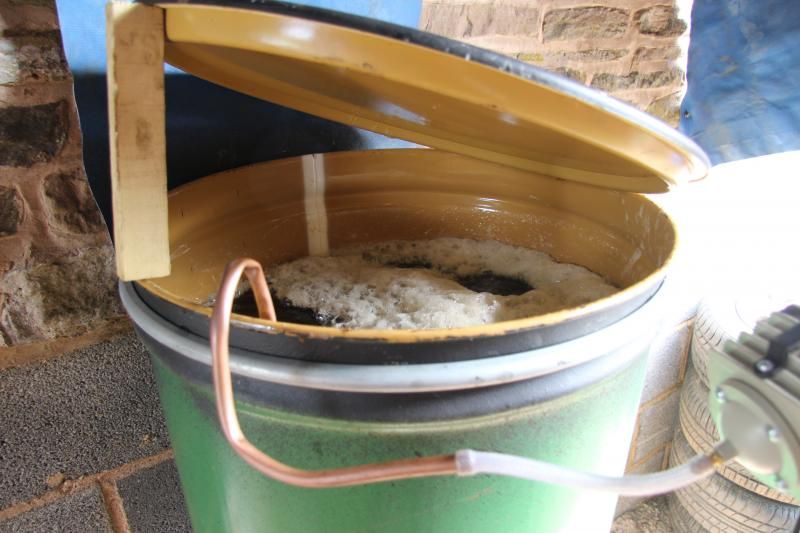

This is my second batch.  The method I used was exactly the same as for my first batch (for the first two stages) with the only difference being after that when I added the extra methanol.  I altered one variable so it wasn't guess work.
I'll take your advise on board though thanks.  I thought it was very wet oil when that result came out.
In my first batch I followed the same procedure, i.e. heating, leaving overnight, draining 5L, no distilling the water out and there was no soap drop out at all.  I guess that was a lucky one then!!
Dick,
I'll not see it till Wednesday night now, but it'll be the first thing I do when I get back to the folks house :)
When I pulled the bubbler out I could feel the little feet I put on the bubbler ring were semi stuck in the gloop at the bottom :)  I guess it'll need cleaning out before too long :(
I will defo give drying the oil a go next time.
Regarding the reacting time. I took samples at intervals when I did my first batch and found the reaction was all done after 8mins, so I was being generous and rounding up to half an hour for the second stage.

I've failed to dry the oil properly on thursday night.  Both relays over-heated and I'd only got to 80 degrees C, there was some water condensing out but it was by no means finished.  As predicted there is plenty of soap in it.
I'll not be doing it next time.  I fully appreciate the need to get it dry now.
I put 175L in the processor, condensed for a while at 80C then had to go :(  Saturday morning I drained off 15L so started the process with 160L
Put 18L of meth and 880g of NaOH this go me to 60% bio (340% soap :) )
I then put 7L of methanol and 340g NaOH, this got it to 95%
Last lot was 3L methanol with 20g NaOH, B100 :)
I then spent a long time condensing plenty of meth out.
It came out of the processor a little cloudy, and was followed by plenty of froth.
I also reacted for well over half and hour each time.
On the plus side I did make a lot, I've ended up with 155L ish this time, whereas its been more like 135ish with the last two.  :)
This took from 6.20am till about 3pm, but I was showing a friend the equipment and we chatted for ages.
I've only just got enough at the moment, and its taking so much of my time to make.  I'm pursuing B100 in the hope of putting in the girlfriends PD car.  The pug I have and the MR2 TDI I'm making will be fine with B80+
I'm needing to brew up every 2 -3weeks to keep me on the road, when I get enough oil the GF will need fuel making every 6-7 weeks.
Lessons learned:
  • Stop making B100, I need so much more than the GF and I can make B90ish so much quicker.  (less stages, less meth with a great recipe Dick gave me, and therefore no need to condense the meth out)
  • When I have enough oil for her too, I'll make B100 every now and again and use a separate settling tank.
  • DRY THE OIL, I have to spend more time drying and less time processing
I'm glad I tried making B100 its all been valuable learning, but I'm really glad I went for a pre PD engine to go in my MR2, this is going to save me so much time making fuel.
