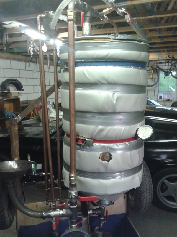

I got a few 4pin, 3 phase lugs and sockets sorted so changing from the lathe to the pump will be a lot quicker now:
And got a solid pipe from the pump the top of the tank, its really getting there:
Starting on the electrics next :)
More to come

Is that a single to 3 phase converter? If so what type is it and any advice on getting a reasonably priced one?

That's right.  At the time I thought I was being ripped off, I paid £300 for it (bought it at the same time as the lathe).  It can manage at least 5hp, I think it might even do more.  Luckily the lathe is about 3hp so I've connected the converter to a 13 amp socket.  I set it to 2hp to run the pump.
I'm afraid I don't know a great deal about it other than what you have already spotted.  I.e. its a converter rather than a an inverter, and its not a rotary type.  What I can tell you is that there doesn't seem to be too much in the way of expensive component in it.  I bet it could be made for a lot less than I paid for it.  If you want to copy it you are more than welcome to study it.  There is a transformer, a funny relay thing, some switches and a load of capacitors in the box that seems to be it.
I could bring it over if you want to have a look over it?
