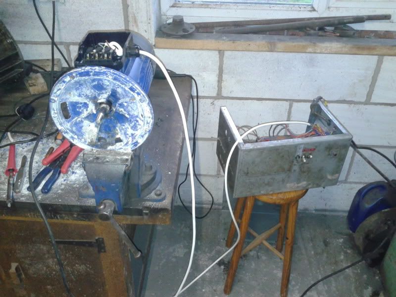

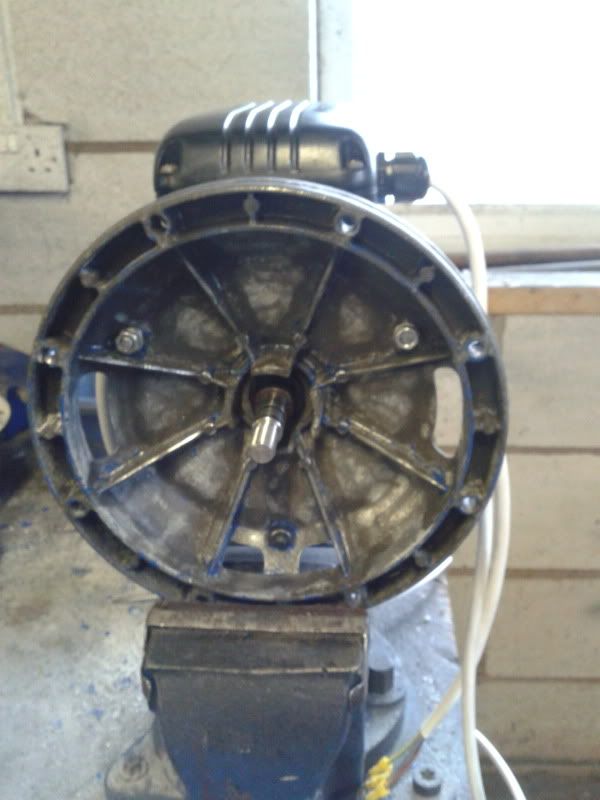

First I took it apart and freed it up.  The got it running from the 3 phase converter.

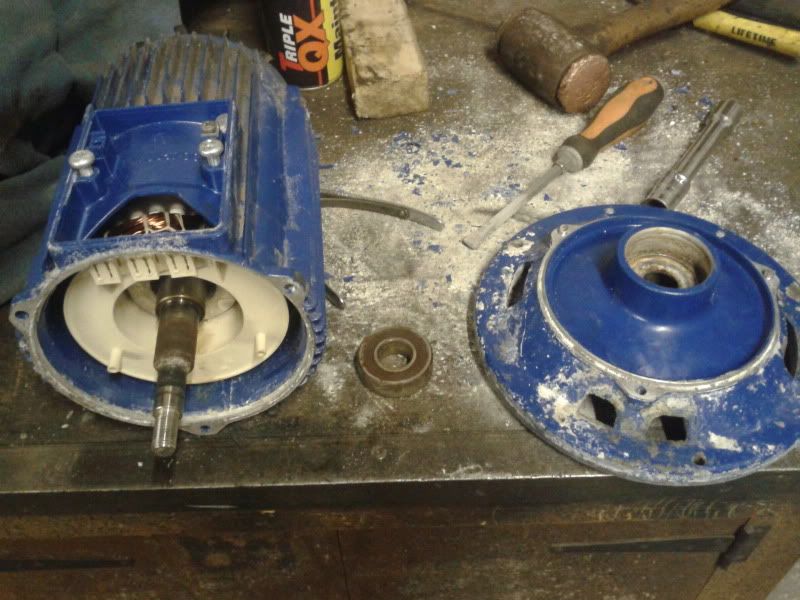

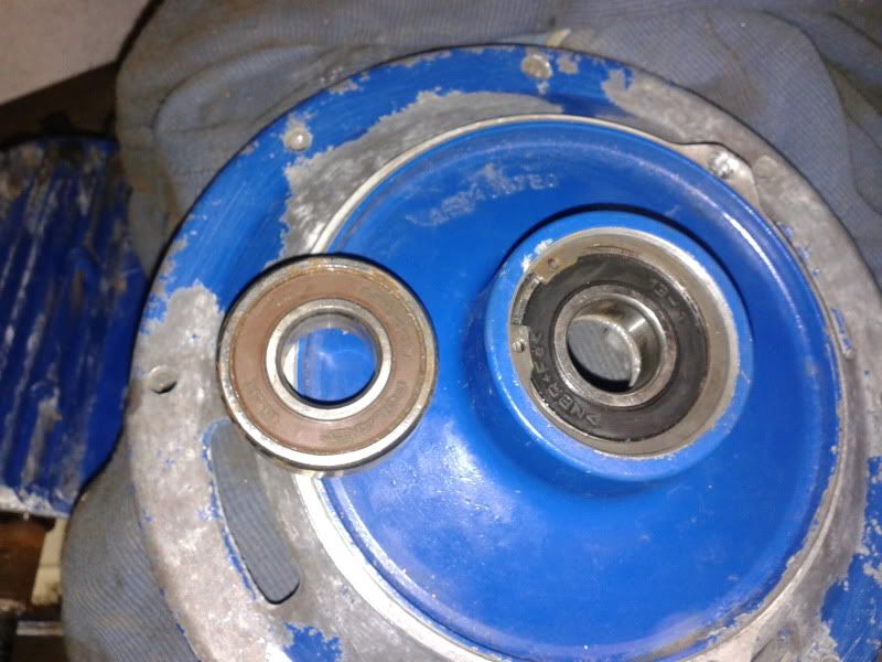

The made it quite apparent that the bearing was history, so I took it apart further and ordered a bearing and a seal kit.
This morning, I got that fitted and ran the motor again.  It runs really smoothly now.
This is about as far as I got this morning but the misses is going away for a bit so there will plenty going on :)  I'll hopfully have the pump back together before long and start doing some practice welding with the 0.6mm wire.   I've been ordering parts from BES and the Bay, can't wait :)
The pump is a CEA210/4/A-V (300lpm), it cost £45, the bearing was £4.95, and the seal kit £25.  If all goes well that should be a bargain!

Ah the familiar innards of pump.
I made the mistake of using really budget bearings, which lasted about 4 hours.  A slightly more expensive set are still going, however :)
« Reply #63 on: April 07, 2014, 08:10:56 PM »
Oooo, I hope I got a goodie then, I think it was second most expensive, made by FAG, I've heard of them so fingers crossed :)
