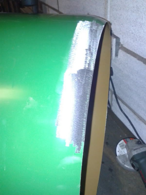

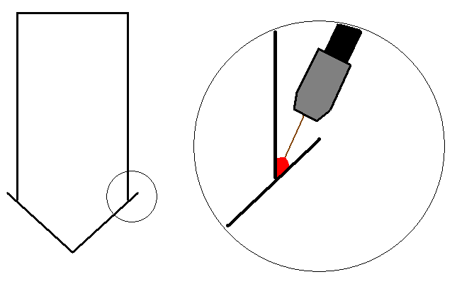

I cut the bottom off the barrel this evening and removed the paint.  I chose to make the cone well oversize so I would have a joint like this to weld into:
This way I can trim off the excess metal with the grinder later.  I've done a bit of welding but I'm still really cr*p.  I find a joint like this much easier than a butt joint.

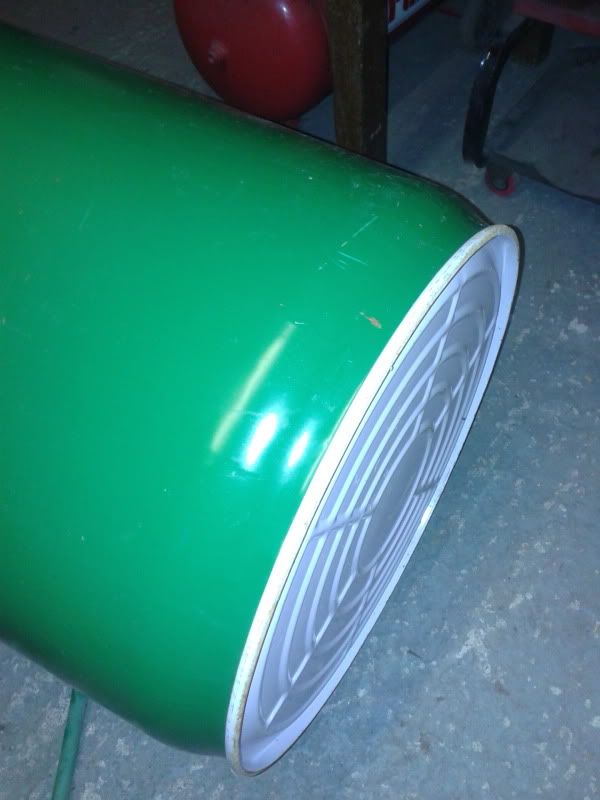

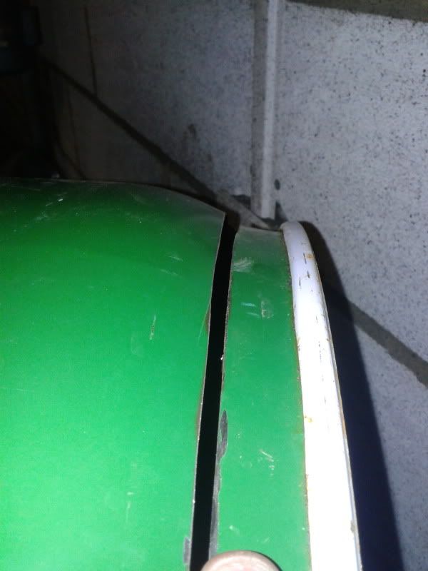

I cut the bottom off the tank a couple of cm up from the bottom and removed the paint ready for welding:

and its funny you remind me of someone with the pictures :) bit of ms paint work

Its my advanced CAD package :)

I might not be very good at welding, but I've done a lot of it. Trying to weld a sealed joint is a whole different ball game. The first cone I made leaked like a sieve, and was unrecoverable.
Second one didn't look a work of art, but was perfect.
New 0.8mm sheet, with new 0.6mm mig wire. New tip and shroud.
20mm overlap onto the drum. The cone has to fit perfectly to the drum, the slightest gap will cock it up.
The metal needs to be spotless clean, no rust,no paint. (don't worry about the inside, but you'll be able to see the penetration better if there is no paint on it.
The seal comes from the weld fusing the cone and the drum together, not from filling in the edge of the cone against the drum.
Three quarters of the width of the weld will be on the cone, the last quarter just overlapping the edge, onto the drum. Inside, the weld just wants to be slightly penetrating the surface of the drum, a slight black line, and a little ripple. The power and wire speed need to be perfect.
I did about 10 foot of practise weld first, with the same steel, to set the mig up and get everything right.
If it is undercutting, it will leak, if it is to proud, it will not penetrate and fuse the two pieces.
Grind back the weld every time you stop, so your starting on clean steel. Grind out tacks, don't weld over them.
It was a clown of a job, and took me all day. I must say, my view of what a strong weld is, has changed considerably after doing it.
« Last Edit: March 26, 2014, 06:22:26 AM by greasemonkey »
