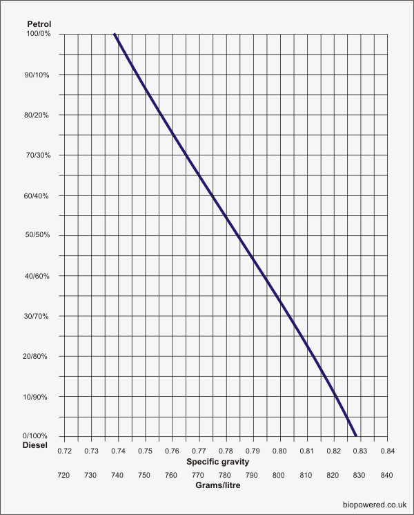

Before using misfuel it's best to know the proportions of petrol and diesel in the mix. At the time of writing, two independent tests have been conducted by zebedee and Rotary Motion to ascertain the percentage of each based on the specific gravity (SG) of the mix. The SG of forecourt bought fuels varies quite a bit, petrol between 0.71–0.77 and diesel between 0.82 - 0.95 so the graph below, which is an average of the two tests, can only be considered as an indication of the mix ratio, not and absolute measurement. It is assumed that tests were carried out at between 17°C and 20°C.
The specific gravity can be measured directly using a hydrometer and the ratio read off the graph. Ensure that the temperature of the misfuel is 17-20°C, that there are no air bubbles on the hydrometer and that it's not touching the sides of the test cylinder. (for more info on using a hydrometer see Testing methanol purity).
Alternatively the misfuel can be weighed. If weighing and accurate scales are to hand, it may be more accurate to weigh 1kg of pure water at between 17°C and 20°C and carefully marking the level on the container. Then refill with misfuel at the same temperature, to exactly the same level and note the weight.
To calculate the quantity of misfuel to add to a known volume of WVO or biodiesel, the following calculation, originally posted by zebedee, can be made.
Suppose that your misfuel weighs 812 grams. This gives a 20% petrol and 80% diesel mix. If you want to add 5% petrol to 50 litres of biodiesel or WVO, 5% of 50 litres is 2.5 litres of petrol but your misfuel is only 20% petrol, so divide the 2.5 litres by 0.2, giving 12.5 litres.
