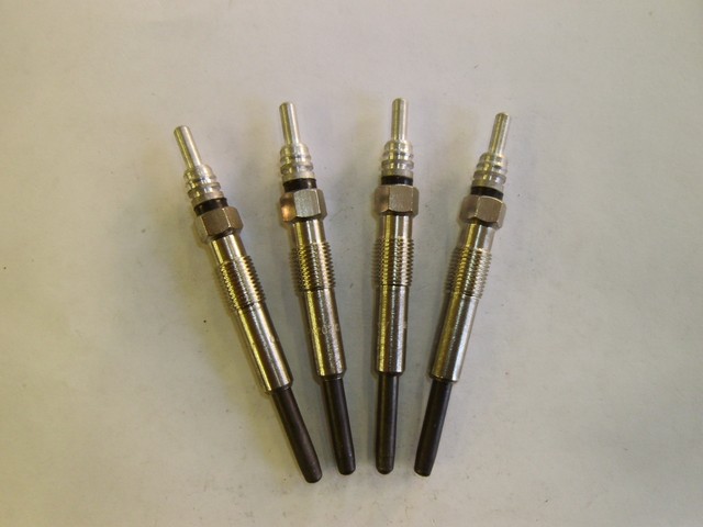

i beg ya pudding, i read wrong i thought it fell off, ok so its stuck in situe, yeah may be bad that one...
thought they looked same as these though
