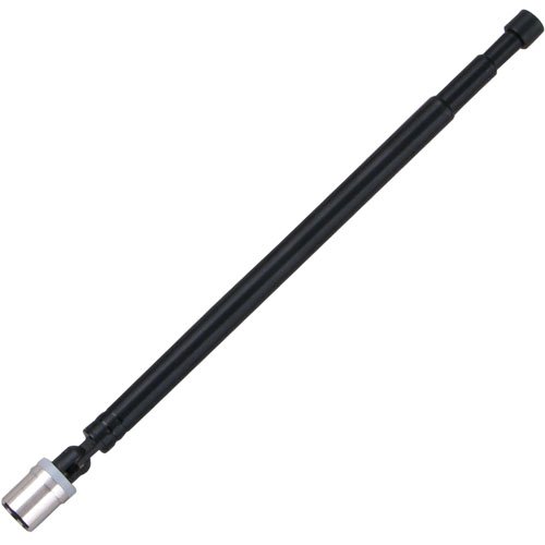

if it was metal the end bit you could get a magnet down there one of  those radio type telescopic things down the hole...
i wouldnt think there is enough room to hide in carbon more its stuck itself in head or piston top. like valves do when cam snaps
