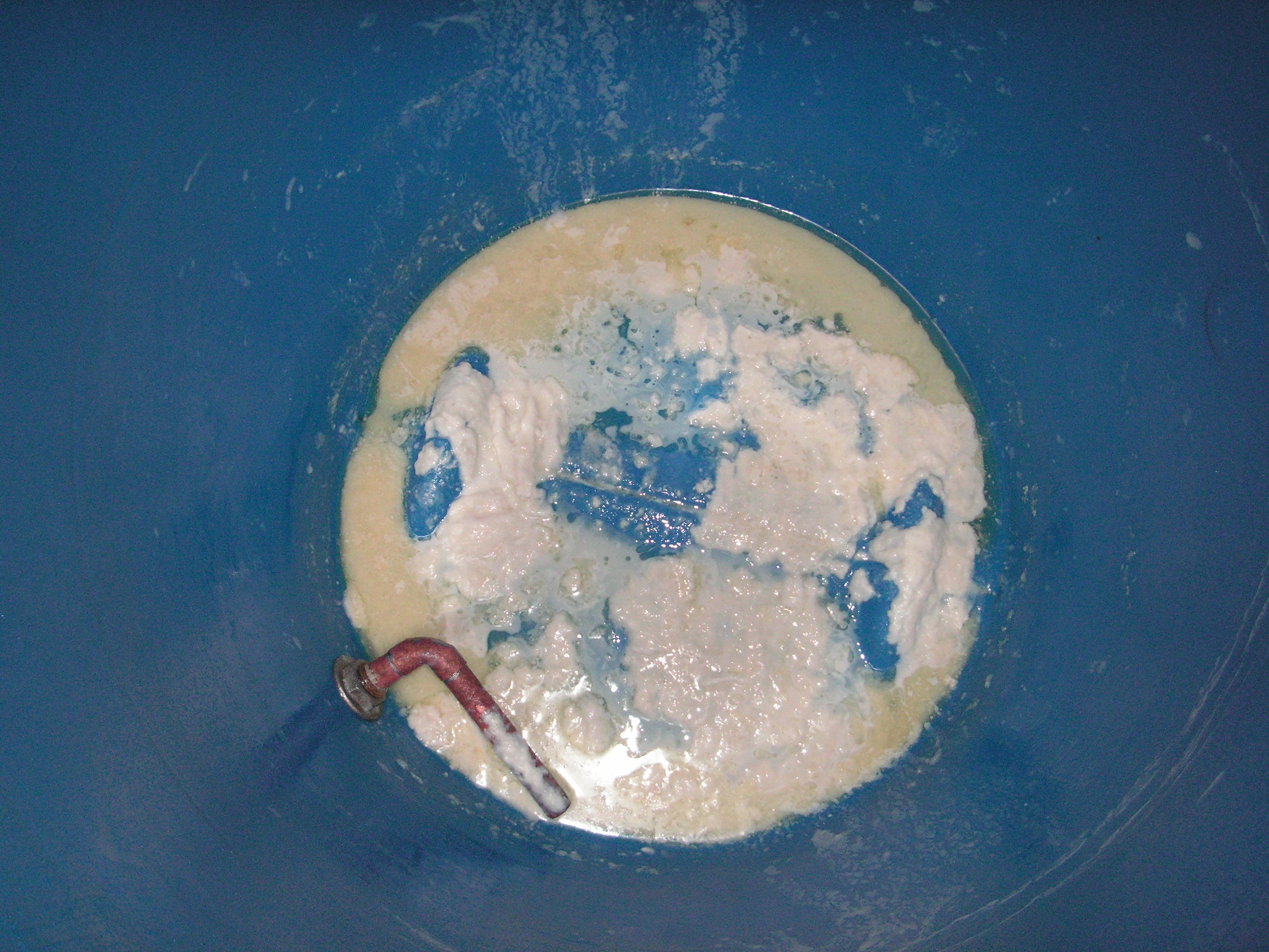

Keith ... I've just uploaded this photo ...
Of an emulsion formed at the bottom of my wash barrel.  Might be of some use on the Acid wash page to show what we're trying to avoid.
I've added it to the water washing page and it should come in useful when the "Emulsions" page gets written.

Is that emulsion or HMPE's Julian? just looking at the residue around the sides also.

I would say Hmpe's, I get the same now the temp is dropping, I will gladly stand corrected if i'm wrong though. Hoping that the acid wash method is going to cure my Bio of this.
Looking at your description on the Wiki page it would seem I am going to be wrong !
Thanks Julian,me and Jules are making a start so all pics/suggestions welcome

Definitely an emulsion, been getting to a greater or lesser extent most of the summer.
Splits to bio and water when heated.
Okay I think I got the wrong end of the stick at the beginning of the thread, duh !
  so is heat all that's needed to split an emulsion ?
