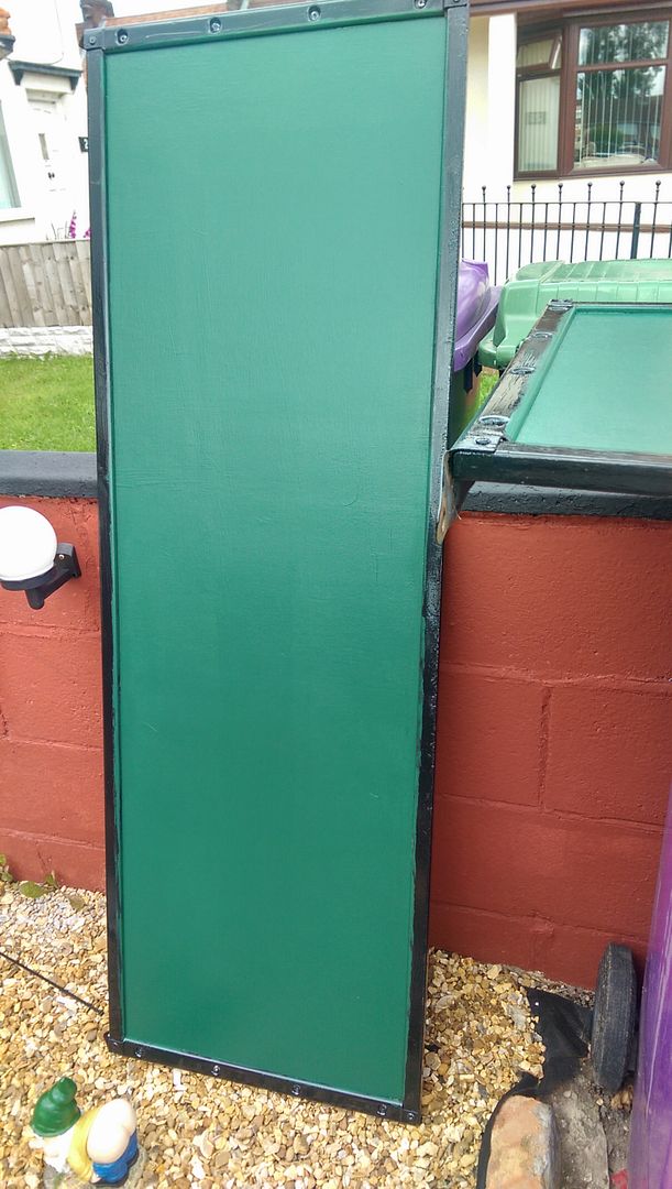

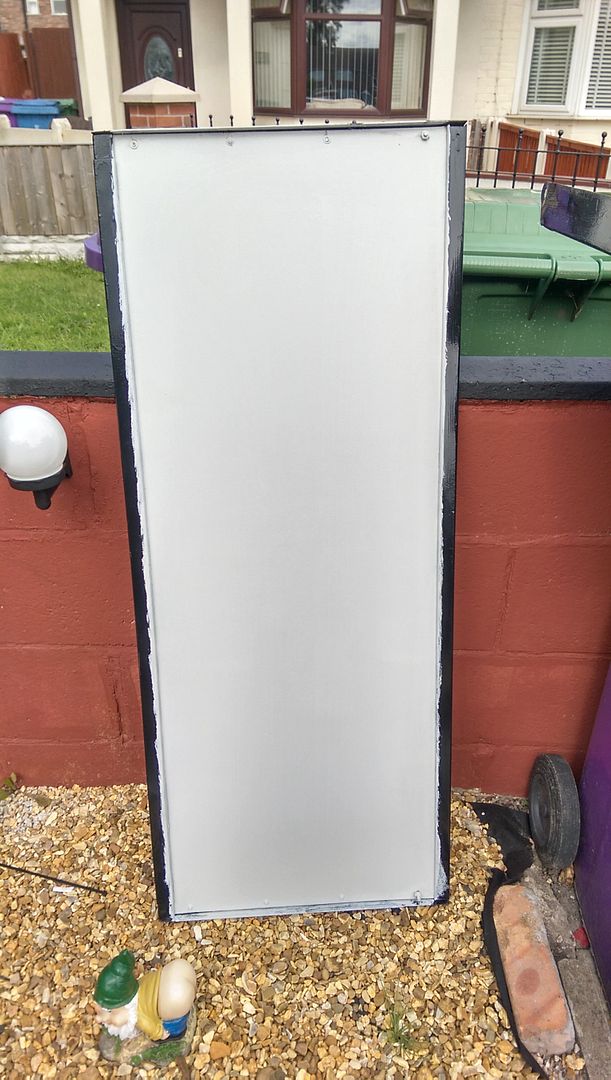

any thoughts on the panel?
Re: trailer mods
« Reply #17 on: August 12, 2015, 12:54:15 AM »
If you're refering to the items linked to, yes nice kit. I don't think the side reflectors are required but wouldn't hurt if you fitted'm.

Re: trailer mods
« Reply #21 on: August 12, 2015, 02:33:47 PM »
Yes it is the one i have on my caravan. I am very pleased with mine and it works very well. It is also very light compared to a framed panel.

jules, thanks, whats it like in normal daylight?

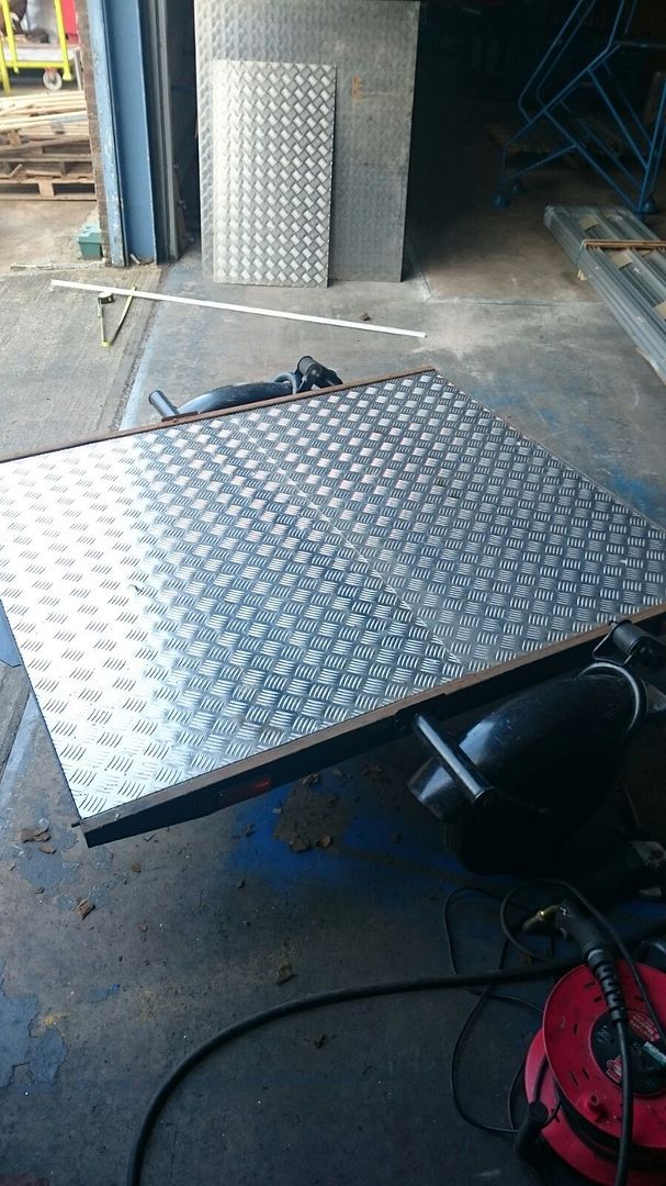

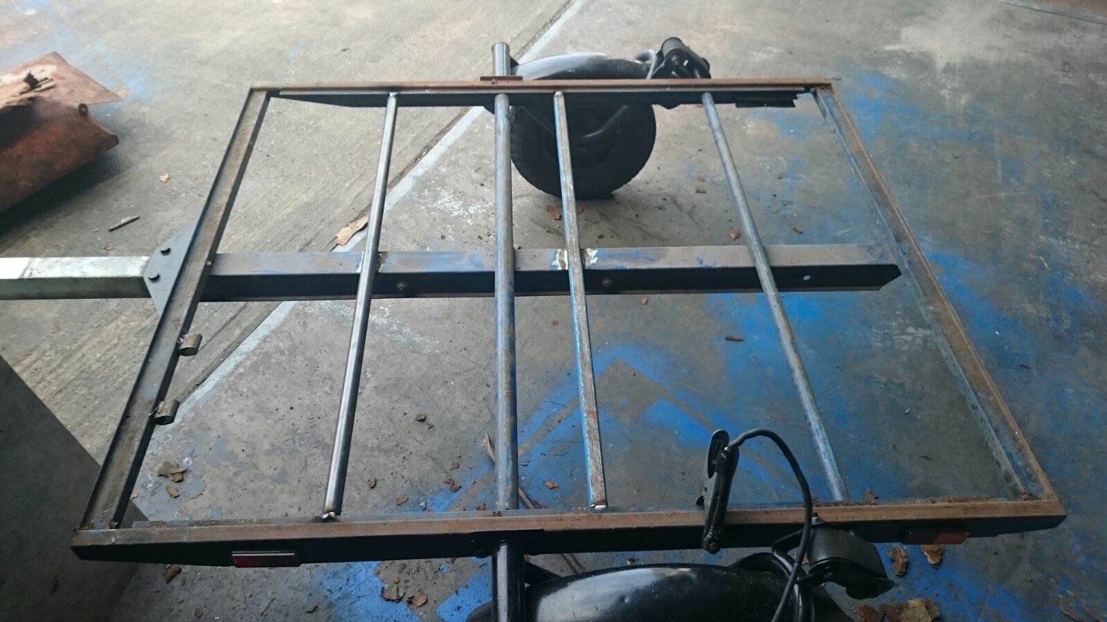

simon stripped the floor and sides off as they were either rotted, or on their way. the chassis was in good nick, but he future proofed it by reinforcing it with extra struts. (25mm box ) section
the floor was replaced with 4mm chequer plate, siliconed and tech screwed all round.

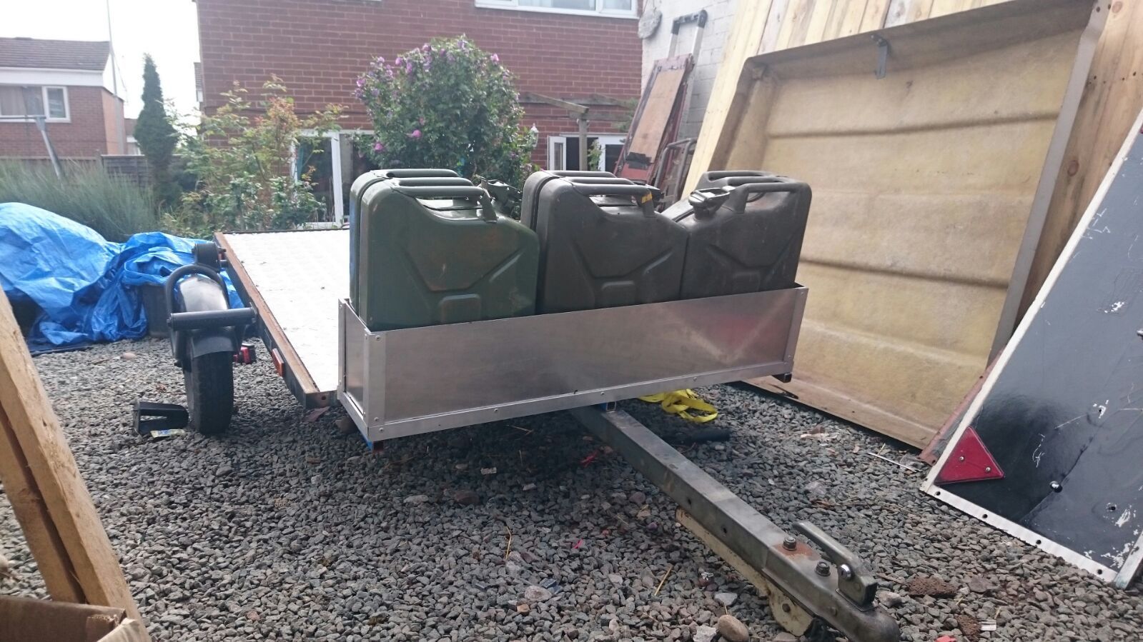

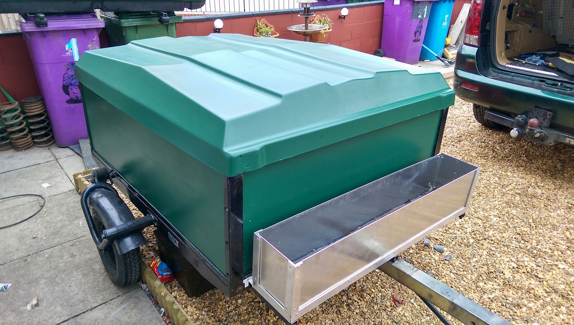

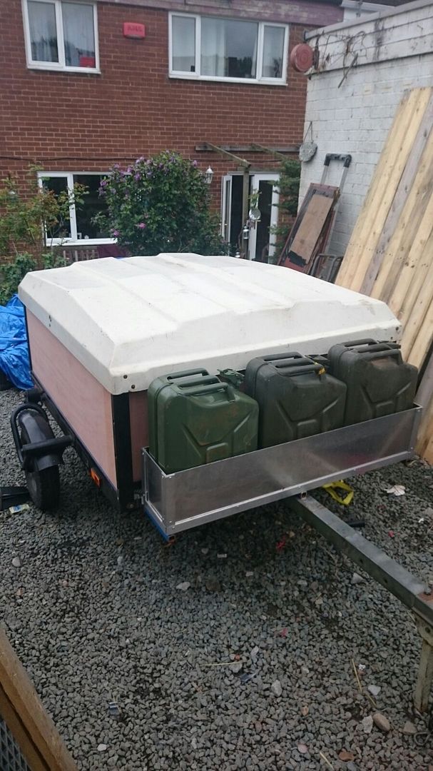

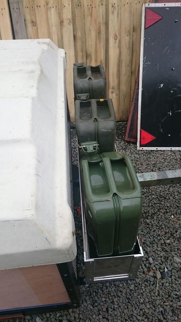

next, the carry box for three jerry cans to carry pump diesel in  :o
again made from 25mm box and 7 inches deep. will have high density foam lining to stop rattle and lateral strap to keep them in place.
plenty of space to clear the lid.
and some new sides all round, with the alloy caps and runners replaced.

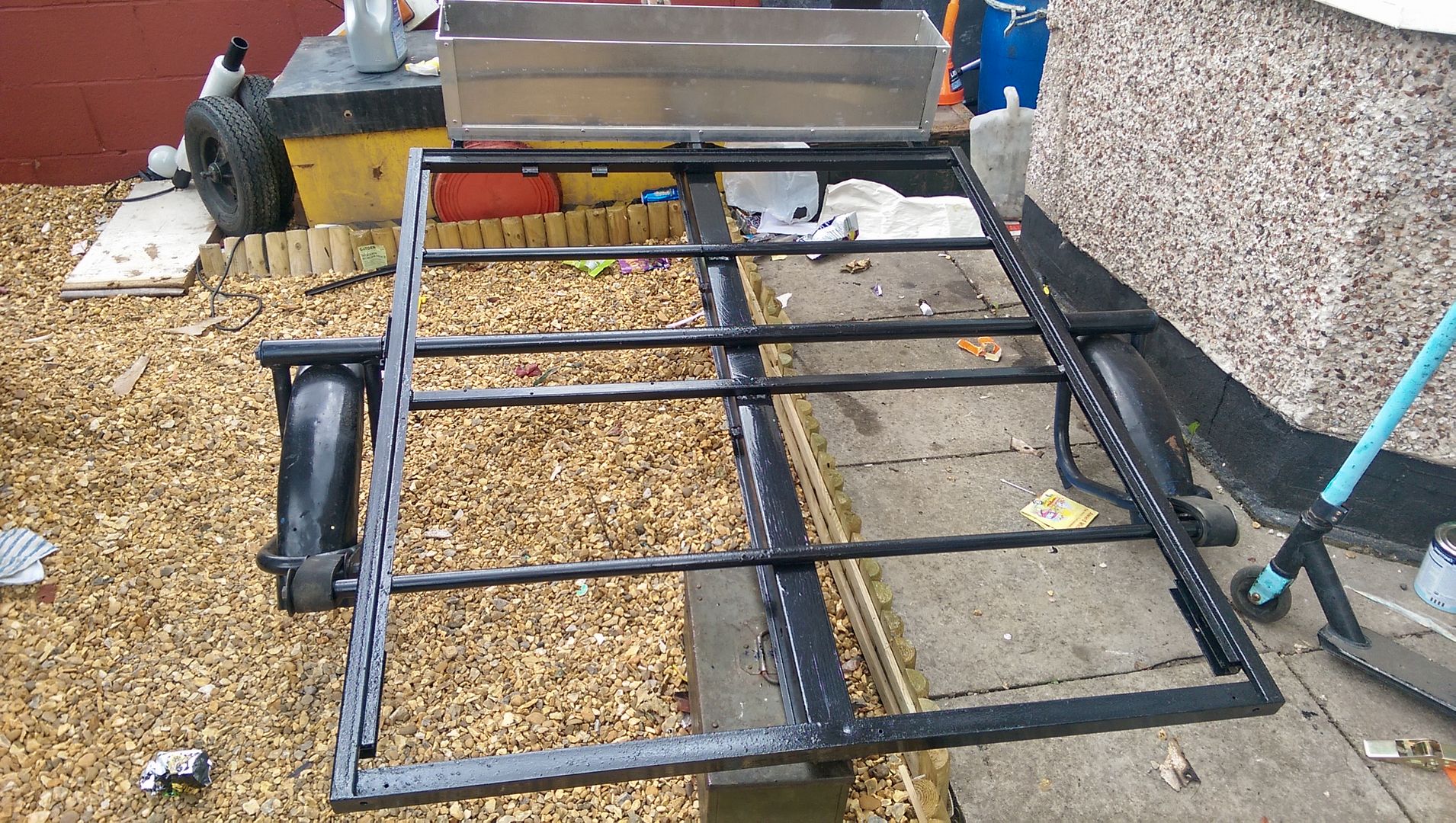

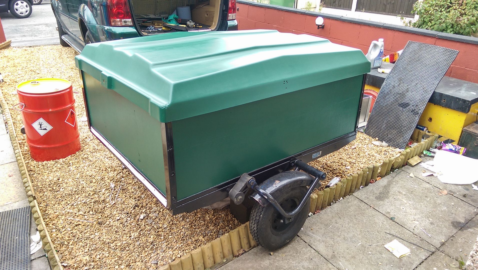

« Reply #25 on: August 29, 2015, 04:56:54 PM »

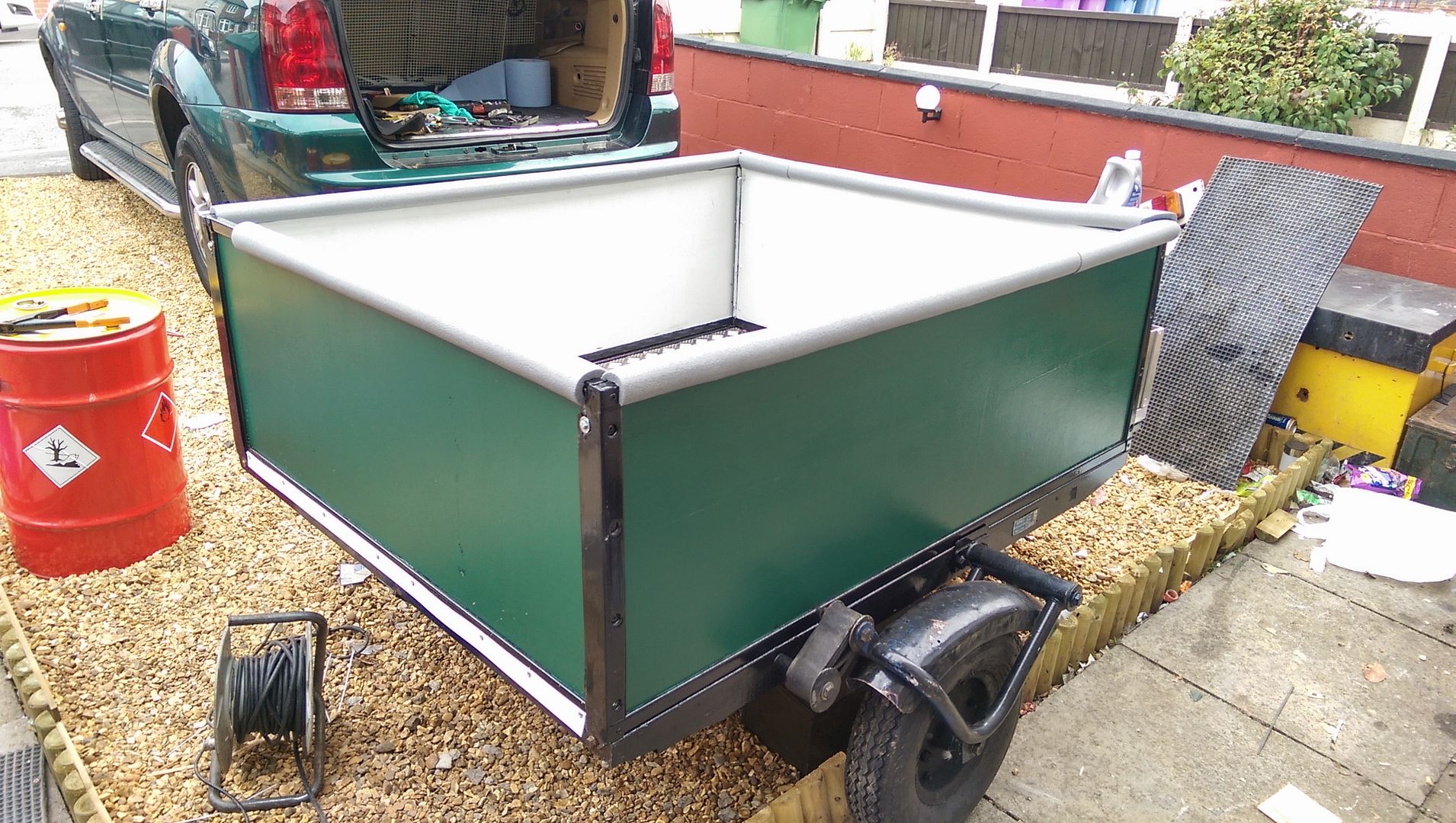

stripped it and wire brushed the chassis down today.
gave it a coat of aldi metal care paint (4:99 per litre)
then i cracked out the aldi matt silk (nope never heard of it either) dark green and set to work on the sides.
three coats each and turned over for the inside. (left over light grey matt silk from aldi, again £4.99 per L)

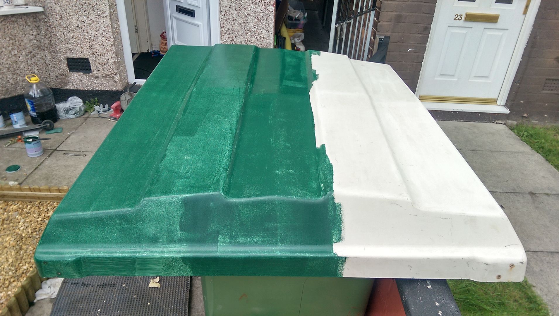

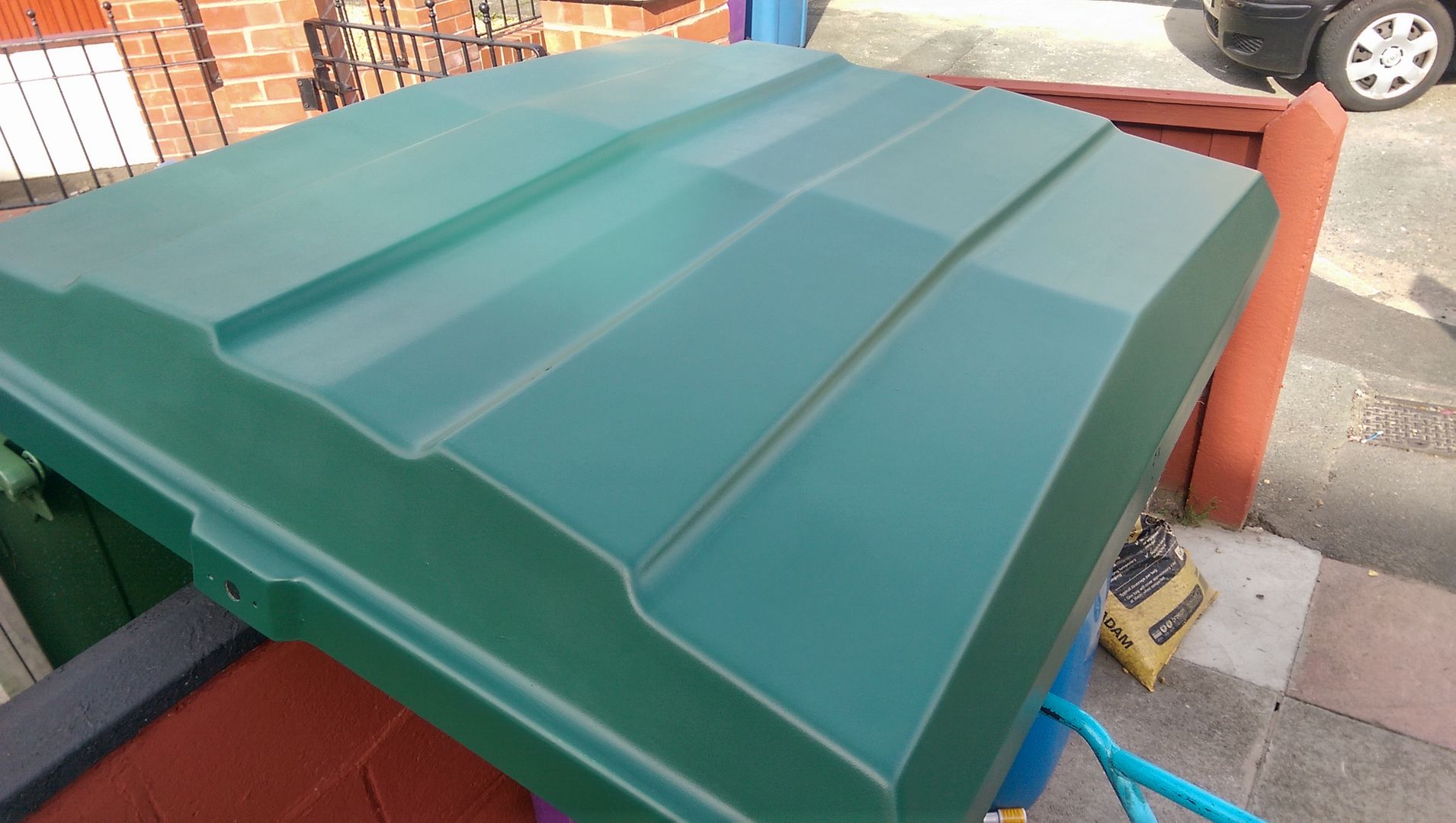

then to the GRP roof.
got the sander out and gave it a quick stroke, then more of aldi`s best dark green (3 coats)
came out ok...

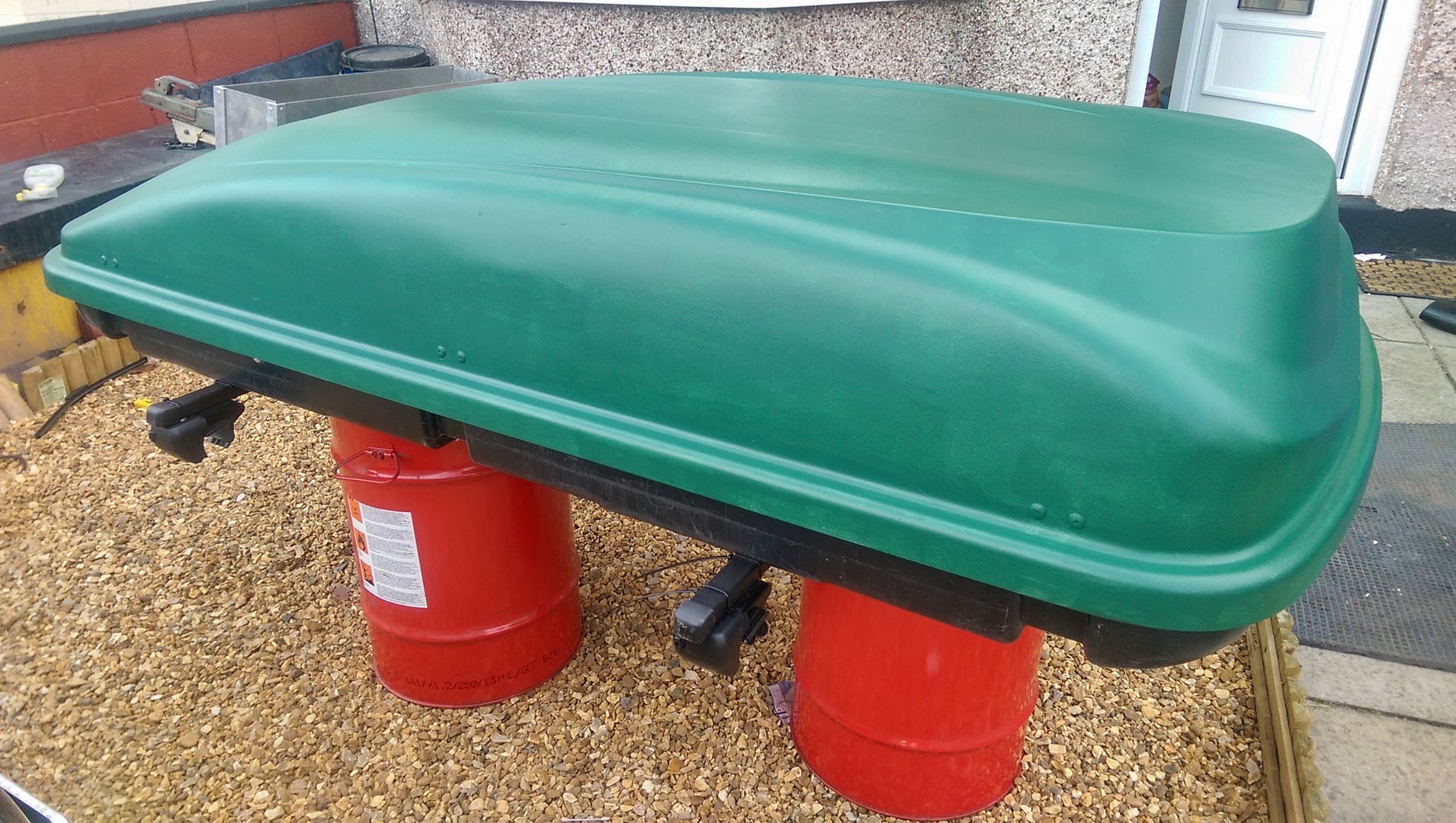

and seeing as i still had a third of a tin left i started on the roofbox
will touch up the black borders on the sides and start putting it back together tomorrow.
 ;D

« Reply #26 on: August 29, 2015, 06:30:29 PM »
Looks great will show the car up have to get a new one to tow it ⑤✴

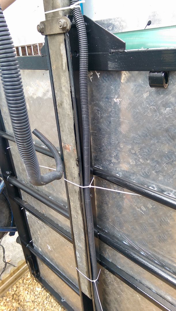

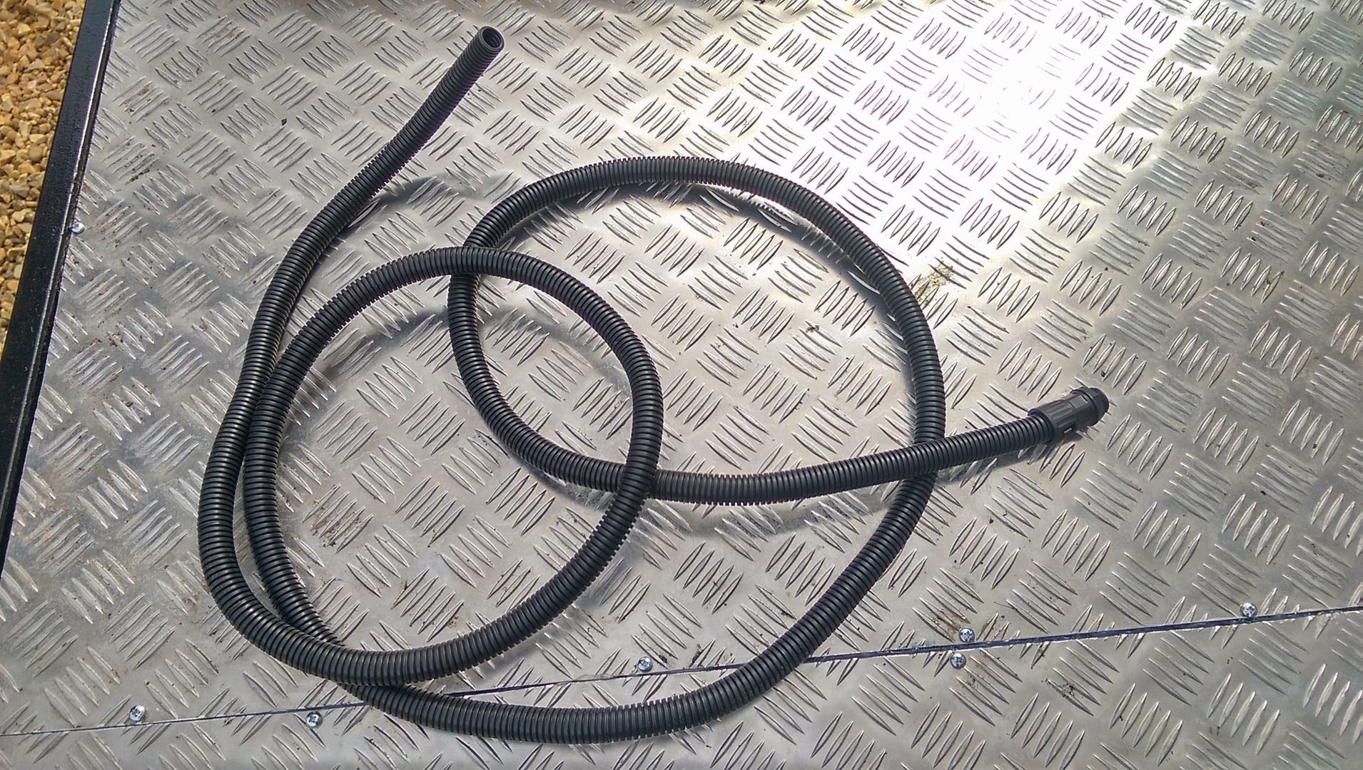

found this in a skip
so drilled the base and fitted it ready for the electrics.
put the sides back on..complete with pipe lagging glued in place to seal the lid.
and dropped the lid on till it dries...
