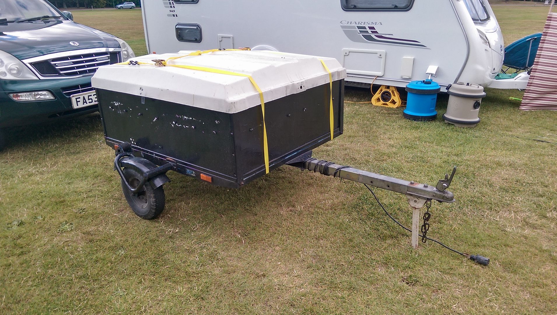

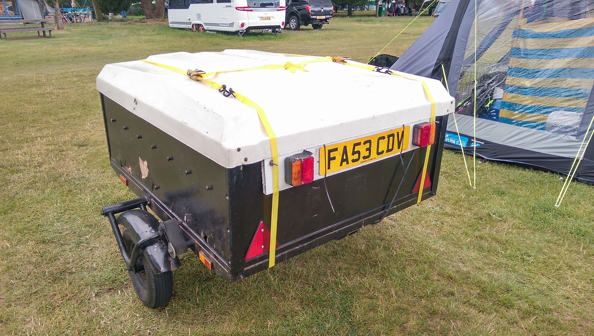

as you know, i bought a trailer the other day.
although its serviceable, its not quite right.
this is what it looks like now
Re: trailer mods
« Reply #1 on: August 04, 2015, 11:31:44 PM »
the draw bar extends from 2 foot to 4 foot and its rated at 435K at the moment.
so any suggestions for must have accessories are welcome.
sort of a communal "design a trailer"
so, first. does a trailer have to be plated, who plates it, how do you get it changed and what happens with home made trailers?

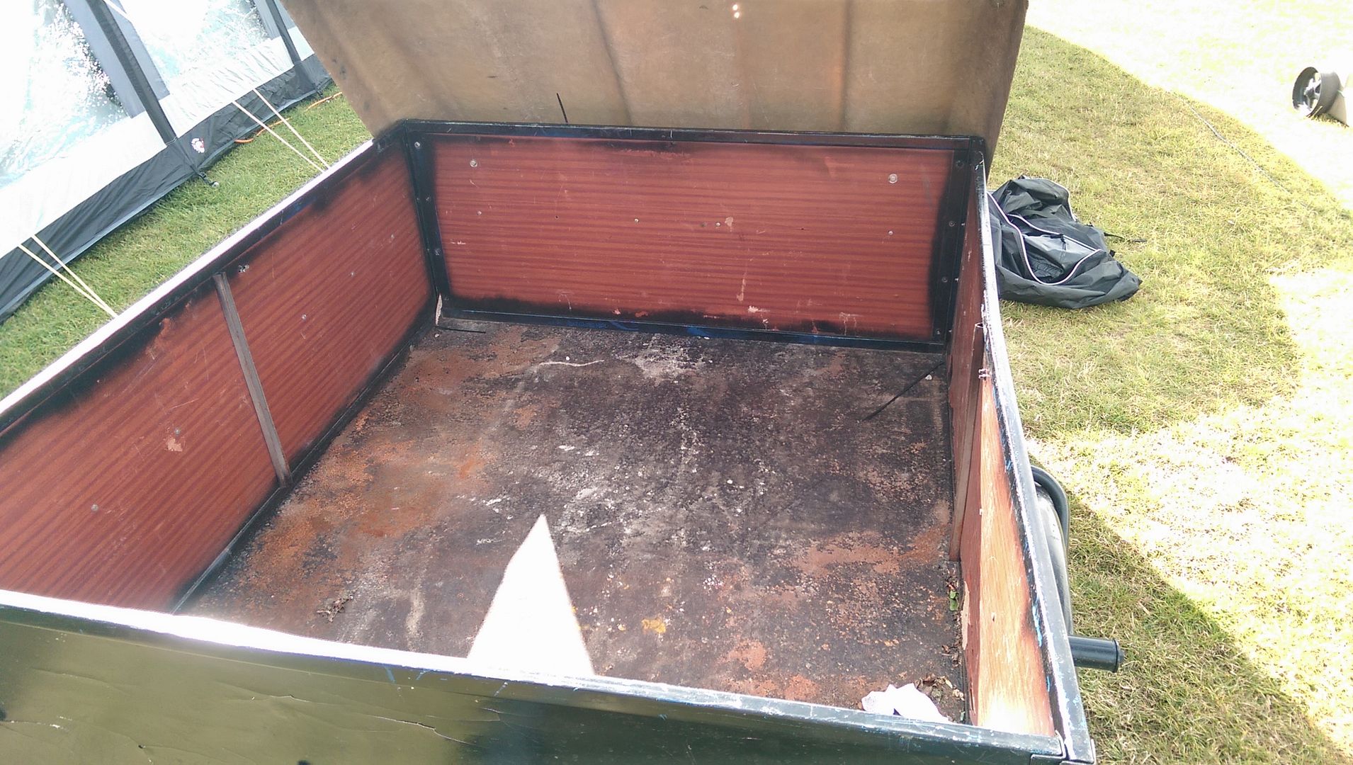

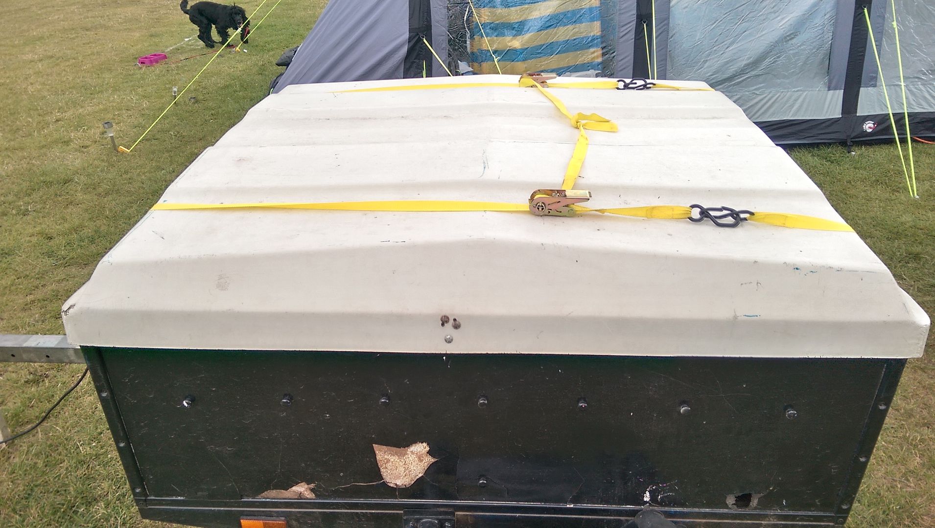

oh, and how do i paint the GRP roof without it cracking when it flexes.

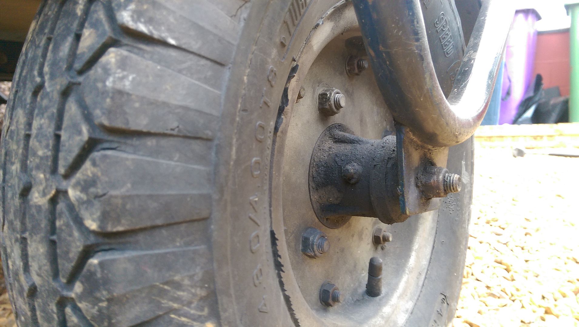

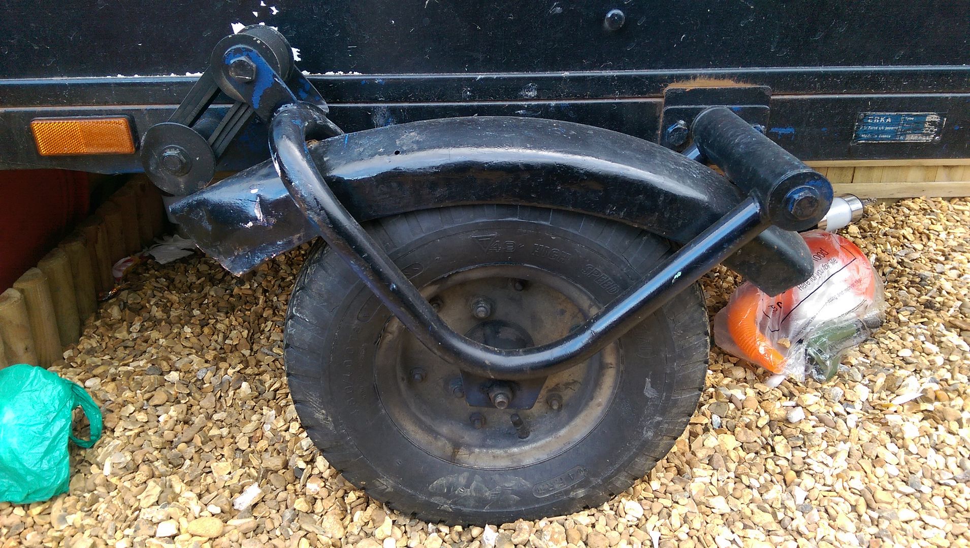

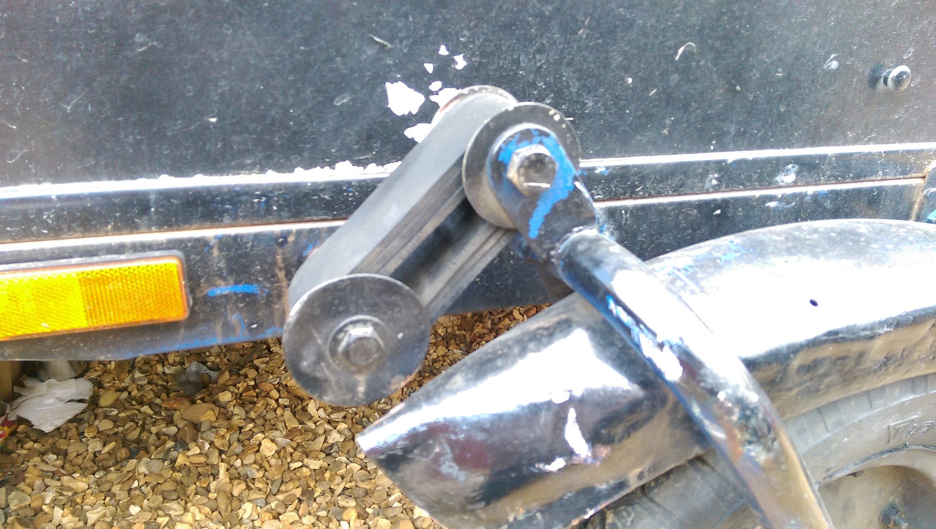

Is that realy big 'laccy bands as a suspension?
Is it German by any chance?
Sure I have seen something similar behind bugs and buses at VW shows
Re: trailer mods
« Reply #4 on: August 05, 2015, 12:03:57 AM »
yup . the wheel pivots on the front and the bands restrict the movement.

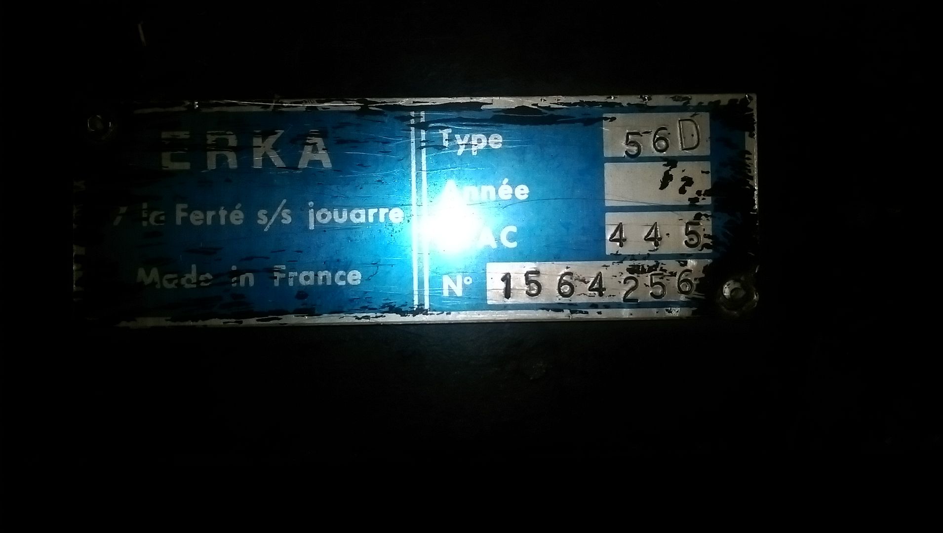

this is the plate
so french.

French, that explains the quirky suspension then.
Basic, simple, works.

A far as I know, you are limited to a 750KG maximum gross weight without brakes. This is providing the tyres and suspension are rated the same, or above.
You can plate it yourself.
There are no special requirements for the strength of the chassis, it just has to be "strong enough"
There is no difference between a home made trailer, and a manufacturer built one. I used to work for a guy who made trailers. Designed and built by him (and me). They were basically home made trailers, we just made lots of them.
Two pack epoxy paint may be a solution for the fibreglass. Key it well, would be my advice.
