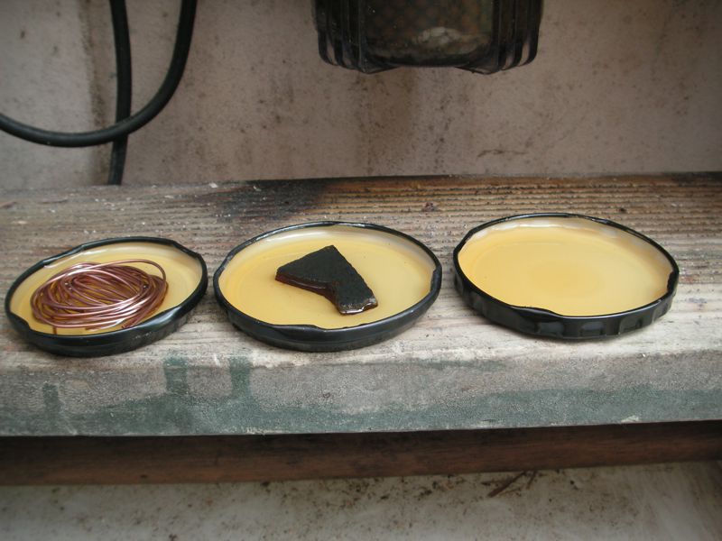

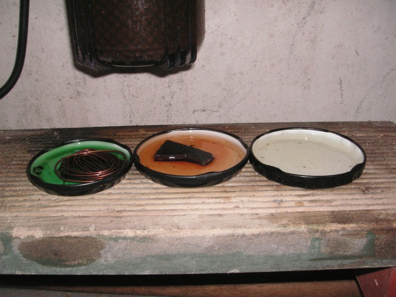

Dave, if you check out the page where I've been valiantly and single handedly carrying out Nick's suggested test ... http://www.biopowered.co.uk/wiki/Biodiesel_and_oil_oxidisation_collaborative_trial
There's a notable difference in colour between the pure bio in the first photo compared to the second.

Do you mean the 2x photo's on vod. If so it is the difference in the light, there is no difference in the finished bio colour after a day or even a few hours if sunny when stood outside. The 2x cubies of 'bleached' bio in the photo, (No's 4 and 6) may look slightly different as one is filled to capacity, no air, not even in the handle to eliminate the possibility of oxidation.

Ah, with you now, you mean sample on the right in your photo's. yes, I see the change. Could be a similar thing to my observations.

These two photos ...
and

I intentionally put only about 1mm of bio in my petri dishes. They can now be turned upside down and nothing falls out.

My samples look like Julian's but not so pronounced in terms of colour change. I think this is because the metals in my samples are completely submerged by the bio. The viscosity is probably similar to that of unconverted oil now. Still no sign of acidity on the nose - which does surprise me. Maybe the acids are volatile and are lost because they are totally open to the air. Might try another sample in a closed jar.
