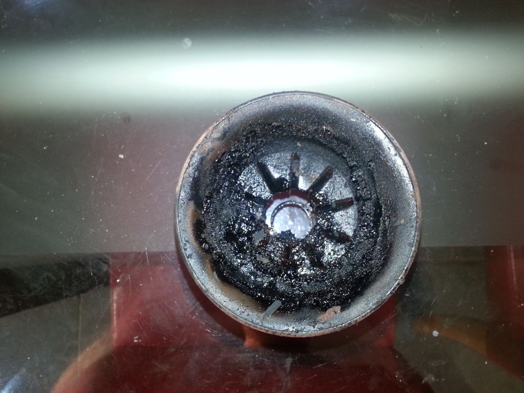

As many of you know, my heating has been running on B100 (made from palm oil an kept in a heated, insulated fuel tank) for quite some time.
Recently I moved things around a bit and upgraded to a more modern boiler (still 1980s but newer than the 1972 one I had been using).
It had been running perfectly with no smoke or smell or lockouts for just over two months since the day I fired it up. But, boxing day morning, a few hours before my parents were coming round, Tash reported no hot water.
When I went to have a look at the boiler it was locked out. When trying to restart it, it was clear that the fuel was getting through and igniting as I could see and hear the flame start but the ignition did not switch off and the fuel was soon shut off.
The photocell was clean so it had to be something else.
Knowing that blast tubes to coke up on bio, I pulled the burner out and was greeted by this in the end of the blast tube..
[/URL]
Two minutes with a knife and wirebrush made it good as new.
Burner back together and back into the boiler in a couple of minutes and it has been running fine ever since.
I am really quite pleased with that, five minutes effort every couple of months of burning bio is fine by me :)

Nice when it's a simple fix. Do I remember you re jetted the burner for bio?

sounds good jules. nearly as good as my burner. a quick backflush with a lungfull of air to clear the needle valve and a 5 minute scrape of the pot every  month or so. still experimenting with the peristaltic pump so i can burn WMO. on hold at the moment as the AVR on the genny has blown again and the replacement is somewhere in the xmas post. i can fix most things but potted electronics is not one of them. may try a seperate exciter if it happens again. need to check the voltage and current to the rotor first though. for which i need  the AVR to be working.

Jules,
When i was using the other burner, the same sort of thing happened.
One time the 'crust' grew into the jet, and caused it to drip.
Anyhow, i found that the best, but not necessarily cheapest, way of cleaning it was to get the MAPP torch on it, until it glowed red, and then a quick rinse under the tap.
I found that burning off the crud gave a proper clean finish, right down between the vanes, which was much better than i could do by hand with a scraper (and, hence, i guess, it took longer to crud up again)
Indeed, i think whatarascel mentioned putting them in a log burner over night - that would probably do it nicely too.
I suspect Jules is just running the standard setup on the 'new' burner.  I have the same burner here, and it runs bio fine from stock.
Re: Bio boiler update
« Reply #5 on: December 28, 2013, 04:00:49 PM »
Yup, pretty much stock settings.
0.55 80H Nozzle, pump pressure set just high enough to get a fierce stable flame and air just higher enough for no visible smoke.
The burner is an Electo Oil Inter 10 for those who are interested and it is fed with B100 stored at between 20 and 24 degress C (the tank heating water coil cuts in at 20C and out at 24C)
