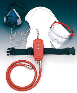

http://www.ebay.co.uk/itm/Devilbiss-Complete-Air-Fed-Half-Mask-Outfit-MPV-627-/110687377263
Youre probably looking at about £65 ish for a used set.  I have a set, with a full face mask, and i think that's about what it cost me?
Obviously then you need a compressor at a remote location also.
You need more than just a compressor.
The air needs to be dried, filtered and all oil vapor removed (all compressors put an oil mist into the out going air, this can be very harmfull over time).

the thing on the belt is a filter as well as a regulator

Copied from specs in the listing
Waistbelt incorporates odour filter and pre-set mask air regulator
Carbon Filter Life - 1000 hours
A Coalescer filter is required to protect against the harmful effects of breathing compresses air - it is a must to protect the health of the mask user.
So it seems it has an integral carbon filter (for removing odours) but requires a separate oil mist filter.

What you linked to is just a water separator, to remove oil mist you need something like this
http://www.ebay.co.uk/itm/-/151035718847?pt=UK_Body_Shop_Supplies_Paint&hash=item232a6e2cbf
I have no idea of the implications of not filtering the oil out, all I know is many years ago a wise old fellow told me is was hazardous to health.
I'm sure google will tell you why.
