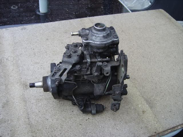

« Reply #9 on: April 10, 2013, 10:32:00 PM »
Re: Injection pump gummed up
« Reply #10 on: April 10, 2013, 10:37:04 PM »
Yuk!  Tempted to clean it up and try it out?

« Reply #13 on: April 12, 2013, 04:03:21 PM »
I'd forgotten I could post photo's using the links (until now)
So here you go, one gummed up Bosch VE pump.
The gunk softened up nicely with hot water and washing liquid, but doesn't dissolve in meths, IPA or break cleaner.
It's now fully cleaned up and back together with new seals, awaiting fitting (when I get time, and once I've convinced the wife it needs to be done).
