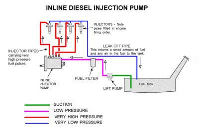

Inline Injection Pumps
Older diesel engines are often fitted with an inline injection pump. They are one of the first injection pump designs to be created and are still a popular choice for many modern lorries, construction plant, static engines and agricultural vehicles. Their robustness and simplicity often makes them very tolerant of pumping vegetable oil.
(source: max.print)

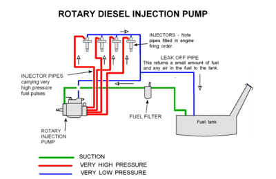

Rotary Injection Pumps
Most rotary injection pumps use the fuel that they are pumping to also lubricate the moving parts within the pump. It has been discovered that due to the design and finer tolerances within Lucas/CAV injection pumps, at lower operating temperatures they are unable to feed the more viscous vegetable oil to the areas that need lubrication and as a result there have been many recorded cases of the rotor seizing within the pump body causing failure of the shaft.
This problem has been successfully overcome in many cases using a twin tank system where the engine is brought up to operating temperature using diesel from one fuel tank and then once up to operating temperature, a switching system is used to change to a separate fuel tank containing vegetable oil. It is important to switch back to diesel towards the end of each journey in order to purge the fuel system of vegetable oil thus enabling the next start up to be on diesel.
Most Bosch rotary pumps and the 'made under license' Japanese versions are more tolerant to viscous vegetable oil and there are many reports of engines equipped with these pumps having successfully covered tens of thousands of problem free miles.
