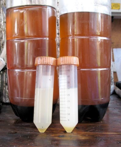

Dr pepper test by Dickjotec 26-01-2013
Not very scientific but I did a Dr Pepper. 1L oil at 30c 200ml meth with 4 .5g NaOH dissolved in it. the left hand bottle had 100ml acetone. shook both for 30 seconds then left. The acetone started to react quicker but not appreciably so. left overnight in a warm place. The results are below
As I hope you can see the acetone has produced less glyc and a better conversion.
