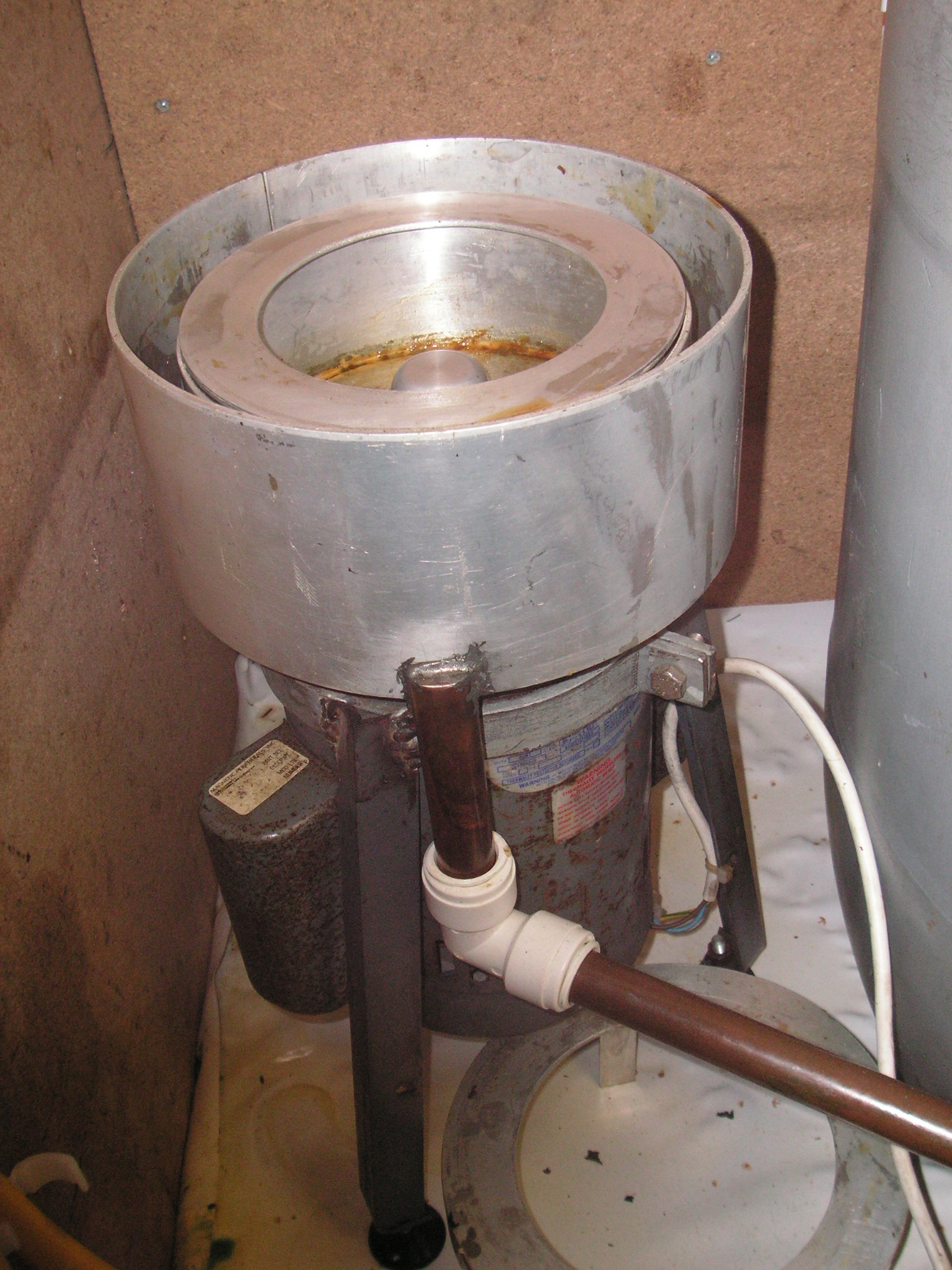

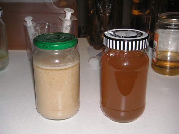

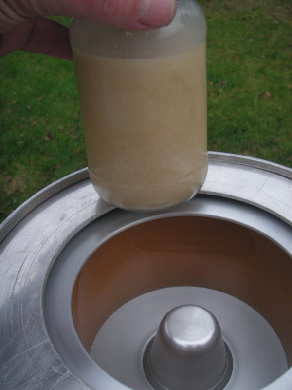

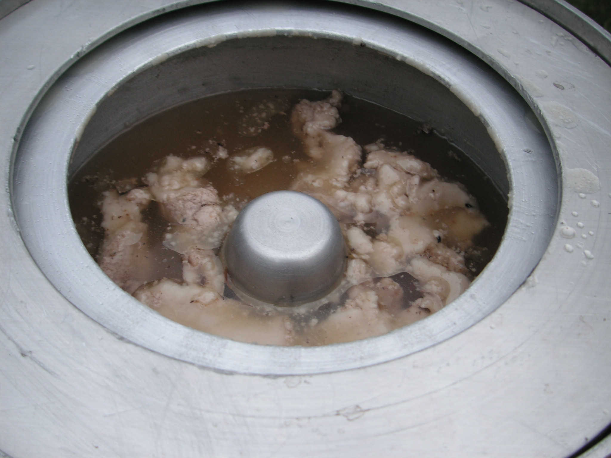

Here you go, photos of DIY Bowl centrifuge.  They've all been uploaded to the wiki, so just use one of the following formats to stick them on the page ...
[[File:Centrifuge_before_and_after.jpg]]
OR
[[File:Centrifuge_before_and_after.jpg|200px|thumb|left|Title text here]]
Let me know if you need any more.

That's really cool!  Is there any information about the connection between the motor's shaft and the bowl?
Re: Centrifuge Wiki page - critique
« Reply #25 on: February 11, 2013, 02:48:57 PM »
Yep ... hole in bowl into which the motor shaft goes, secured by a grub screw at rightangles ... why?
Coz a couple of years back I was looking at the raw power fuge talked to the guy at WVO designs.  There was a specific fitting that they used with the shaft for safety, I'll try to dig it up on my other computer.  I'm just acutely aware that if we're going to show people how to make a diy unit, we need to make sure that they understand how to do it safely.
Certainly not my intention to show people how to make a copy of it.  From a safety point of view attachment to the shaft is s minor issue compaired with the other issues in my method of construction!  The intention was to use the photos to illustrate what a bowl centrifuge was like and what it can do.
