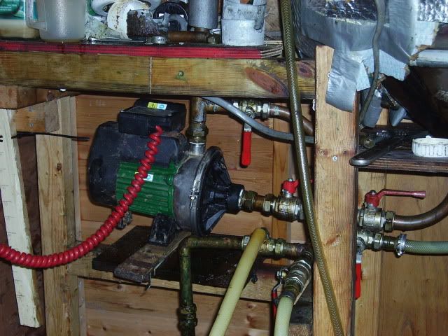

« Reply #8 on: July 21, 2012, 10:28:40 PM »
Tony you have jincksed my pump, it bloue it's shaft seal today  >:(
I was dewatering at 95°C, just as it was comming to an end oil started ot pour out.
So I've now been forced to swap the pumps over tonight as I need to get fuel done for my hols.
Here it is bodged into the system
Note the blocks of wood holding it up and the stressed pipework, but at least it's not leaking.
It's a lot louder than my old one so I'll not be able to do my late night reacting for a while.
Lets see how long these PPO pumps last.
« Last Edit: July 21, 2012, 10:30:37 PM by mark »
