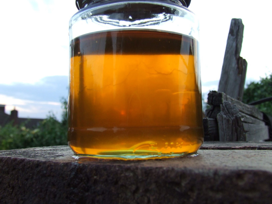

Same batch, different problem.
After a clean 100% pass on the 10/90 test I've had problems drying this stuff to the usual crystal clear pass & have now given up after about 6 hours at high temps I never normally use, and this after it had sat for 3 full days in 30-35C heat. No matter what I do I cannot get rid of the little bit of cloudiness that occurs after 2-3 hours in the fridge. I will use it as is.

Given the processing problems it could be that your oil was high titrating and had more saturated fats in it and the resulting hazy bio is just these starting to gel as the temp drops?

It's crystal clear at room temps & only goes a bit hazy after several hours in the fridge. Doing multiple tests I tried to hurry things along on the cooling front by putting the tests in the freezer. I left it too long one time & a white semi solid deposit started forming on the bottom. Dunno if this is what BD normally looks like when it starts to freeze or if the deposit is indicative of high sat fats. Left in the hot sun for about 10 mins & this raised the temp enough for this stuff to dissolve.
I reckon it's OK to use in the summer.
