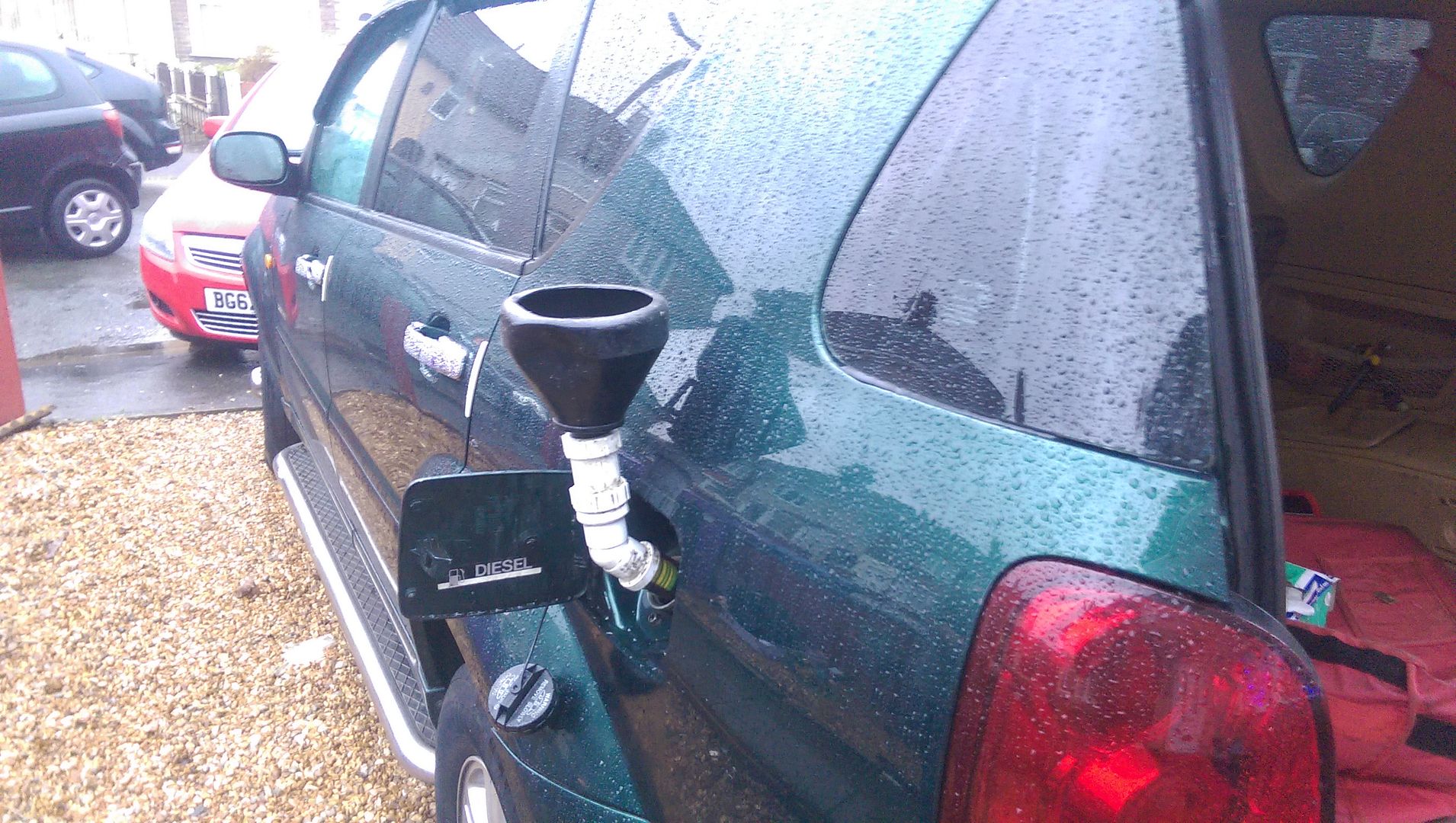

piece of waste pipe,
45 deg compression elbow
cheap pound shop funnel
some small bits of wood
glue

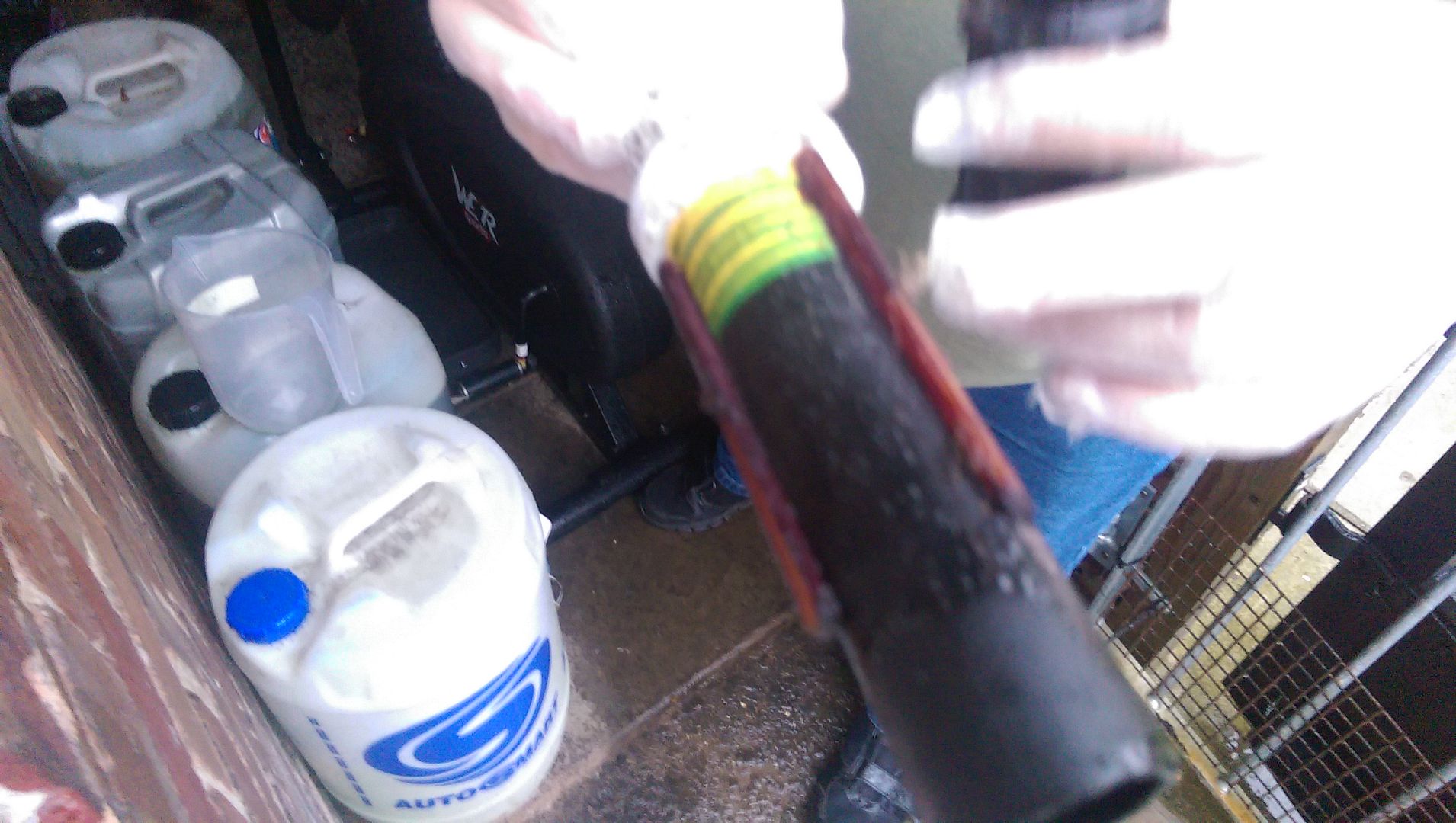

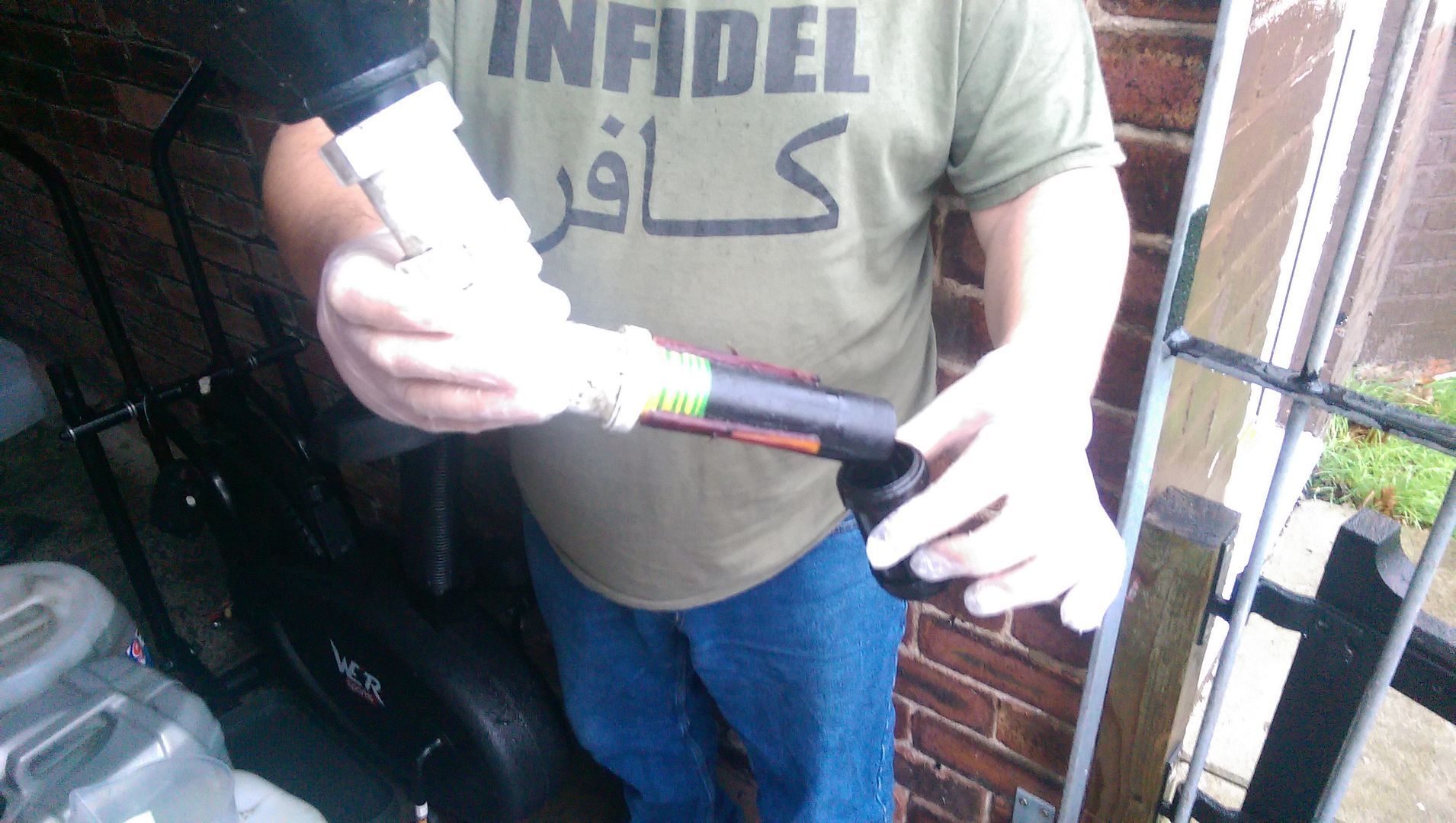

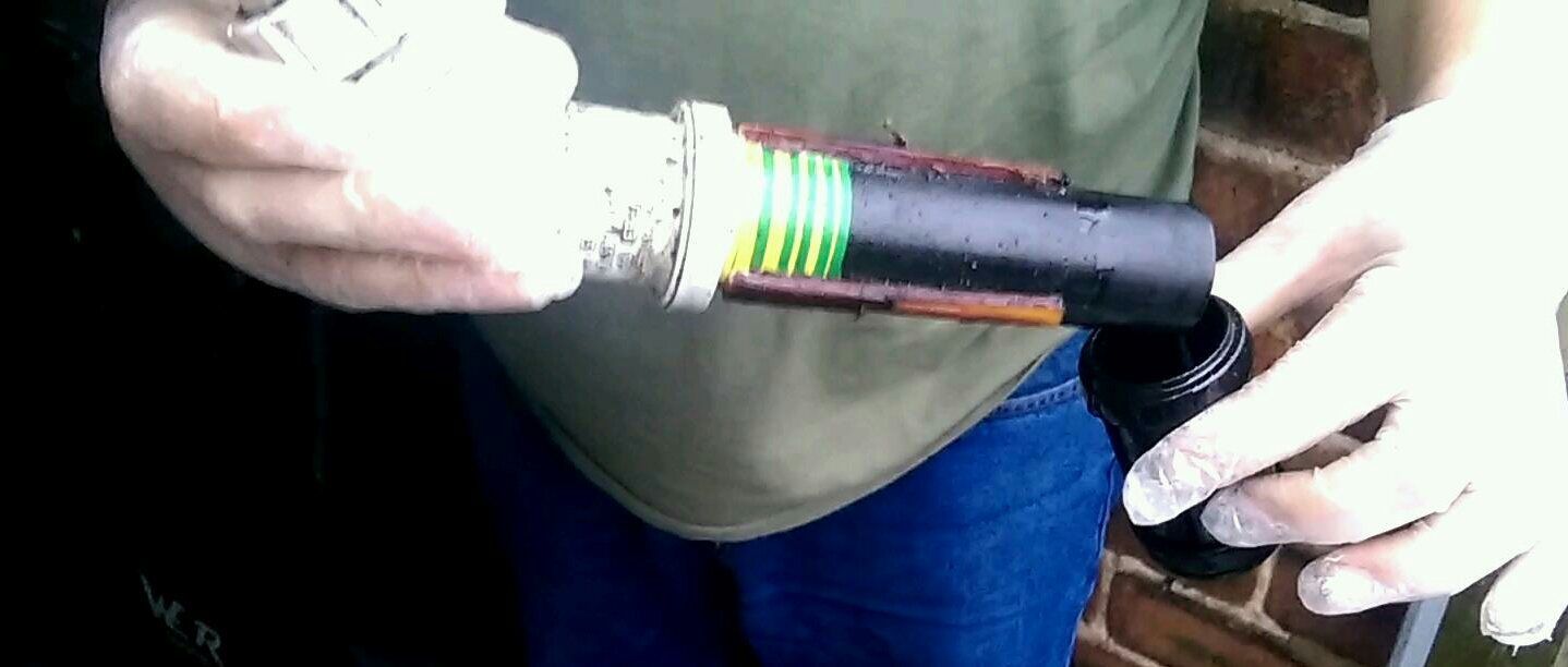

put it all together, then get the little bits of wood and stick them to the outside of the waste pipe, inline with the three grooves in the filler neck.
they act like a keyway, stopping the funnel falling over.
will show you pics later.
