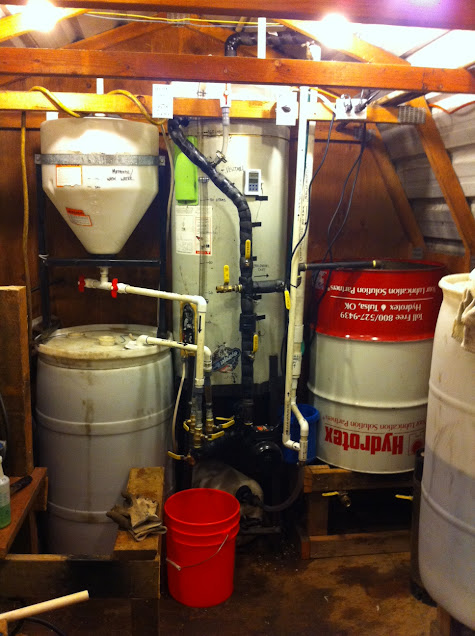

Here's just a couple pictures, although I've cleaned up since then.  I have a couple questions below that should be pretty easy.
1. What do you use to scoop out the residual soap in the bottom of the settling barrel?  My settling tank has a 10" stand pipe that I've been using to drain off the biodiesel, but now after 3 batches, I want to scoop some out.  There's only 3-4" of soap in there.  Should I just wait until it's 9" deep?
2. I have another 120L plastic barrel that I've been putting the glycerin (glycerol) in, but it has some methanol and some biodiesel in it.  I know the methanol will evaporate off, but I'm not sure how to get rid of the biodiesel.  I'm gathering up some sawdust and chips to make fire logs for my wood stove, but I'm not really getting a solid glycerin byproduct.  Should I wait until I have enough to load it back into my processor and de-meth and separate it out?  or is there an easier method?

1. I'm not absolutely sure how much soap is in there.  I know at 10" it's still biodiesel, but that's how tall my standpipe is in there.  I was shopping for methanol and I found a guy selling his whole set up including full barrel of methanol for about half price of just the methanol.  My settling tank is from that purchase, and although I didn't have to build it, it's not ideal for moving around and tipping over.
2. I'm sure there's some methanol in the glycerin.  I'm afraid of pulling too much out during WBD and reversing the process. Again, I don't have a ton of experience here, and I'd rather err on the side of wasting some methanol than going backwards.  But I thought it would naturally evaporate just sitting there with the other glycerol.  Maybe the layer of biodiesel on the top is keeping the glycerol from exposure down below?
I'll do exactly what you say.  That sounds perfectly reasonable.  It's just these little things that I'm not familiar with; like using a turkey baster to get that 1/2" layer of biodiesel off the glycerol?  Not even sure how to do that.  Maybe skim it out with a plastic cup?  I just expected it to harden sitting there for a couple weeks.  It's more like jelly now.  These really are just side bits for fun now.  All I really care about is the super awesome biodiesel that got me to work today.  Yeeehaaaa!

Excellent setup!  That's quite some shed you've got there, I'd be happy living in there :)
1) I just let mine build up, then get a spade and cut it up with the blade to allow me to pick up big chunks and stick them in a bag (being able to reach the bottom of the settle drum helps - to that end I've just got a relatively shallow steel tank which I'll cut the top off to make this easier)
2) Your Lye, is that NaOH or KOH?  Even before whole batch demeth all of my NaOH would go mostly solid (thick sludge with lumps in).  Whole batch demeth ensures this happens very quickly - and even with the most enthusiastic Methanol recovery (liquid up to 95C/203F) I've not seen any evidence of the reaction reversing.  The advantage with solid NaOH glycerol is that it's easy to pour off any biodiesel floating on top.
I understand KOH glycerol remains liquid - I'm not sure what people do to recover biodiesel from this glyc.
