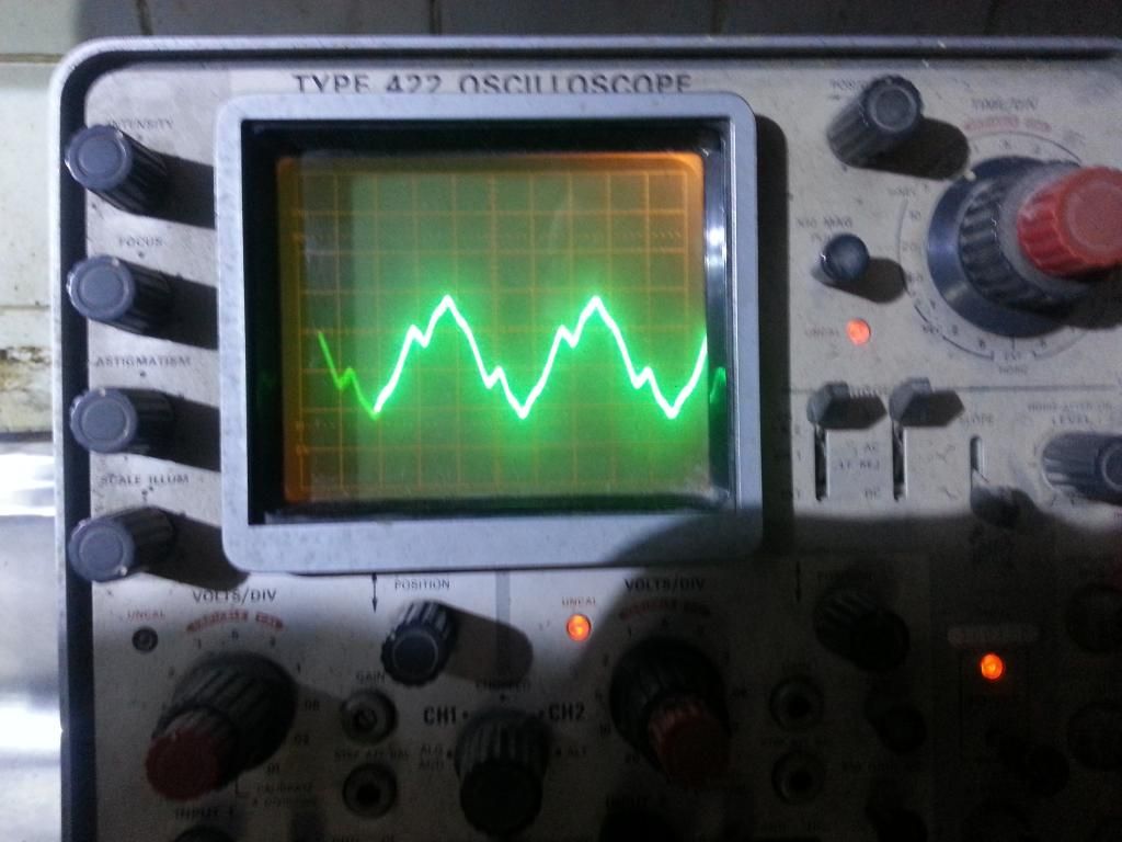

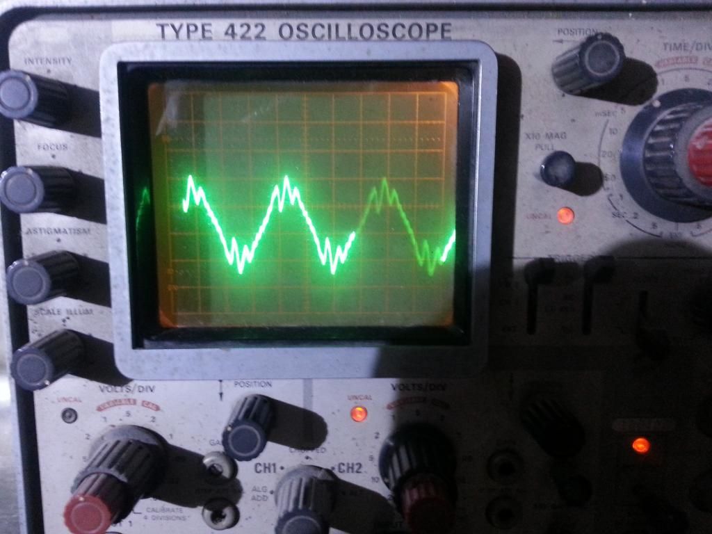

I did some more scoping of the generator today with JulianF's help
In all of these cases, the generator is not connected to the house. The scope is running from the mains supply (not generator) and any loads mentioned are running from the generator
Here is the genuine mains waveform
Here is generator output with no load at all. Nothing like a sine wave at all and more like a mountain range.
Here is the generator output with a purely resistive load (2.2KW electric kettle) only and nothing else. I expected this to be the best waveform but it is really spikey and triangular
and here it is driving a large motor load (2.5HP compressor on load). Despite being inductive, this is the closest to a sine wave and is actually not a bad waveform at all

I must confess, I don't fully understand exactly how the capacitive excitation works. I found really very little information on it, and only really came away with a vague idea of how it operates.
However, what I can see from the below is that the generator inductance and capacitance are 'ringing' - that's what's giving the lumpy waveform. From what I learnt when I researched it, they're supposed to ring somewhere near the excitation frequency - i.e. 50Hz. It's clearly quite a long way above that.
You could try quadrupling the value of C and see what happens. Check the voltage with a new capacitor though before powering anything from it. My engineering reasoning suggests that will lower the frequency of the ring and reduce the spikes (f0=1/2pi(sqrt(LC))). Although as I don't really fully understand it, I might be wrong!

« Reply #53 on: November 21, 2014, 06:36:50 PM »
Hi James
Are you sure it should resonate at the fundamental frequency (ie 50Hz)? Some of what I have read suggests the excitation coil should resonate at the third harmonic (ie 150Hz). If so then maybe I need to increase capacitance but not by as much as 4 times.
Motor run caps are not that cheap so I dont exactly want to buy a box full but, as I have a 40uF in there at the moment, maybe I should try a 20uF and an 80uF and see which way improves the situation.

« Reply #58 on: November 26, 2014, 08:09:06 PM »
Well it looks like James was right with his chosen 40uF excitation cap
I tried 80uF which actually made the wave a bit worse at no load (much greater oscillation at the peaks) and pushed the voltage up to 260V
Dropping to 20uF caused loss of excitation and no output
Looks like a UPS will definitely be the way forward.
