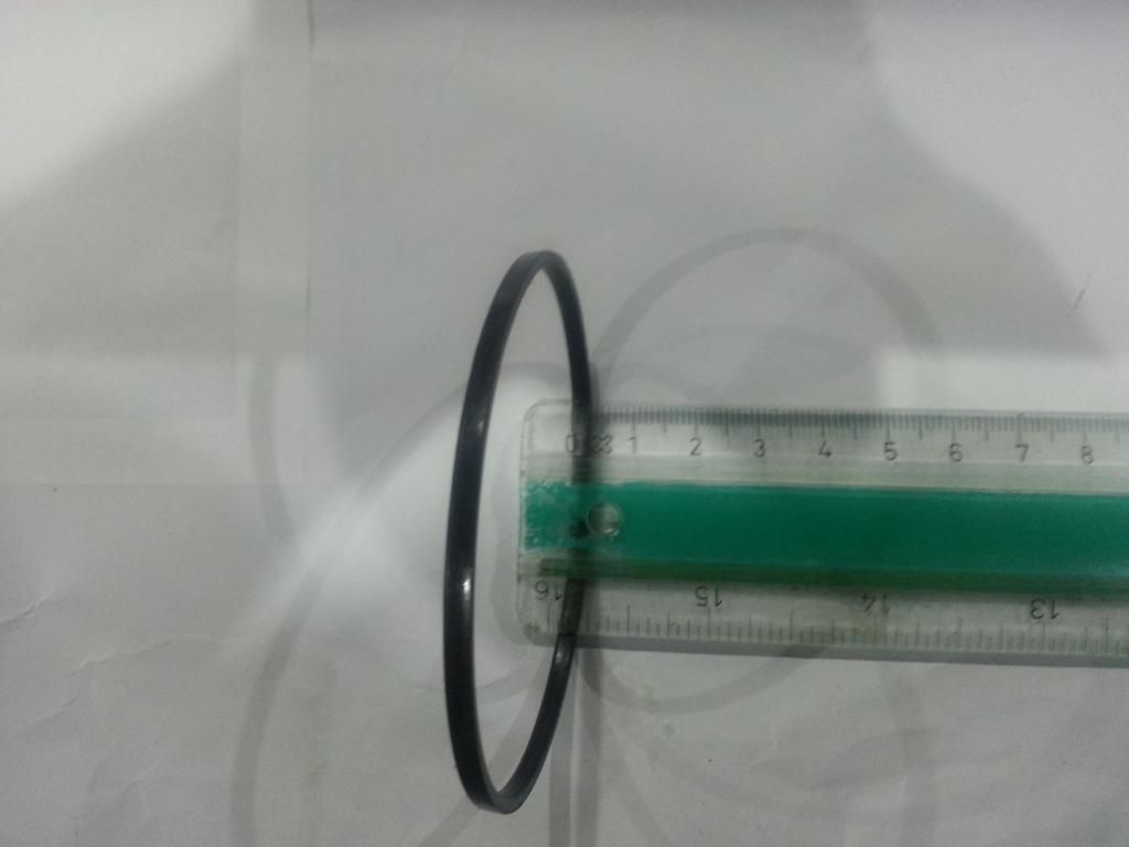

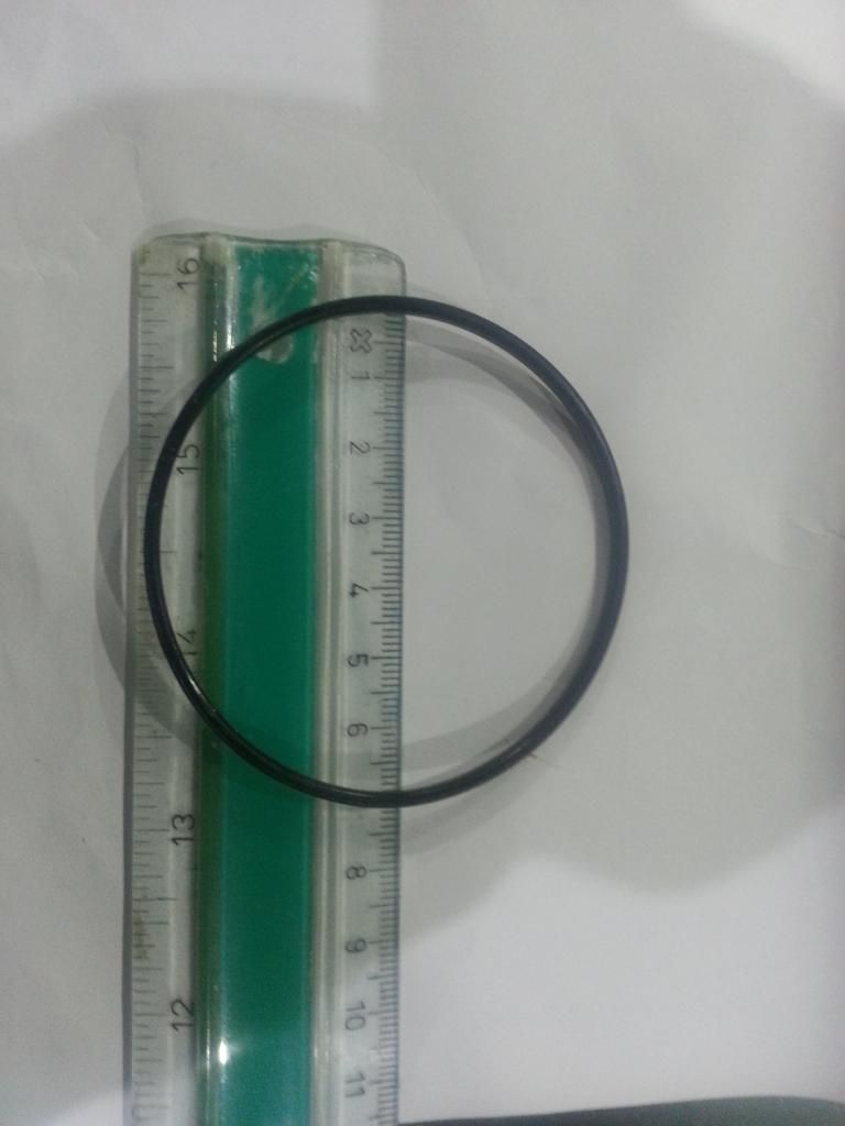

I took a Bosch VE apart a few weeks ago, which means I have some photos for you.
Here is the O ring which will be leaking, it sits in a groove on the iron high pressure part of the pump (the bit the injector pipes connect to via the delivery valves)..

« Reply #8 on: September 12, 2014, 08:23:07 PM »
That's outstanding. Thanks for that.
Is that O ring round or square section?
There is an O ring kit here somewhere, but it's looking to me like I'd be better off buying the correct part, rather than making one. Bit too much work to have it fail, maybe.
It looks pretty thick any way, I'll see what is in the kit.

« Reply #9 on: September 12, 2014, 08:44:07 PM »
It is a flat, rectangular section.
3mm X 2mm X 70mm diameter approximately (measuring with a ruler)
« Last Edit: September 12, 2014, 09:15:40 PM by julesandtash »
