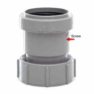

In Koi ponds most people use a small self tapper through the outer connector into the 40 mm pipe when after the pump, stops it blowing off and no leaks either.

Not got mine anymore but will try and get a photo.

I couldn't find a photo but hope this helps.
 When the 40mm pipe is pushed into position drill and screw a self tapper where the arrow is. I used this arrangement on my 1000gph return through a uv filter so that I could remove it if necessary.
