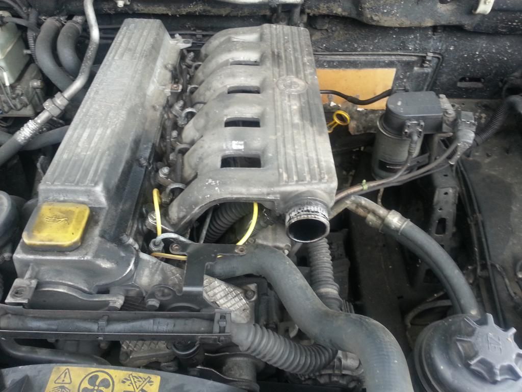

Air pipes and trunking off.
Inlet manifold off gives a lot more room - there are twelve 12mm nuts on studs, some awkward to reach. Also a couple of pipes and cables connected underneath it

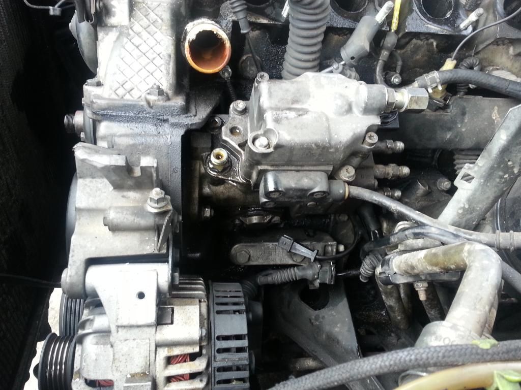

Fuel pipes, injector pipes (remember the order), pump electrical connectors and the serpentine belt tensioner need to come off
leaving the pump easy to access

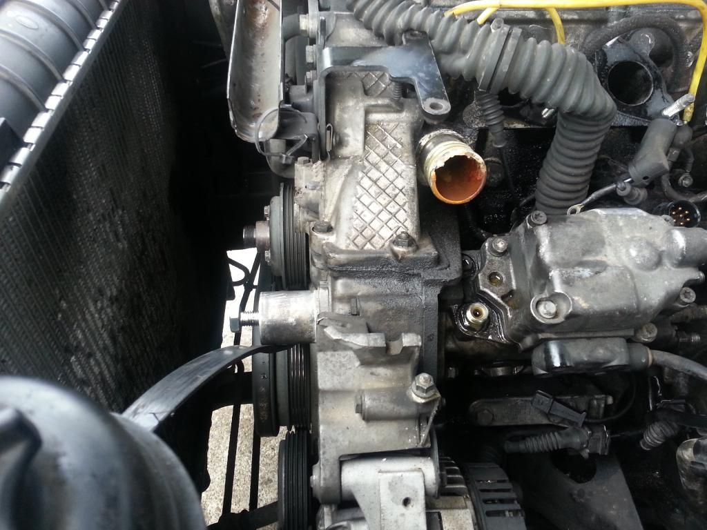

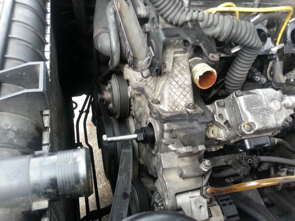

The drive shaft nut of the pump (18mm on the RangeRover) needs to be undone and the special pulley locking tool screwed on. Then the tensioner holder screws back in over the top of the special tool, meaning the sprocket and timing chain will stay in place when the pump is removed. The bolt from the tool is seen poking out of the tensioner holder in this photo
The cooling fan and shroud need to come off to access the tensioner properly

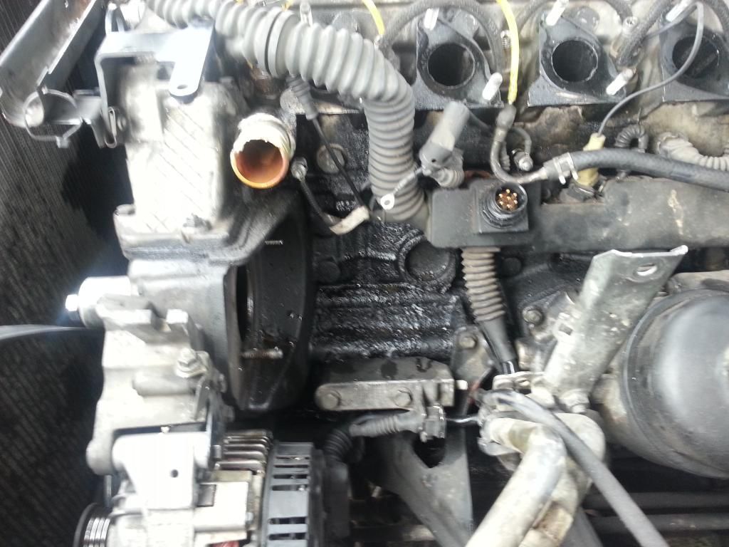

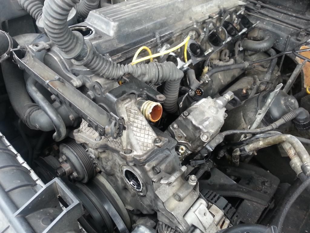

With the tool solidly in place, the pump securing bolts can be undone and out come the pump. It is keyed on to the shaft so no alignment problems unlike the Discovery Tdi engines.
Here you can see the sprocket and timing chain held solidly in place, viewed from the pump side of the sprocket. The tool is screwed to the other side of the sprocket
This is the replacement pump in place, with the tool clearly visible after removing the tensioner holder, just prior to unscrewing the tool itself
