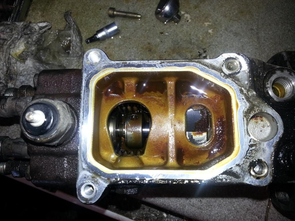

The electronics assembly, under the main lid of the pump. Looking pretty dirty in here and no real surprises that the feedback variable transformer (right hand side of the photo) was giving error codes at times).

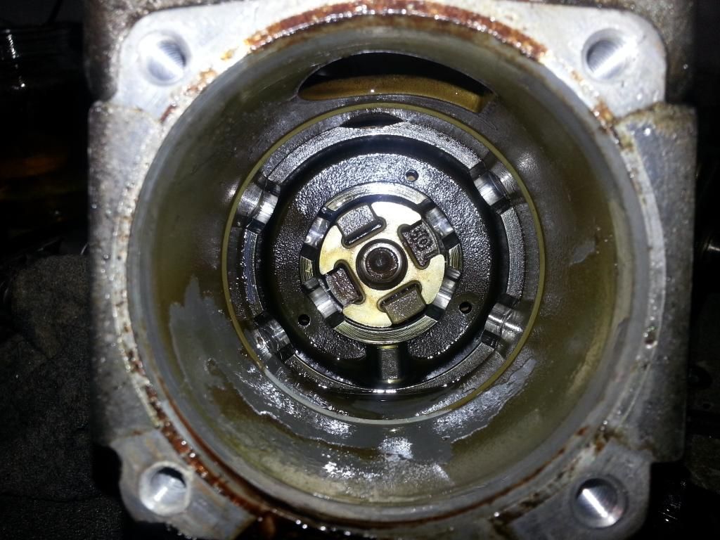

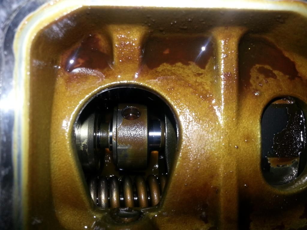

Looking down into the pump with the electronics removed - some dirt in places but lots of shiny metal as well.
A closer view into the bowels of the pump

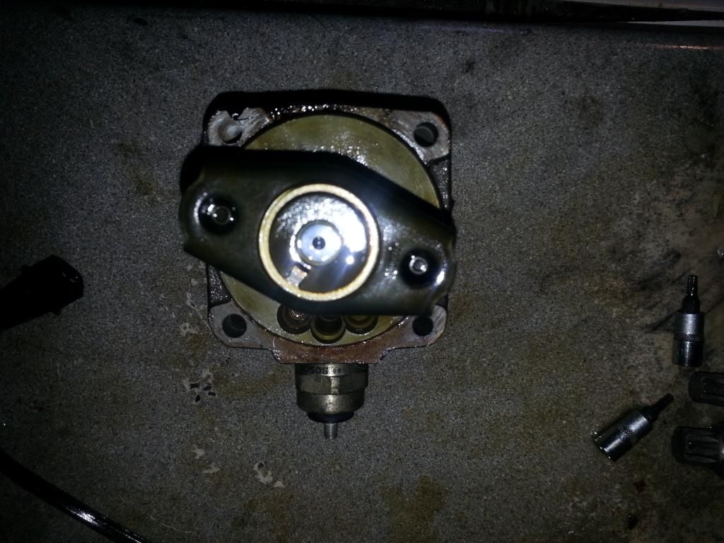

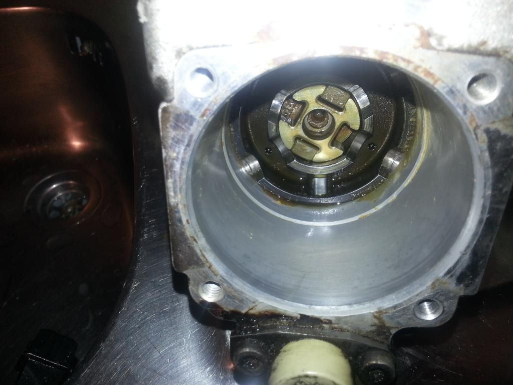

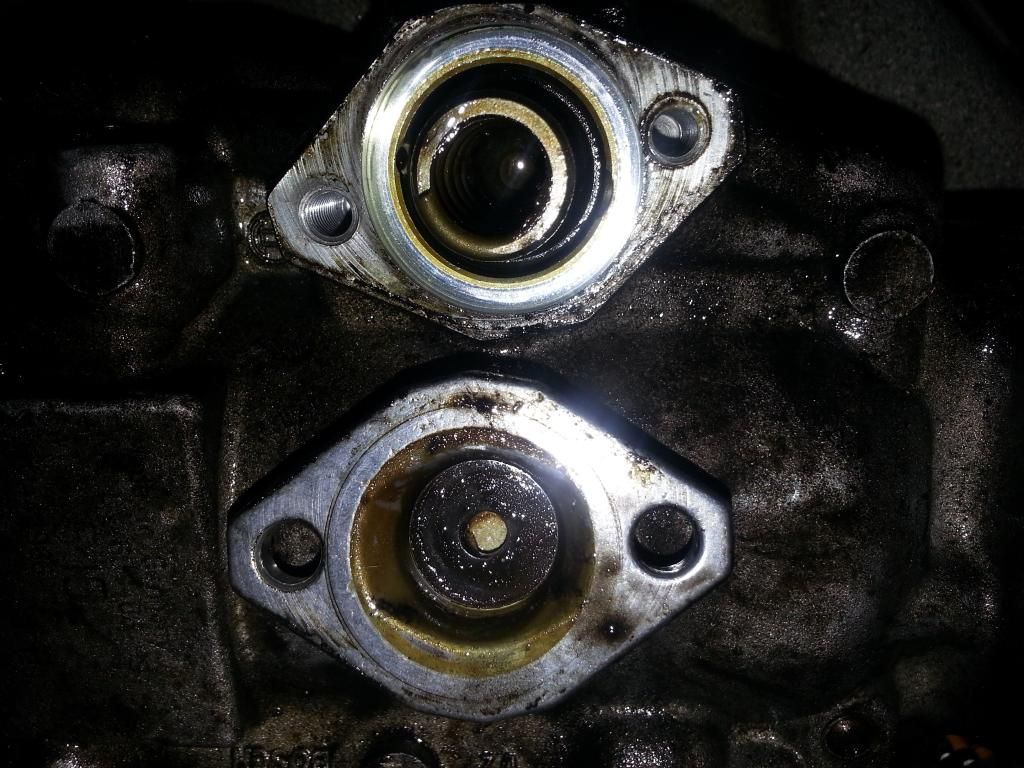

Timing piston bore and cover removed

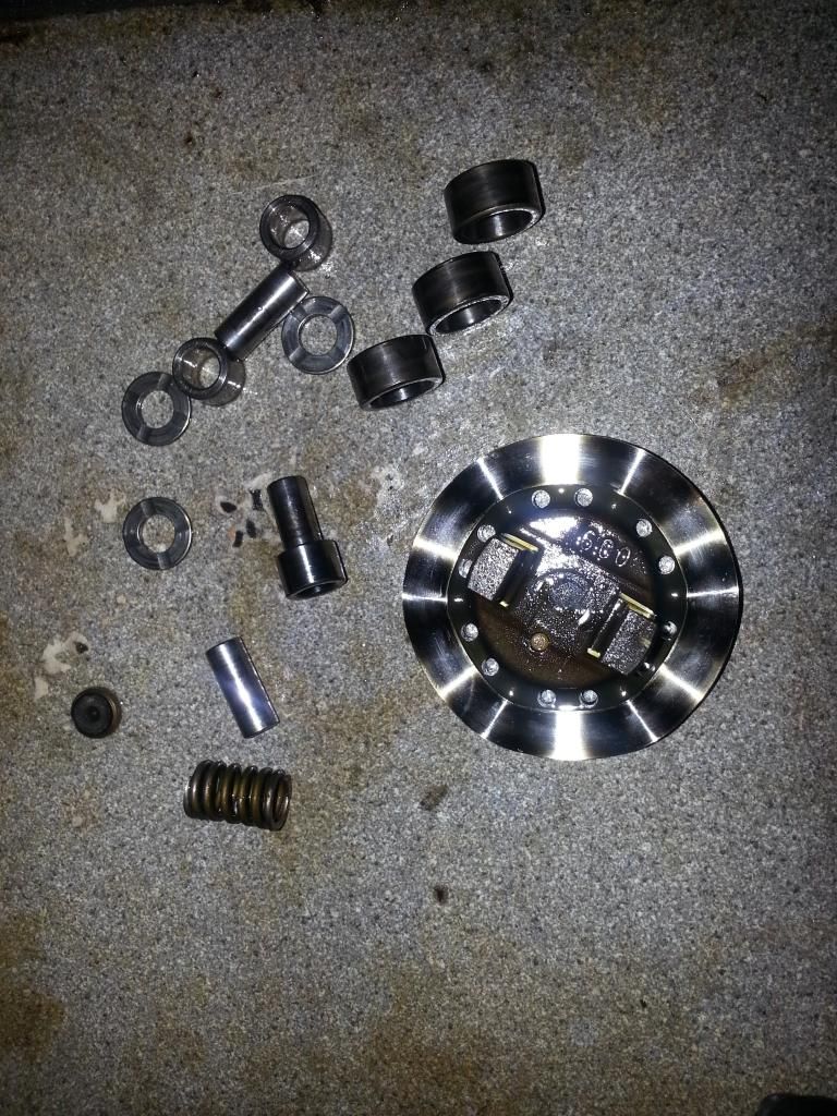

Hydraulic head, rotor and springs
the same part, viewed from above
The cam plate and rollers, surprisingly little visible wear and little contamination either

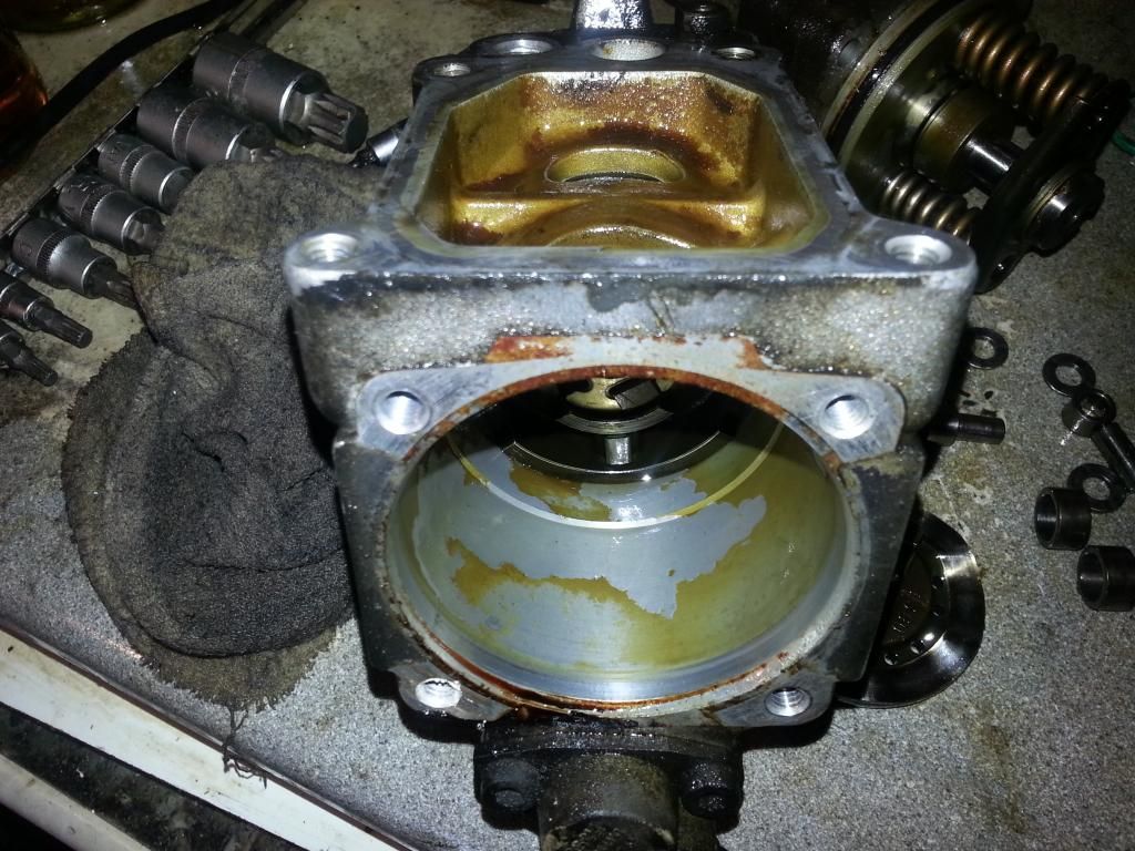

The inside of the pump body
and a different view
It was getting a bit late when I took these so I didn't try to clean the discolouration off. I'm not sure it it just a varnish coating or something deeper.

It is indeed.
There was no noticeable wear, pitting or anything else, just the prevailing brown gunge.
It looks like it is just a light coating, nothing more sinister as as quick wipe around with a paper towel soaked in IPA yielded this....
I wonder what the pros and cons of running the engine on IPA every few years for a few minutes are.
I suspect a diesel would run OK on it and it would certainly clean out any veg related muck. OK I know it has no lubricating properties but a few minutes at idle should be OK
