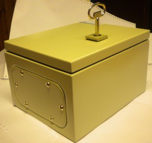

I can vouch for the quality of Julian's work, I have several small panels made by him in my caravan.
As for SSR cooling, my control panel for the bio plant has two 40A SSRs bolted to the inside of the steel casing. I cleaned off the paint down to bare steel then bolted them on with computer heatsink paste between the SSR back and the steel casing.
No heatsinks, no fans and no vent holes.
Even with both on for a couple of hours carrying 3KW each, they dont get excessively warm and the casing is OK to touch.
My enclosure is similar to the one in the picture except 600mm X 600mm X 200mm deep. In the picture below you can clearly see the SSRs on each side of the enclosure
