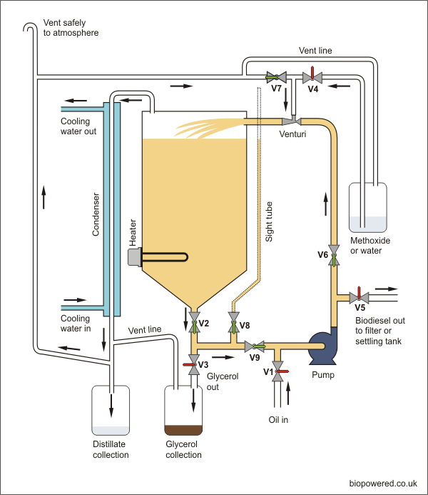

hi all
is the new GL pic up here with valve v9 on it?
Re: new picture with valve 9
« Reply #1 on: March 02, 2011, 10:46:55 AM »
V9 was to do with filling the processor and sight tube at the same time.
I don't have one on my processor as I use an external pump for filling, but I can see why you might want one.
It's not in the original GL design though, which makes me reluctant to suggest that we include it on the GL page.
« Reply #2 on: March 02, 2011, 06:52:34 PM »
Diagram with V9 comes under the heading "Subsequent modifications and additions to Graham's design".
Grahams original design didn't even show a sight tube, it's only mentioned as an addition in the text on his site.

« Reply #7 on: March 02, 2011, 08:57:50 PM »
could i mount this way?
« Reply #8 on: March 02, 2011, 10:09:06 PM »
Yes you could.  Personally I prefer to see the venturi above the oil level in the tank.  That way, if you forget to close valves, oil won't find it's way to places it shouldn't be.
Then there's the old chestnut about vertical vs. horizontal mounting of the venturi, there have been several threads on that subject!  With a good venturi, I don't think Grahams original layout will work too well without a jet breaker™.

« Reply #14 on: March 10, 2011, 01:51:42 PM »
V4 and V7 can be left open after meth has gone in via venturi if! the venturi is on the top horizontal?
vertically vlaves need to be shut?
