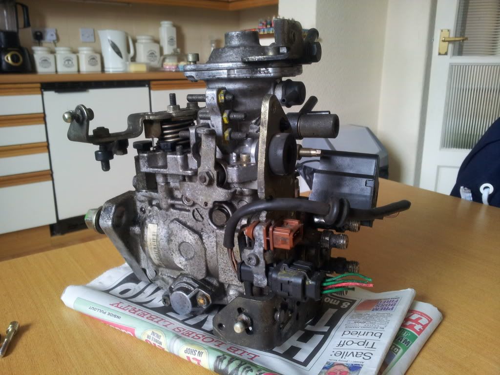

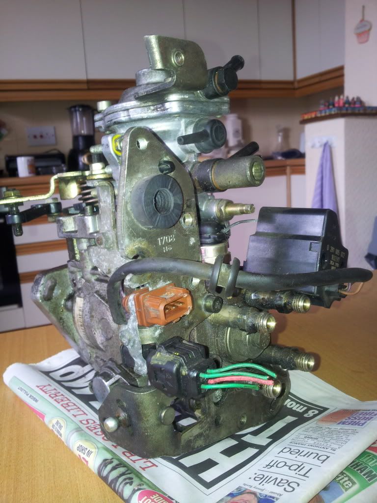

This is the pump from Alski - I removed the armour yesterday:

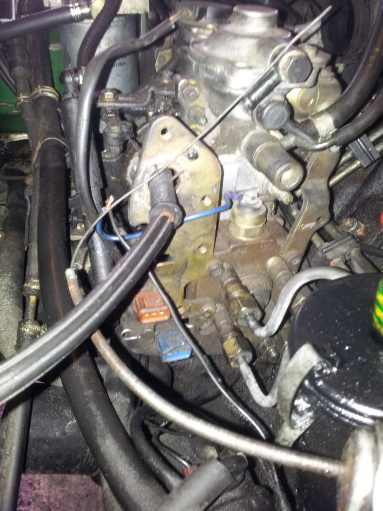

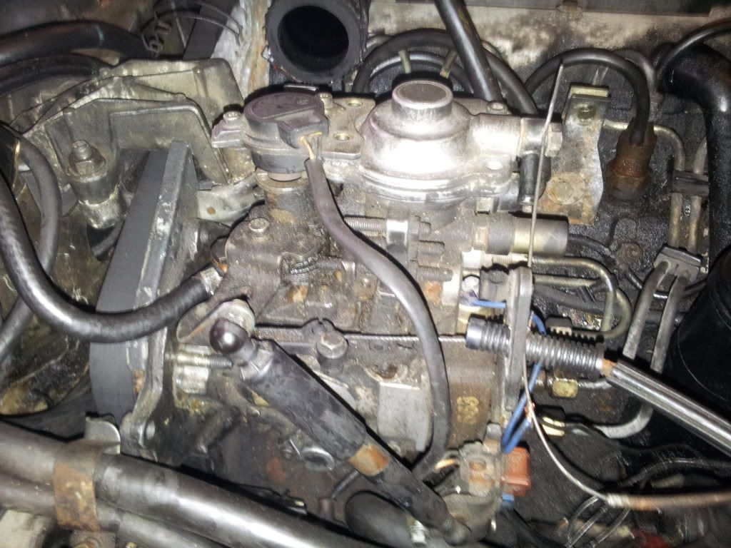

This is the pump currently on the car that won't rev:
The car has only pump diesel in the tank, never had any veg yet. Will run fine but does not rev when you move the control arm.

So when its ticking over does it smoke? or it it just ticking over nicely? I really do think the Governor spring has come out of its cradle
But the pump does not look like its been open... hmm

Can anyone identify the variant of the pumps I've posted up are they semi electronic?

alski's pump looks the part ecu controlled one, (was that electronic black box under the armour?) like a 406TD, which is like mine.
your first one looked the old type, but i guess not a working pump...
so have you got a turbo pump on a non turbo 1700 ? this may not help matters...

Yes it looks like a later 1.9 XUD turbo pump from a 406, Xantia, 306 ect.
