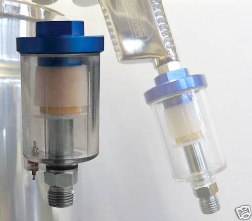

Also if you add one of these in the line if you use the air pump for drying your bio after washing
http://www.ebay.co.uk/itm/300561118471?ssPageName=STRK:MEWAX:IT&_trksid=p3984.m1423.l2648
it will take out the water that is generated when air is compressed.
very neat! bang tidy  8)
