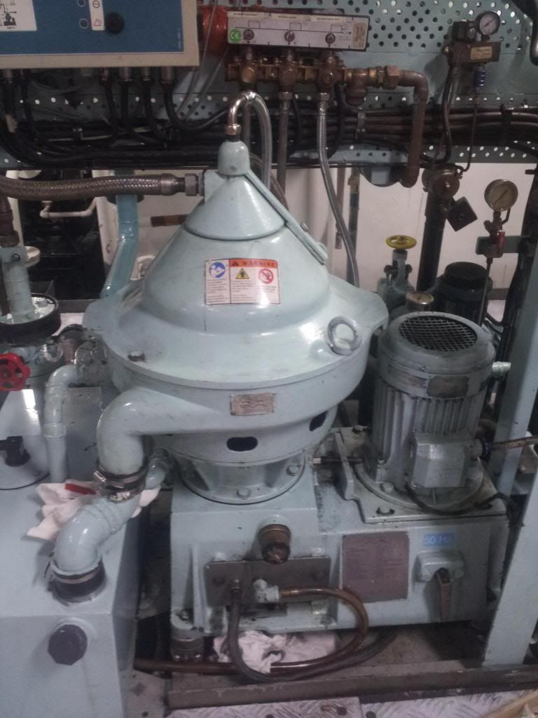

So, the unit itself. The feed on the top is for sealing water, the product in pipe is hidden at the back, and the one to the left is the purified discharge. There are other pipes as well for operating water (opening and closing the bowl) that are at the bottom of the unit. The fat one is the sludge discharge, and the one behind it is the water discharge.

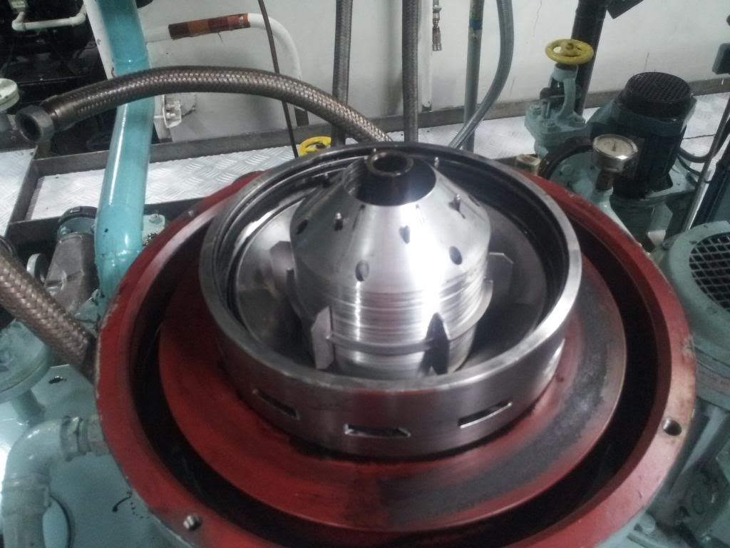

With the hood removed. The stainless bit is the bowl - all the red stuff is stationary. You can see the sludge ports in the side - these are normally closed in operation and open from time to time to discharge all the sludge into a sludge tank. The spindle in the middle is what the product is fed in through. It's hollow all the way to the bottom so that the product is introduced to the bottom of the distributor before making it's way back up through the disc stack. It also holds an impeller for discharging the cleaned product on the outer surface.

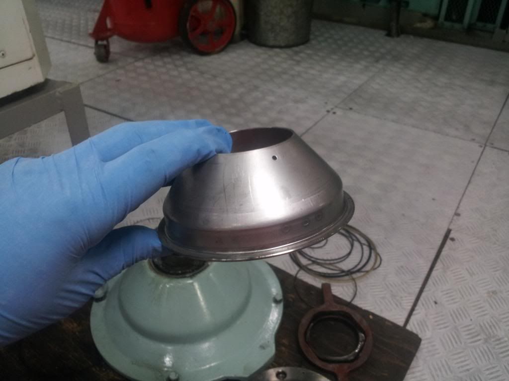

And the gravity disc itself - this is what sets the discharge point between the two phases of oil and water. These come in various guises depending on the manufacturer. Alfa Laval have evidently chosen a cone shape for this one. The Westfalia units I've played with in the past use a giant washer.

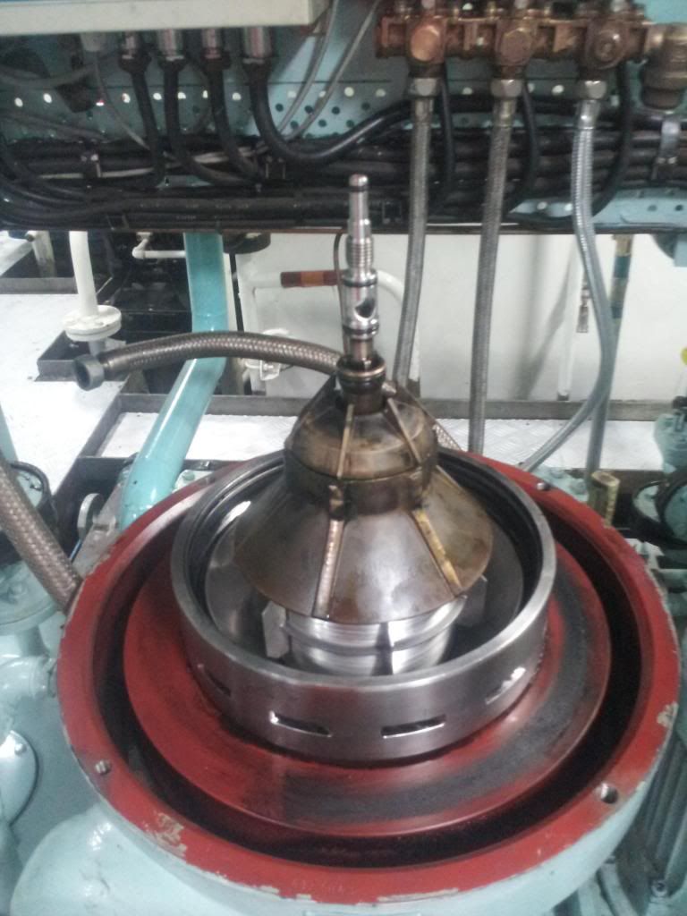

Bowl top removed. You can see the top of the disc stack.

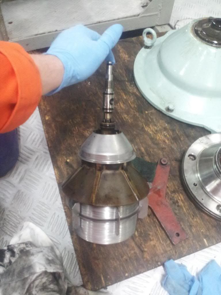

Disc stack top and spindle removed. The wings ensure that the product is rotating with the bowl. The holes in the discs allow movement of the product/water between adjacent discs.

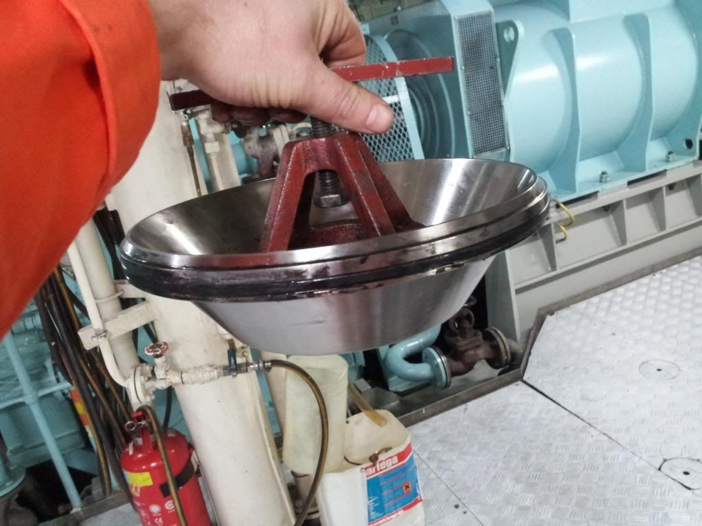

Removed disc stack, discharge pump, spindle and gravity disc assembly.

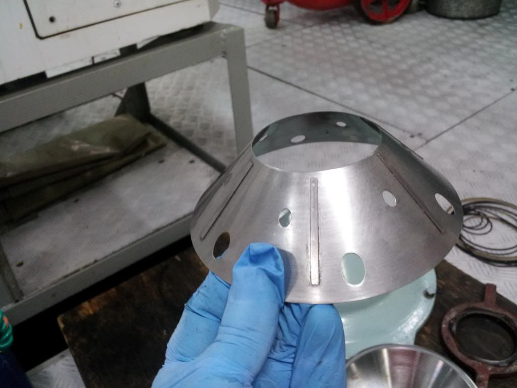

A single disc. Each one is cleaned and inspected closely. They've spent about 12 hours sitting in a vat of acid prior to being washed in diesel and finally wiped with a rag. There are about 85 of them (despite counting them several times today, I've forgotten the exact number!)

The motor by the side is the driving motor for the bowl. 2.2kW IIRC.

The whole thing relies on the principle that oil will float on water. Water is put in first and is flung to the outside. The bowl fills up and eventually overflows out of the water outlet by the gravity disc. Oil is then pumped through - the oil 'floats' on the water passing up through the disc stack and out of the oil discharge. Particles are flung into the water (aided by their path through the discs) and ultimately the outside of the bowl. Any water in the oil passes into the water in the bowl causing the water to overflow from the water outlet a little more.
So really, it's quite different to a centrifuge - it'll actually continuously separate two liquids as well as solids.
