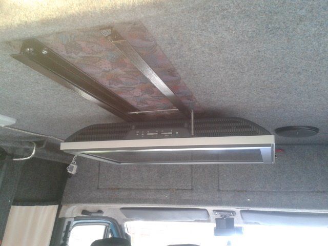

I managed to pick up a sony bravia lcd 26 inch for me van, so I will be knocking up ceiling brackets for it soon so goes flat on ceiling when not in use (see out back mirror) and swings down to the table height ish when in use. its for me laptop to plug in HDMI cable to play tunes and films...

well I knocked up a couple brackets for the roof of the van to hold tv, got given some small angle iron which I cleaned up get the rust off, they have black hammerite on them now and holes for a locking pin to hold to ceiling will show more pictures later also removed tv base, also got given a radio for the camper area in the back and the radio just happens to be the same as mine in my car which has a remote control for it :) I need to cover the box I knocked up in the carpet felt stuff like the boiler box to match in yet, prolly stick that on tomorrow and fix to front ceiling cupboard well the bottom edge of the cupboard above drivers head, also need to run power to it and speaker wires, im gonna spur into the 6 original van speakers 3x each side in the roof.
cost of box and brackets = 0p :)

tv brackets made and fitted and linked to laptop im online in me van

also the position down you can still walk round tv/table and use cooker and sink area, make tea (fetch a beer) :) so that worked out very well, and when the bed is pulled down tv is at the end of the bed which is cool :)

if anyone is interested? the tv only pulls 65watts when in use from the 12v to 240 invertor (1100w) and volts drops from 12.7v to 12.2v and holds.
