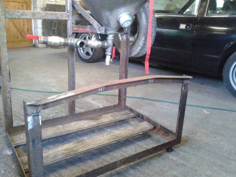

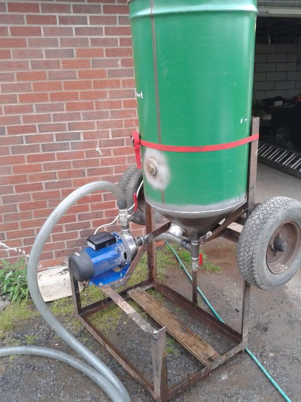

« Reply #126 on: May 11, 2014, 03:22:57 PM »
Hi all,
Its been a while.  I've been on holiday and buying a car :)  and just generally not getting much done on the processor :(

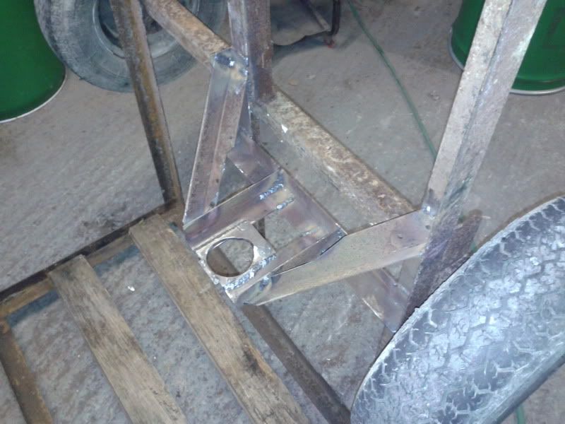

But yesterday I finished reinforcing the tank mount:
And started making the bracket to hold the pump:
And got to a position where I was able to test the pump:
And......      The pump leaks :(  :(  :(  :(
I've emailed the seal guy and told him how I assembled it.  He seems to think there was nothing wrong with the way I did it.  So I took it to bits again and cleaned the bits, checked the important faces of the rotary seal and reassembled (spotlessly clean)....  Still leaking.
Next I'll try just leaving it running as it might have to "bed in", Seal kit man used to work a pump place and said occasionally they had to bed in for a bit.
More to come
« Reply #127 on: May 11, 2014, 04:54:07 PM »
I don't want to be picky but you'll be putting the best part of 450lbs on to a VERYsmall surface area.
As your cone and hole are not truly round you've reduced the contact are even further,  any vibration,  and there will be some, could cause the edge of the support chewing through the cone.
Whilst I'm at it you'd be best advised to get rid of the plastic pipe, when it fails you're gonna end up with a lot of hot oil/bio to deal with.
« Reply #128 on: May 11, 2014, 09:28:56 PM »
Agreed on those points.  The plumbing is a temporary job simply to test the pump, it will look very different before oil goes in.  The support for the tank will be different too.  I plan to add something to spread the load.  The point of contact you mention is far worse than you can imagine at the moment, but I haven't filled the tank very much for testing the pump.
On that note......   The pump is a monster!!!  I drained over 50 litres in well under 10 seconds, I'm sure it was more like 5 seconds, there is a really strong reaction force too, you have to lean into it :)  :)  :)
Just got to stop the b***dy thing leaking.
Tried "Bedding it in" this afternoon, went from 2 drips a second to 1 a second.  I'm in contact with the pump seal man.  I really hope I can get this sorted.

From a purely personal point of view I'd employ another lever valve and connect it to the bottom nipple of the tank. If you have a problem with the pump or pipework the fluid in the processor needs to isolated. You're asking for trouble not having having one there
« Reply #133 on: May 12, 2014, 06:52:02 AM »
Julian, I might well have a go at that seal rejuvenating, nothing to lose before giving in and getting another.
I'll put blades on the wheels and connect up a generator, harvest some wind energy :) :)
The plumbing is just temporary for testing the pump, there will be valves everywhere, including on the bottom of the tank.
« Reply #134 on: May 12, 2014, 08:59:09 PM »
My appologies there Loz. Just looked at the other pics and can see the valves. I was only looking at the one with the pump when I posted up. The other pics didn't register. Sorry!
