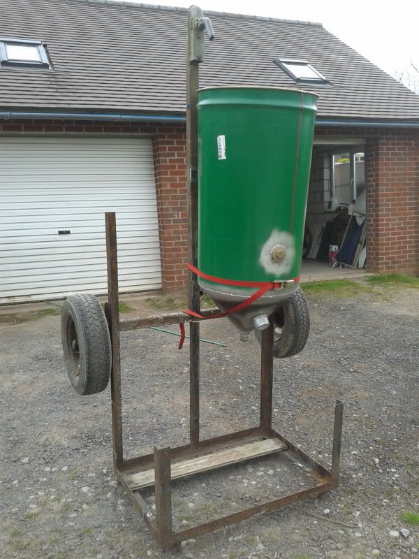

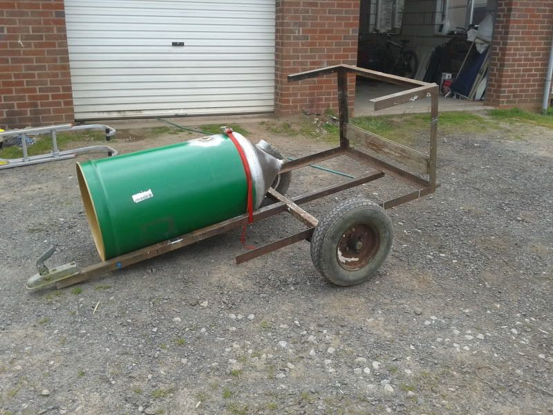

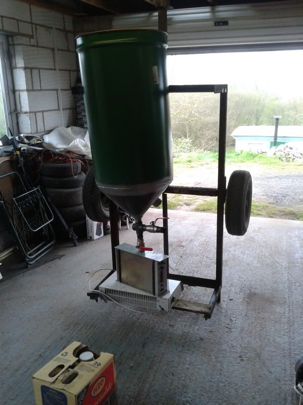

Please feel free to alter anything, particularly with regard to the welding tips, I've not got much experience with the thin stuff.
Got lots done today, although having said that it was mainly thinking...
I picked up a trailer for £40 and stripped the rotton wood out of it (so all the wood then).
It occurred to me that this isn't going to fit under the garage door though, so I thought and thought and thought, then this idea came to me.
A bit of cutting and welding later, and I got this far.  Like I said it was a thinking day.  I think I would have made more ground if I had had this idea before starting.  Anyway I'm pleased with the progress.  I've got a small shopping list of bit to get to complete the bottom end of the processor.
I hope I'm right in thinking, the glyc drain valve doesn't need to be anywhere near as massive as the valve to the pump.  So this should save a bit of money.
More to come.

Been away a while sunning myself.  :)  Had a couple of hours on it this afternoon and already I'm back to "work"
Inspection at work next week :(  :(
I spent most of my time digging out an old bed frame for its angle section.  I think I'm through the majority of the "staring at it and thinking" stage and finally have a plan to move forward......    then the inspectors called so it'll be on the back burner again for a bit.
More to come
