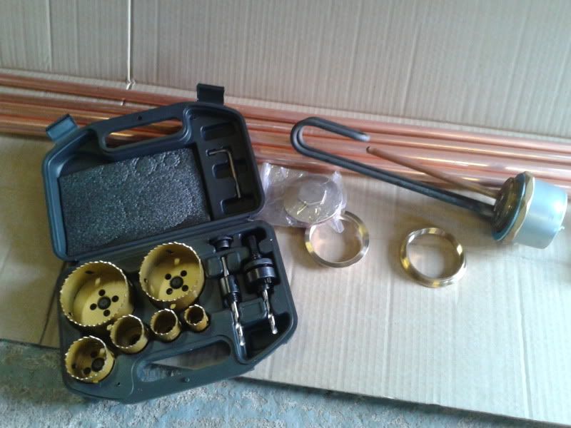

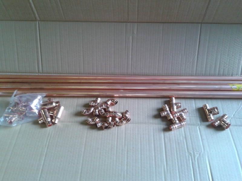

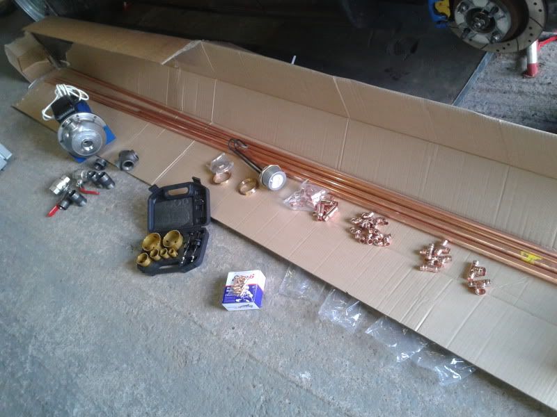

I got lots of cool stuff in the post :)  I'll be attempting to make a quadruple 1m long condenser, I'll be (attempting) to put in two header flanges (go bog or go home right :) ) but as it stands don't have a good enough supply to the garage so I've just got a blanking plate for one of the flanges.  The nipples and valves have arrived (well the first lot).  It's all 1.25" so a bit pricey.  I've been telling Dick all about how this has to be done on a tight budget.......    well that didn't happen, as with everything I do, I read about it lots and end up trying to get the biggest or best I can :)  Its up to £300 at the moment, (barrels for suppliers, lean-to stuff, everything) and I'll be doing my best to stick to a £500 budget.

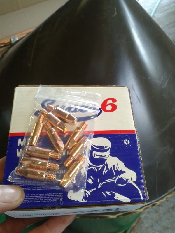

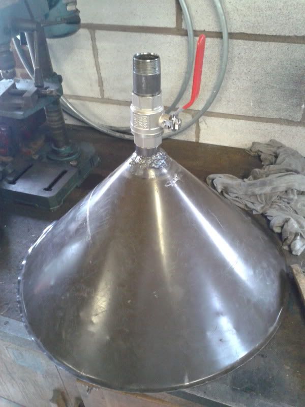

The welding gear for the cone

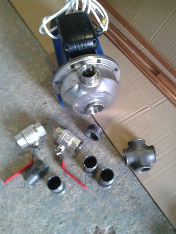

Here is all the other stuff lines up :)
Yorkshire fitting for the condenser
Flanges and stuff
Finished pump and some valves (primarly to seal off the bottom of the cone so I can fill it with water to test it)

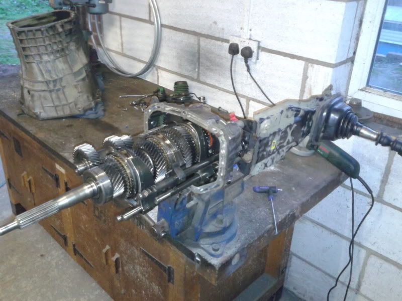

wanted to get the spare gearbox sealed up again so the grinding dust didn't contaminate it.  I'd got the box partly open, but could fully open it up and couldn't put it back together.  I tried one more time ,before giving up and adding it to the scrap pile and it opened up :)  So I spent the rest of the evening checking it and putting it back together (that was..... still is, a struggle!).  So if I can get the last circlip on tonight I can start the cone welding tonight.

Hmmmmmmm......   I'd like to do a proper job of it.  I might try cutting some tread on the lathe, I've not done it before but it means I could make any length instead of ordering bits.  I can't do a whole loop in BSP though there must be a break from it as you can't tighten the last fitting :)

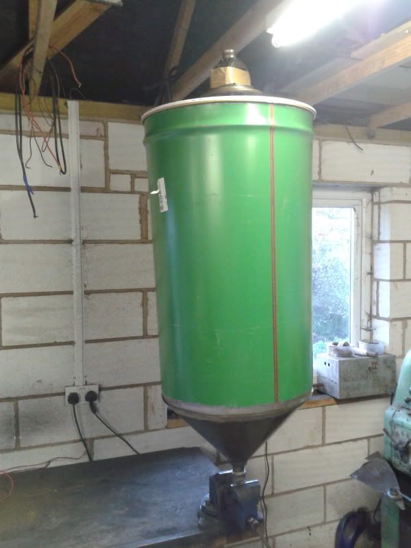

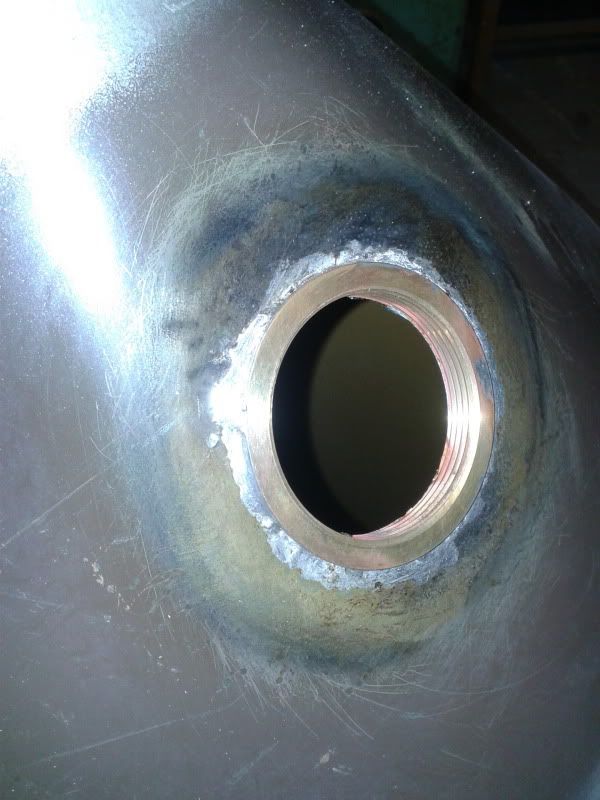

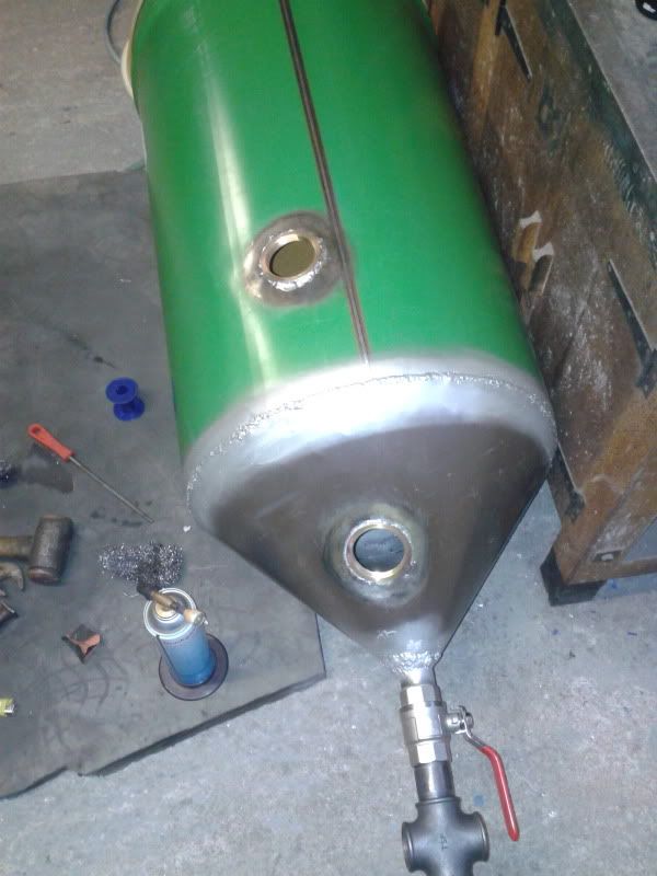

I made some serious progress last night and today.

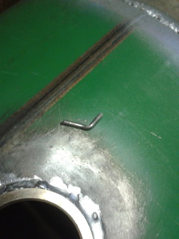

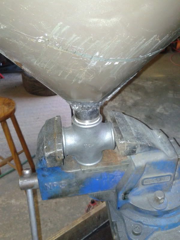

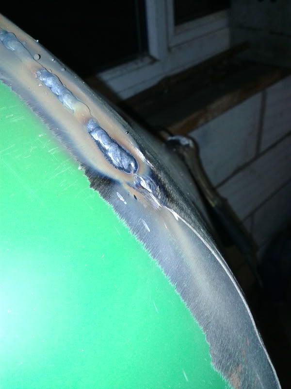

Got the cone welded on (thanks for the 0.6mm advice, its much more..... "delicate" and argon is much nicer than CO2).  First I welded on the nipple for the valve as I could test everything by filling up with water.  You can have a good laugh at this welding, it went baaaaaadly!!!!
And I got angry with it and piles on more weld and eventually I was left with a smooth weld (lots of it) but I couldn't believe my eyes when it worked, no leaks :) :)

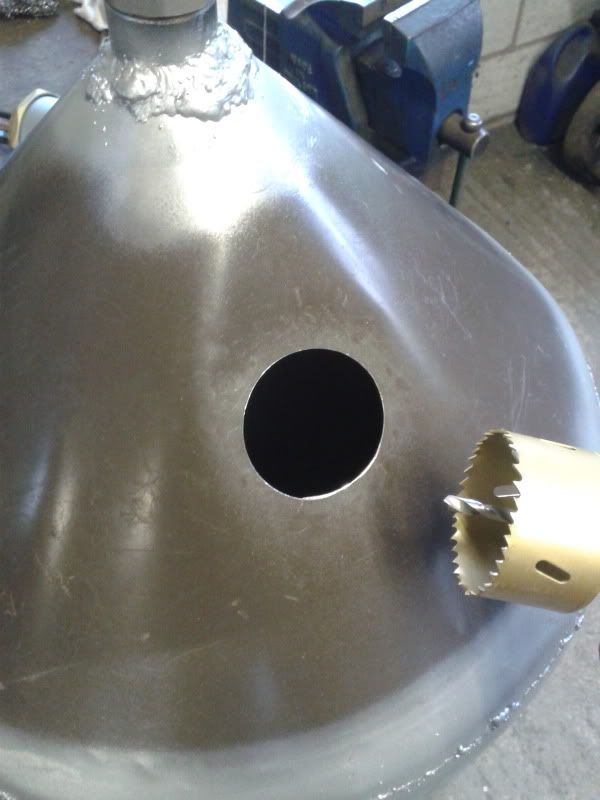

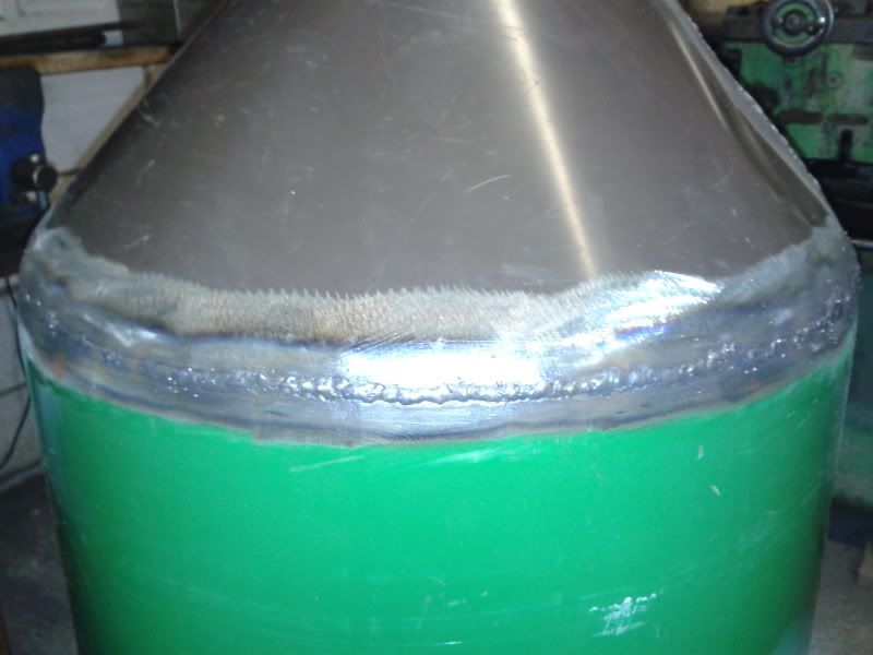

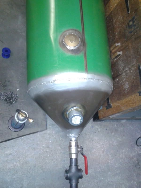

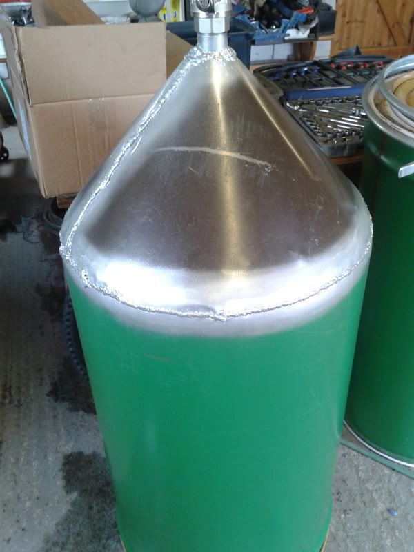

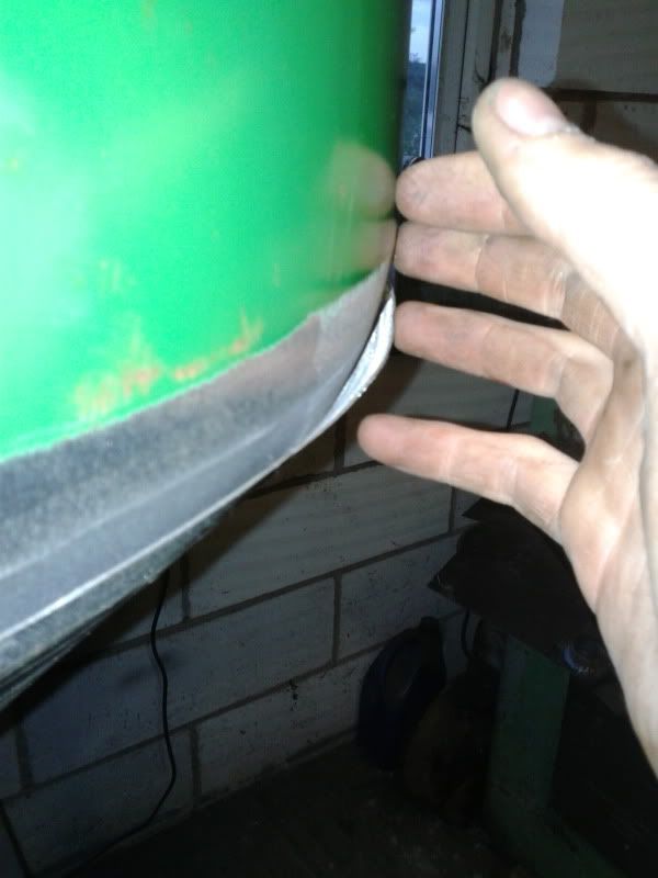

I then put the whole thing in the vice
Placed the barrel on top with a couple of differentials to weigh it down (reduce the gap)
I cut most of the excess material away and tack welded it in place.
Then took it down and put it on the bench and hammered the edge flush against the barrel as I went
This mostly went really well, again I couldn't believe how well it worked really :)  I tested it this morning and there were 3 leaks.
All patched up and painted (silver being the only paint I had)

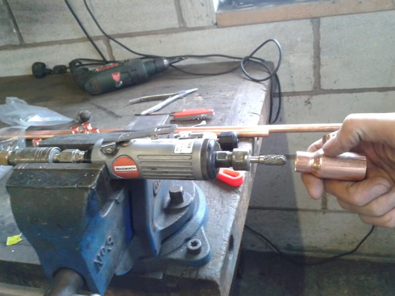

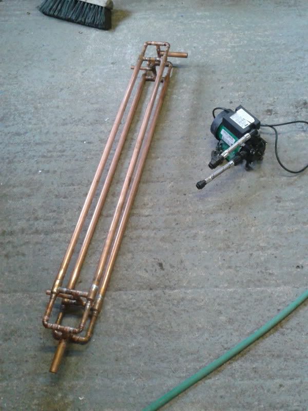

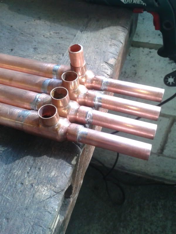

Then it was on to the condenser.  I used the die grinder for the fittings

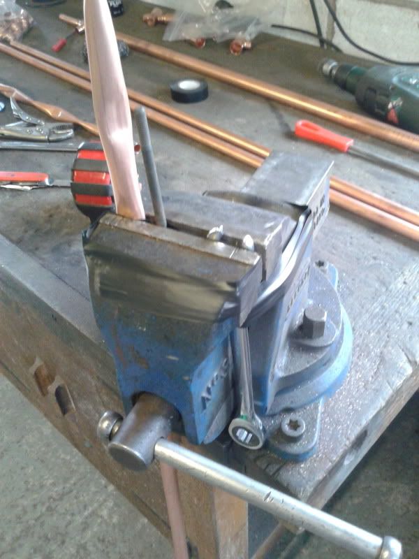

Insulation tape to hold a bolt in place as a jig for the length, and the spanner meant the vice always closed to the right gap.
I enlisted the help of my dad who has done lots before.  I haven't done any pipe soldering before, Its quite fun :)
It doesn't sit flat on the floor, I seem to have made it with a bit of a twist included, I'm hoping the gas won't mind :)  This is the shower pump I plan to use to circulate the cooling water, its a pump my folks had hanging around.

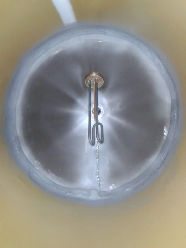

Then on to the heater flanges, I wanted two to speed things up when I can get a more substantial electricity supply.
And the second flange higher up.
I'm really pleased with the result.  I tested the tank again with water.  The top one seemed fine but the bottom was leaking, I think is down to the fact that the heater was in hand tight only.  I need  a spanner really.  This is all the solder I had left  :)  :)  Lucky!  well not if it turns out the bottom flange is leaking :)
