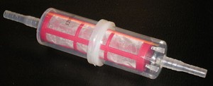

it wasnt a sausage filter i have, its the second picture the glass / chrome split apart  to clean filter one, i have never used it as sausage ones keep going, they work bang on... keep the bits out and car running like a new filter everytime...
but alas i think you already ordered a glass one  :(
also surface area on these split apart ones isnt big at all (inch? of mesh), infact tiny compared to an original and 6 inch sausage

second pic down is the one i was going to send you

There are two sizes of the glass ones. I got the bigger one. I'll give it a go anyway. If it fails, I'll have to try the longer sausage ones.
