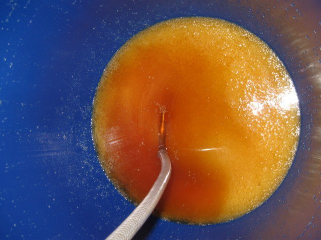

Well for me this kind of thing appears without filtering, as a settled layer:
It was lots of this that was reprocessed successfully.

mate, what are we looking at a skin on the surface or things floating?  Can't quite make it out.
Geezus Tony, if I added up all my soapy/hmpe's stuff from the last 5yrs I wouldn't have that much.
WHAT are you doing to make that crap?

It's a layer of bio and below it a couple of inches of creamy stuff.  I collect it all together.
Never appear in summer but in winter I get a fair bit.
I've always followed the WBD process, though perhaps a little too enthusiastically on the Methanol recovery (usually take the batch up to 90C).  Perhaps I get a reverse reaction into mono/diglycerides,though I never recover enough Meth to think that is the case.  I'll take it a little easier on a batch I'm planning for this weekend.
I'm not too bothered by having to collect them up beyond the extra bit of hassle.  At least I know they won't get wasted now, as they can be reprocessed.
