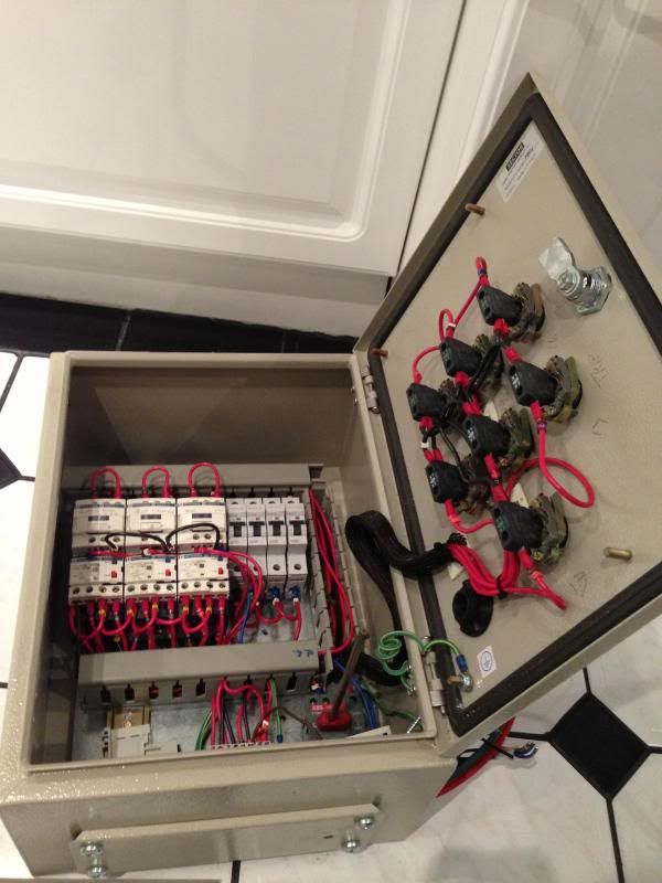

Was at work today to help some guys with a refit and overheard that a wall was coming down and this was stuck to it!
I am going to try and get some info on those contactors and see how it all works, I am sure I can salvage loads of bits for a processor control panel build, its got a decent heavy duty switch and 4 MCB's.

I would very much appreciate it as I don't have a lot of experience with these. It was controlling the AC unit and a couple of fans.

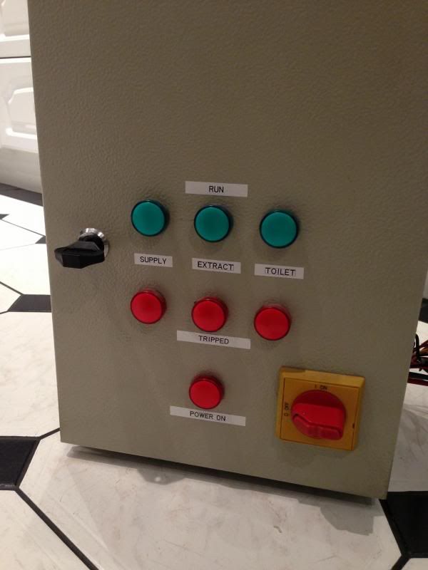

There was another timer that I didn't take off. Those are just lights on the front panel.

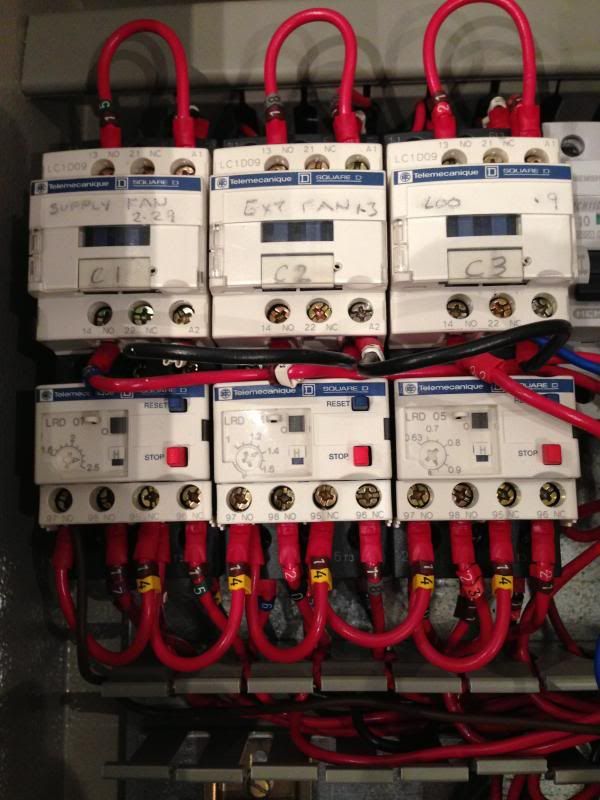

These are the contactors:
http://www.kentindustries.com/square_d/tesys_lc1d_contactors.pdf

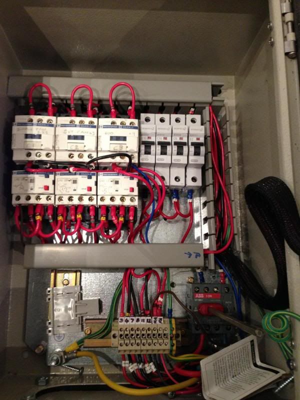

Those contactors would have 220V coils - great for you as you won't need a control transformer to power them. The blocks underneath are over current trip relays.
And they'll be connected in a standard Direct On Line motor starter configuration with a start/stop button.
http://electricalnotes.wordpress.com/2012/03/13/direct-on-line-starter/
The contactors NC terminals (15,18,21) will be driving the 'tripped' lights on the front.
