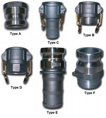

I then want to go to a cam fitting -
and *then* to a bend to make the vertical pump outlet a more convenient horizontal.
I want to use the cam before the bend, as, on my electric mono, its a constant irritation that the fixed bends are always pointing the wrong way.  I figure i can use the cam fitting to swivel (on fitting) to the direction i require.

I think that, unless Jim furnishes me with the details of his magic supplier of stainless fittings, ill order some from oilybits, and the other bits from BES, and do it the way suggested above.
Id like not to have to 'spanner' anything to change bits about.  Im sick of having to spanner the reactor every brew as it is!
