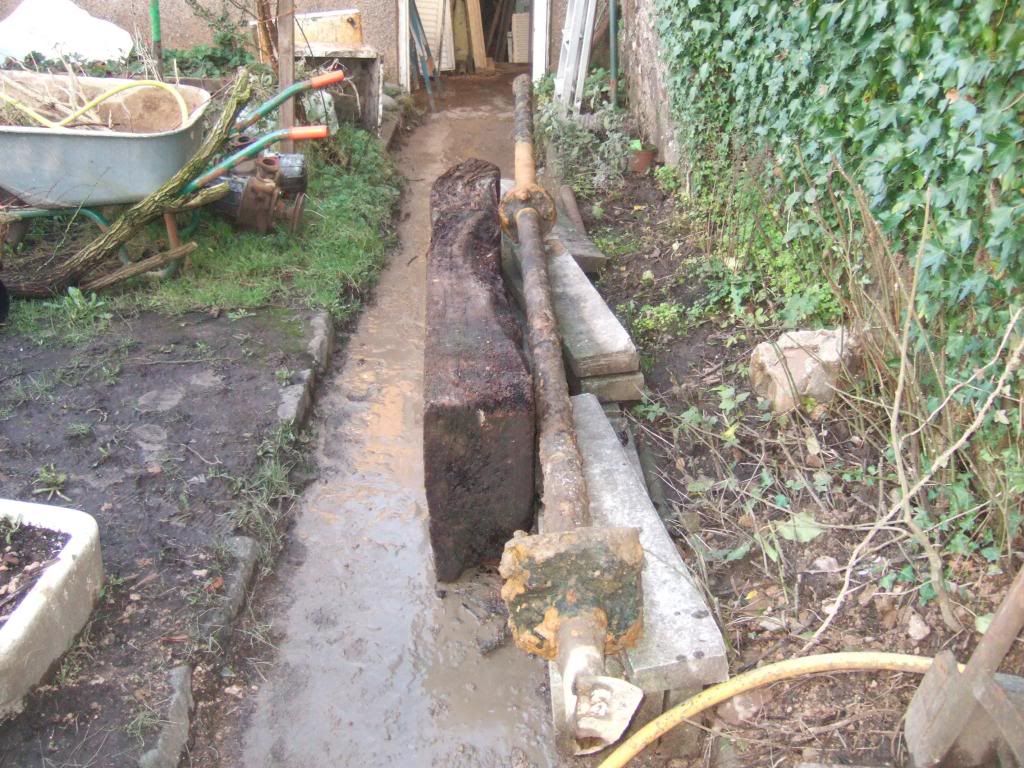

See the small bit of cast flange sticking out the ground by the bit of grey plastic waste pipe?
This is what it was attached to -

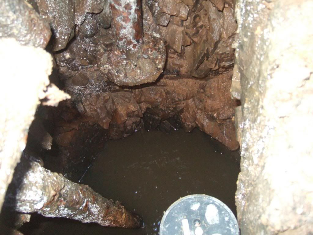

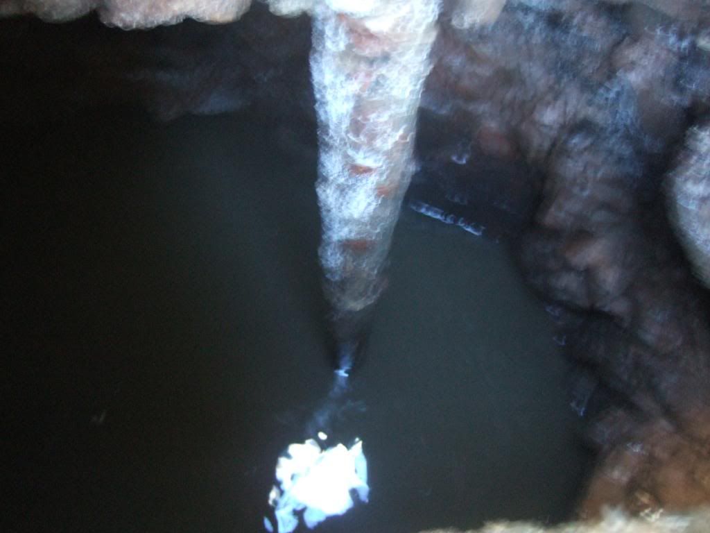

Its not that deep.  14 feet.  The well at my folks' house is (on the plans as being) 50 feet deep!

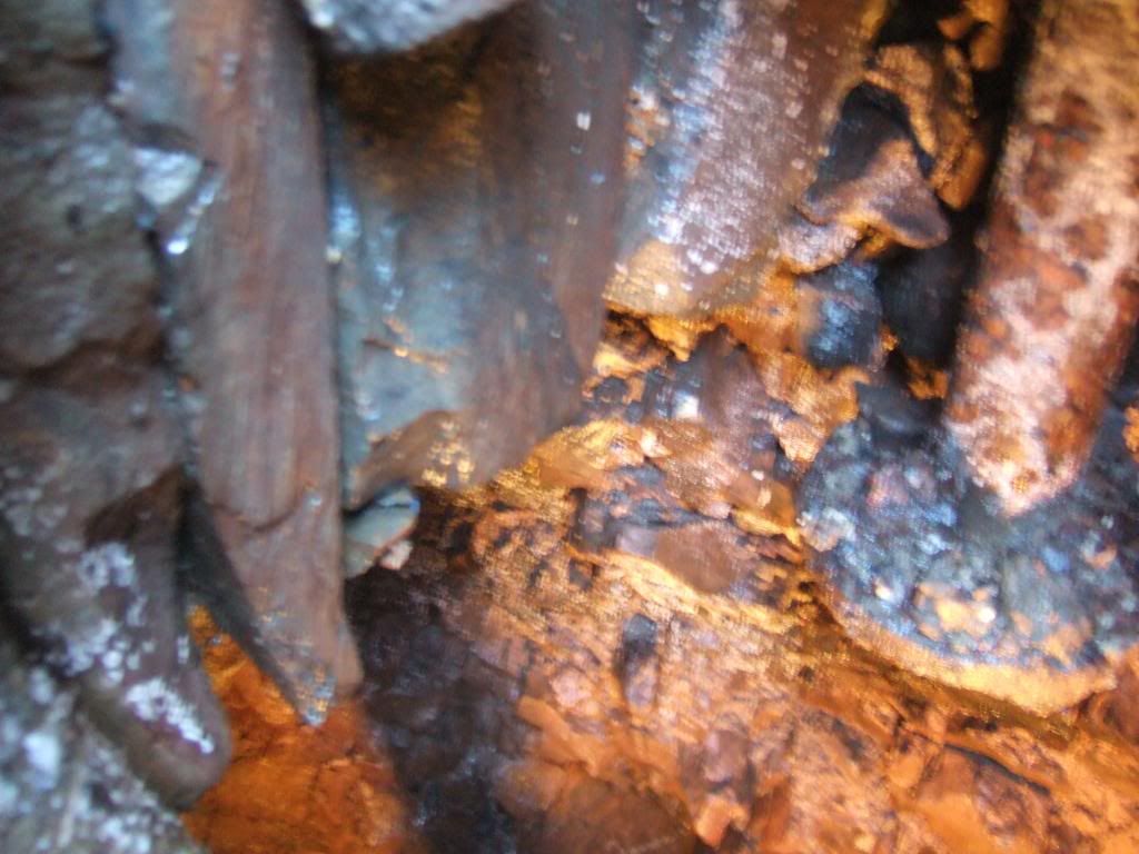

Here we go -
Its not bricked up or anything, just cut down.  I dont know how stable the sides are.
Its finished at the top with a couple of arches, and some bridging stones.

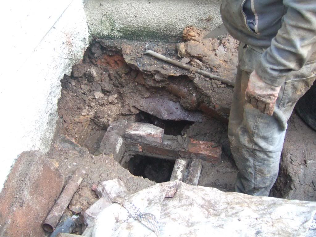

One arch looks quite good -

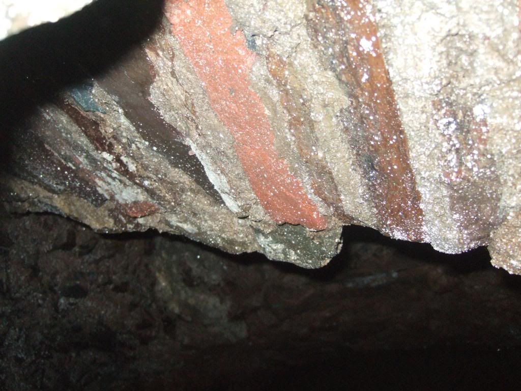

Im not as confident with the other one (but its probably ok) -
Ive got no more photos.  Basically, its a couple of arches, and then some larger rocks bridging them, but not overly stable.
We took off some of the larger rocks, put some cut up steel scaffold pole bridging, and set the lot in concrete.  Then build up with a couple of corses of brick for a man hole cover.

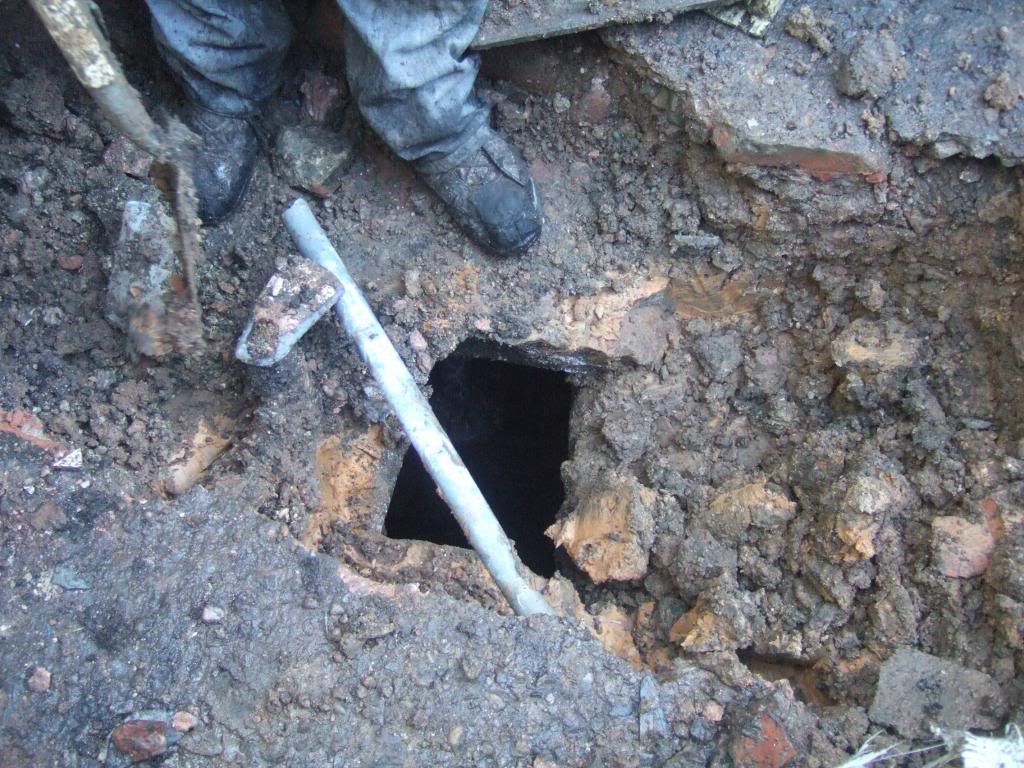

Ahh, i do have one more photo, but only near the start -
You see the crow bar lying on the concrete near the top of the photo?  Parallel to that, under the concrete, is a brown, clay section, soil pipe from next door.  Although its not significantly leaking, it will mean that the water is, or could be at any time, contaminated, so not much good for anything other than toilet flushing, or garden use.  And, as our garden is about the size of our front room, there's a limit to how much water i can use.

ps.
The feet are Jules' - i think he likes smashing up our place - i think its probably fun when you have the option of leaving the building site at the end of the day!  ; )
